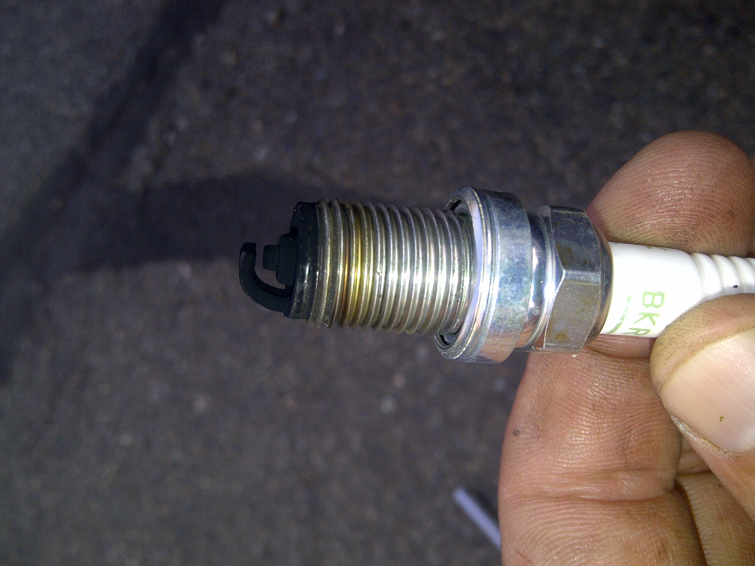

During test, pull plugs and post a pic of the 5 plugs up close on the plug ends
Report dry and wet ( with oil) measurements

When we look at the plugs we can tell if it's an engine problem or isolated to a cylinder or two

Attached is a picture of one spark plug, but it looks like all the rest, with very thick black buildup.
