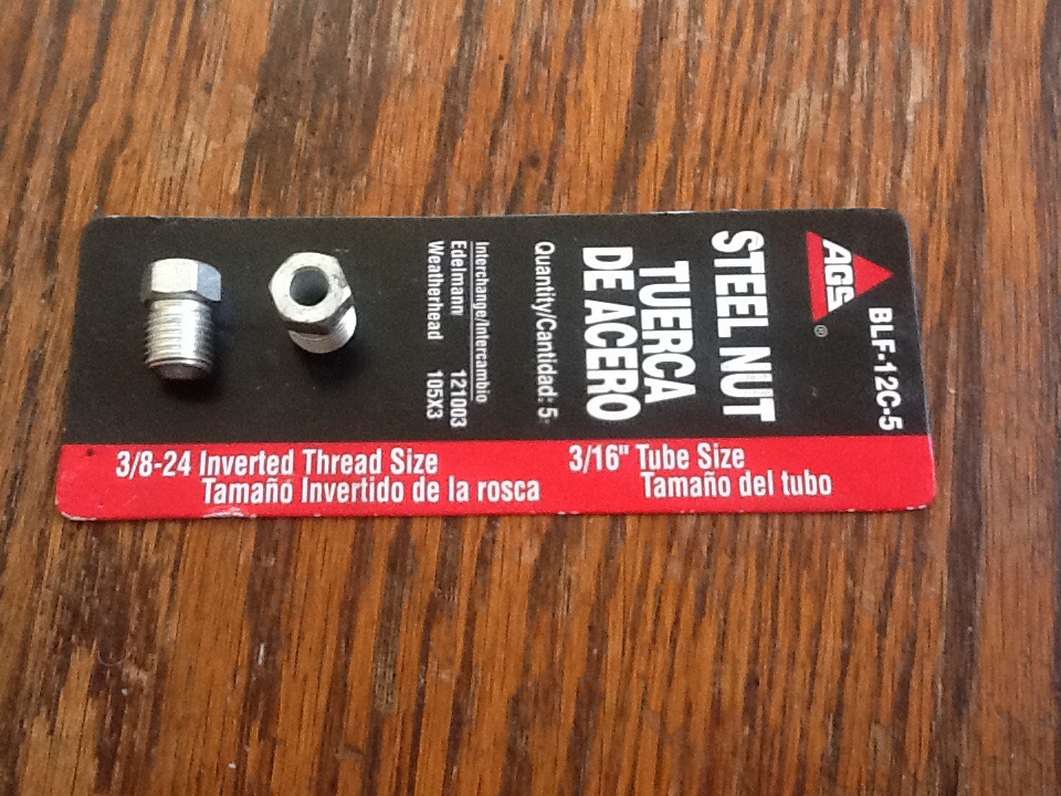

This is what I used. Got them from autozone.

Quick question kahl. The parts would appear to be Imperial sized and not metric from your picture, or is this just an example?

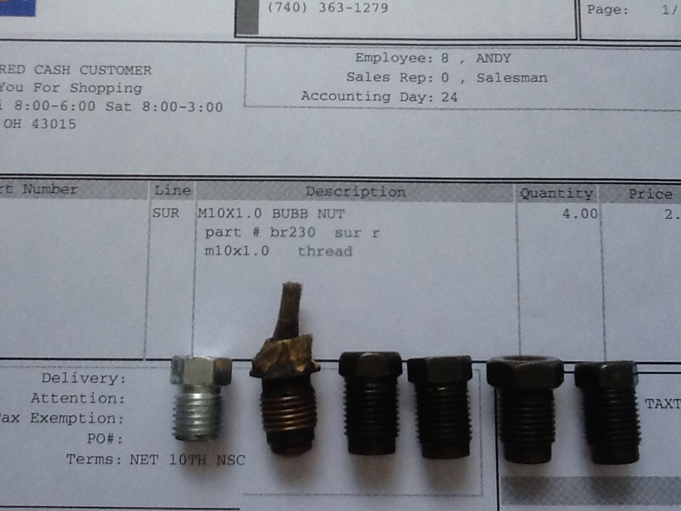

Neil, thank you for pointing this out. The imperial worked fine with no seepage. After seeing your post I went over to NAPA and got the exact size wich is a M10X1.0. The nut is made by SUR&R part number is BR230. The brake pipe line size was 3/16.

Thank you "kahl" for that beautiful attachment! You should take my moniker as the new and improved "Mr. Detail". :)

Interesting re Imperial.
My guess is:
* 3/8 inch ~ 9.50 mm, close enough.
* 24 ~ 0.95 mm spacing, also close enough.
