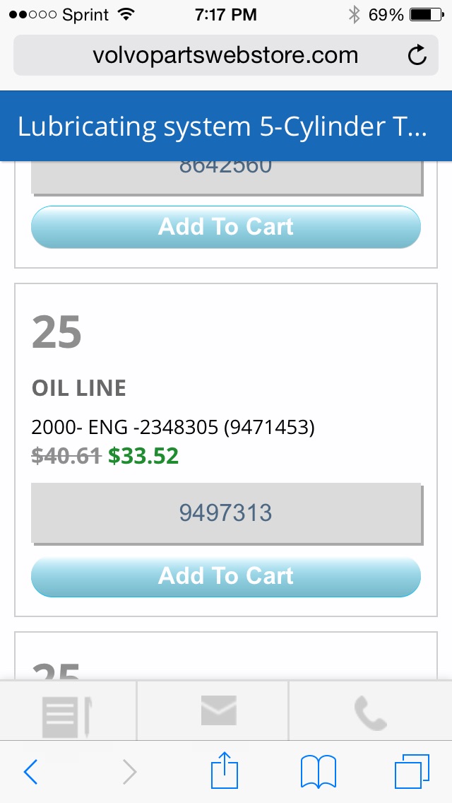

Spoke to my buddy at Volvo parts locally, and he says there are 3 part numbers for the pipe, depends on your engine #:
It is listed as follows:
1) Engine # 1240632-, -1999 # 9186281
2) 2000 - ENG -2348305, (9471453) # 9497313
3) ENG 2348306 # 8642184
If your engine is original, or you can't figure the part # out, PM me your Vin# and I'll get it confirmed.
What was fooling me (not hard) was the picture shown, shows only one variant and not the one you may want.

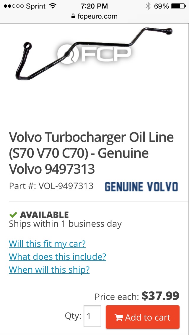

PN# 9497313
#25 I believe this is the correct part per tascaparts vin decoder

Glad you got there. Tasca website has helped me out before as they don't always use layout drawings but in some cases use actual pictures of the part. Who knew that would be helpful!
But you can see why I was confused as the #15 and #25 don't look remotely the same from the 2 drawings.
