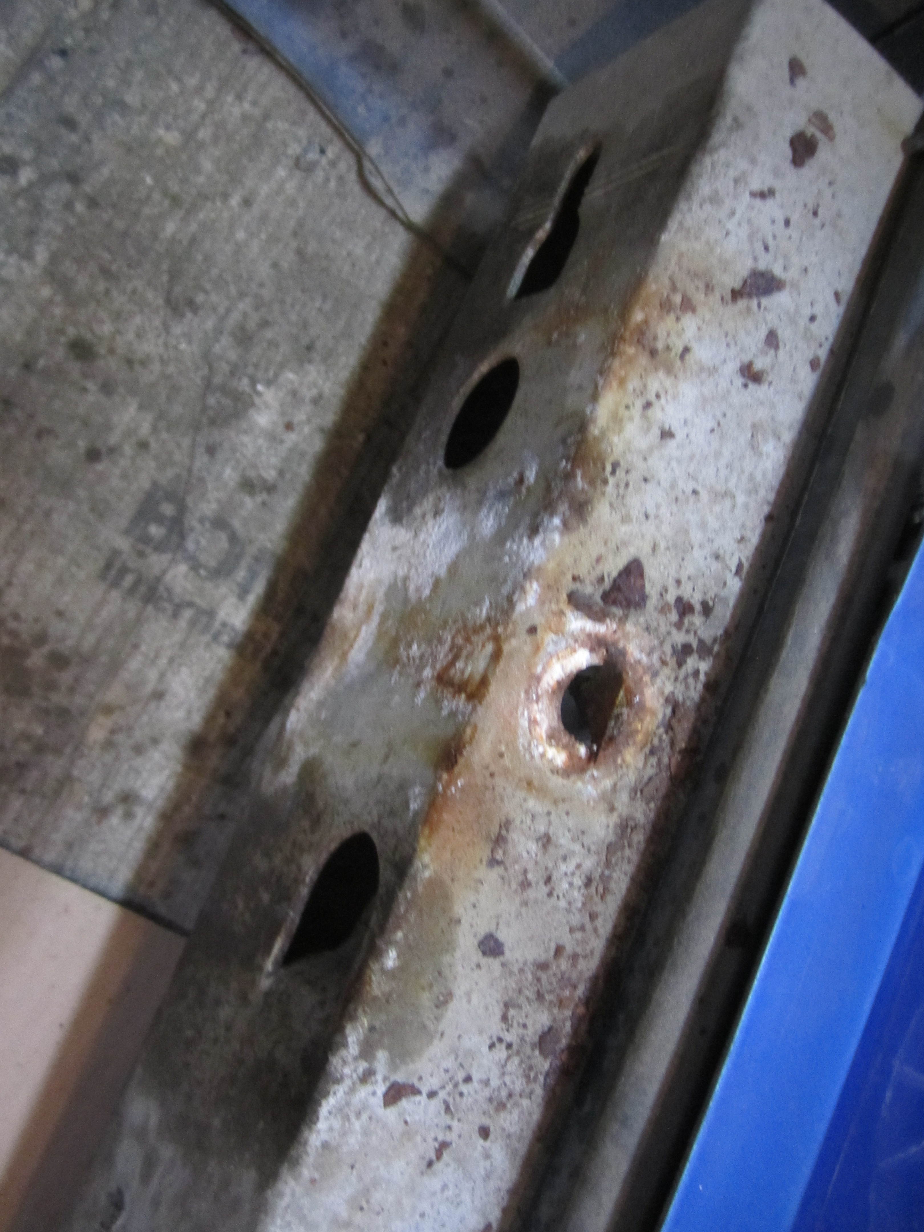

You can see in the picture above, the aluminum bumper stiffener. The single hole to the right face, is the through hole for the long mounting bolt. The 2 lower holes on the left actually are dimples that hide access to the bumper mounting bracket bolts.
This is viewed as looking toward the back of the car.

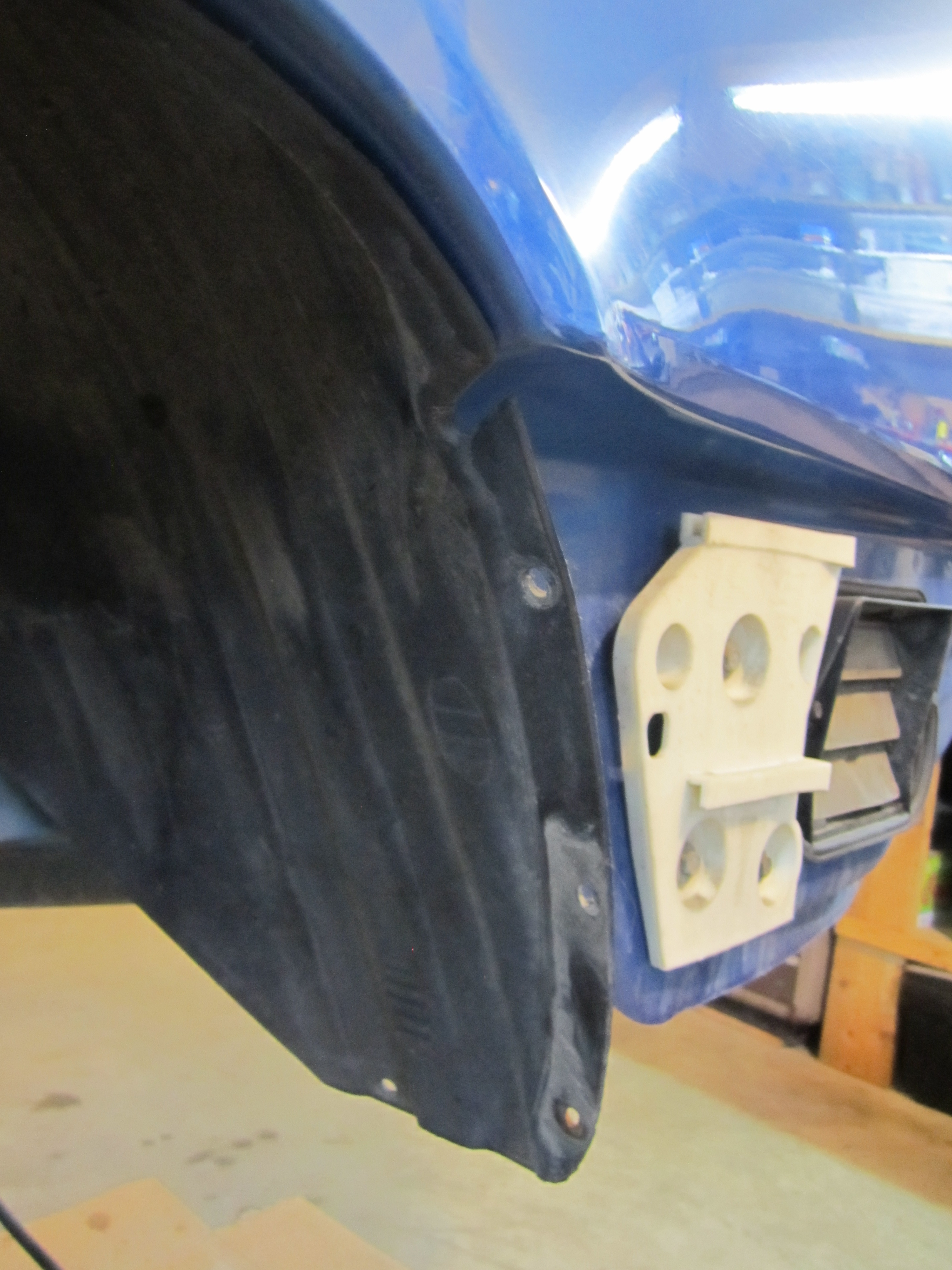

I drilled out the rivets from the wheel arch:
You need to remove/drill out 3 rivets and remove a T25/T30 (?) screw through the top of the bumper edge, and remove the mud-flaps. This now releases the bumper sides to slide rearwards. Actually I did this first, before levering out the good side bracket.

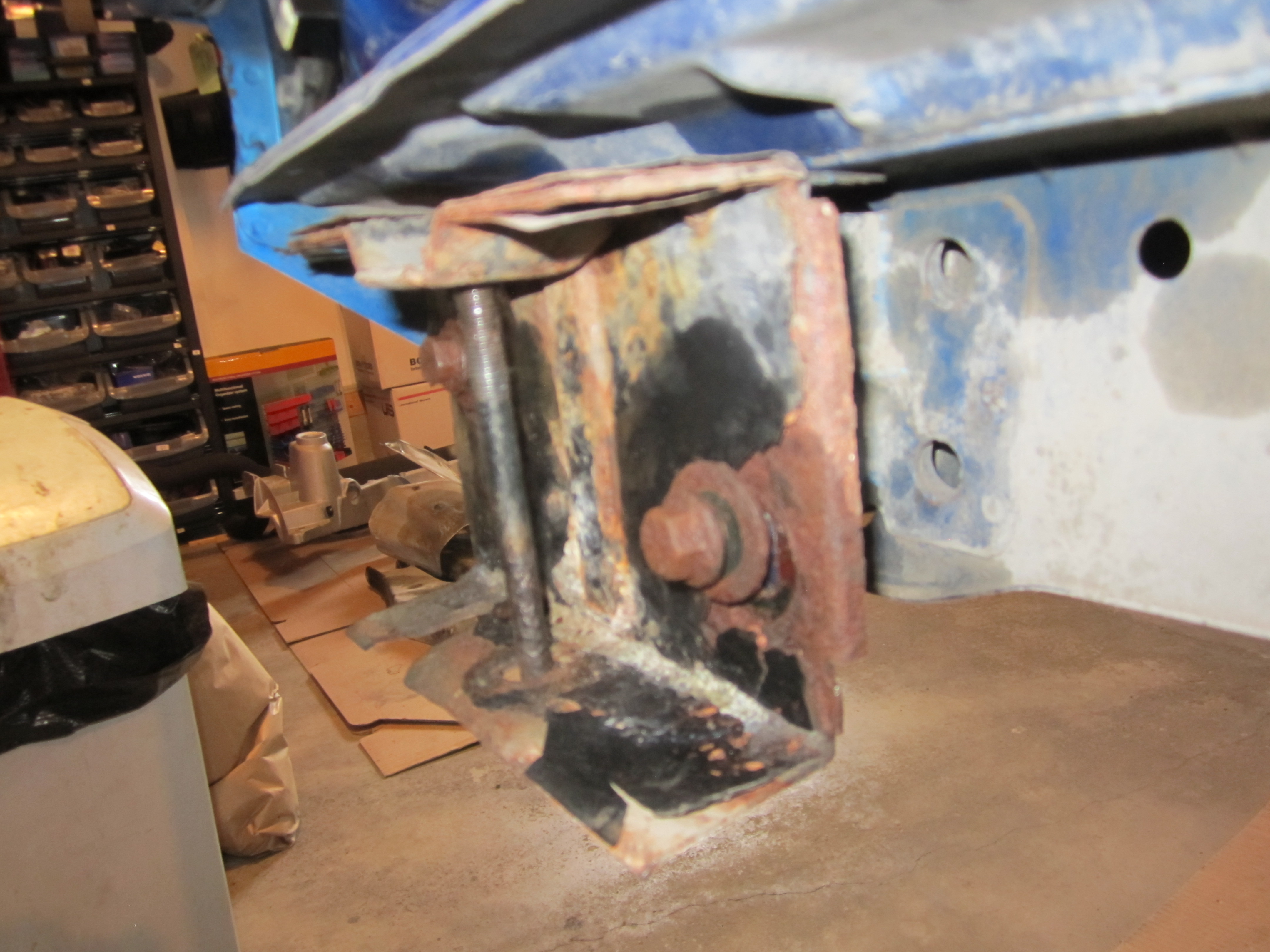

Next, I needed to fold the lower edge of the bracket with the broken bolt in it:
This then gave me room to try to force the broken bracket through bolt to move the bumper out. As the bracket was so rotten, it allowed me to actually move the bumper stiffener out enough to get to the 2 bracket mounting bolts with a 14mm ring wrench. I worked the 2 bolts out a bit at a time and wound them in/out and wire brushed and Deep Creeped them constantly until they eventually came out. I also used the open end of the wrench to get better access.
This allowed me to be able to remove the whole bumper and the bracket.
With the bumper now safely on the ground you can access the bracket and a gentle 'nudge' with a hammer allowed the bolt and bracket to slide up and out of the top of the bumper stiffener.
