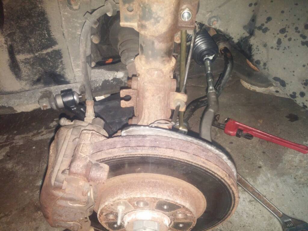

- Posts: 36147
Plenty of room to pull the boot down in this pic stolen from mattymoos rebuild thread
- image.jpg (152.3 KiB) Viewed 1160 times
