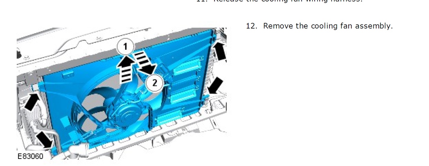

Can anyone give me the correct procedure for replacing the cooling fan assembly in a 2008 XC70. 850's and V70's seem well documented, but not the P3 platform XC70. The fan assembly seems to be designed to come out through the top of the engine compartment, but it's so tight, I'm guessing that something else would need to be disassembled in order to make it possible. The space below the engine compartment seems too small relative to the thickness of the assembly for it to pass through. Any insight would be greatly appreciated.

1. Remove the intake manifold (replace the thermostat and small coolant hose at the same time)
take a look at this link for help http://www.freel2.com/forum/topic32245.html
2. remove and replace the fan assembly
It seems really easy....its not
Good Luck
Paul
PS if you get a chance post some pics after your done to help the next guy out
