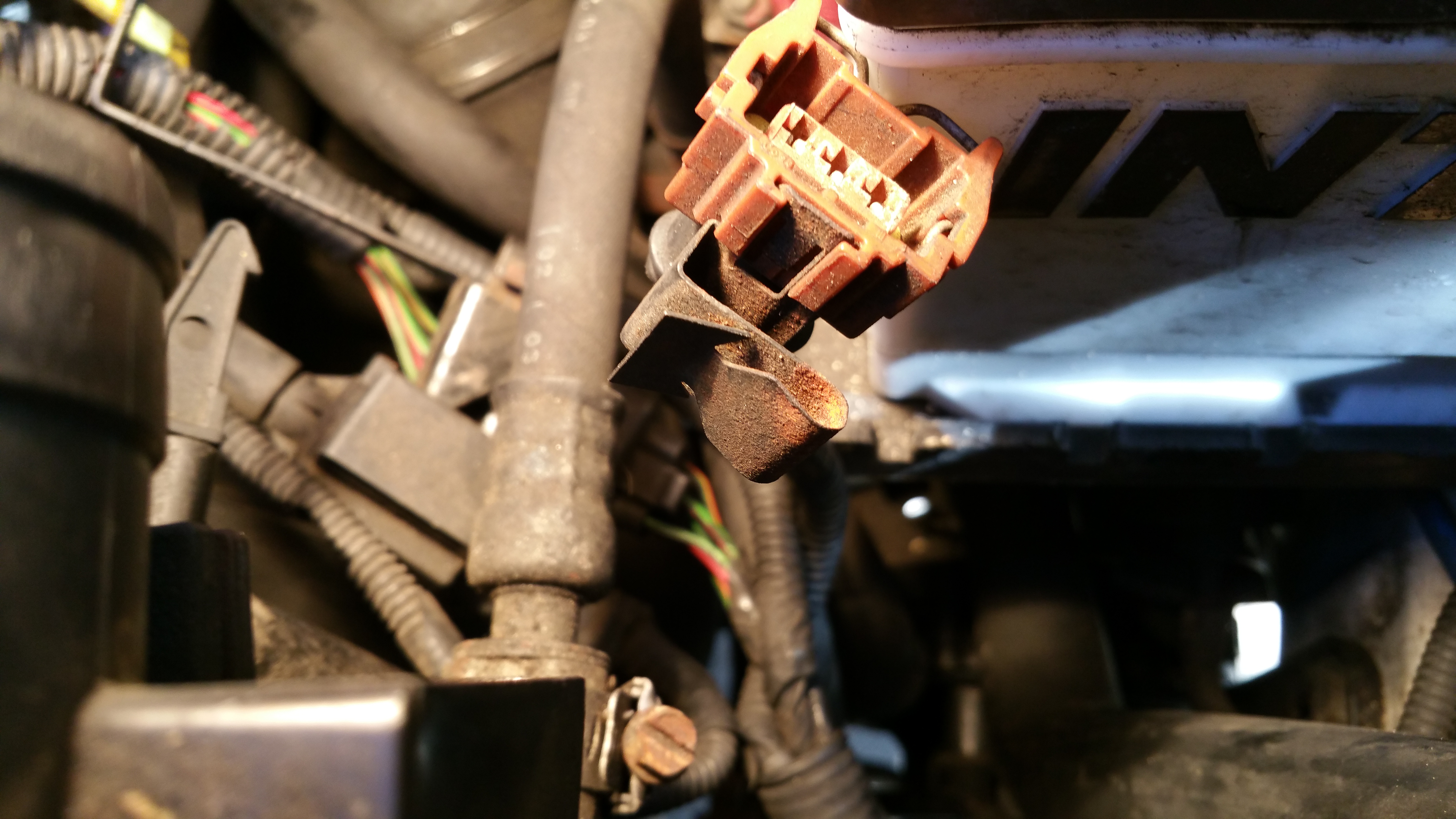

I'm attaching a photo that may well be the problem. It's an electrical connector for which I could not find a partner. I'm not sure if it already was unattached when I got the car or if I disconnected it and just can't find it's mate. It's orange and comes in a cluster with some others and is very near the front of the battery.

Is there another connector on the other side about the same place? That could be for headlight wipers, you may or may not have, but still in wire harness.

That's surely part of the lighting wiring - the one on the passenger side can be hard to find, but I bet you it's there - like obayha said, it's for wipers or extra lights.

The only orange three prong connector it that area is for the light wipers, as the wipers on my '98 have the matching connector. They would be tucked away on other side and hard to find. Mine didn't look orange until a little scrubbing.
Forget the plug and check and answer the other questions asked and see if we,us,them can get you back on the road.
