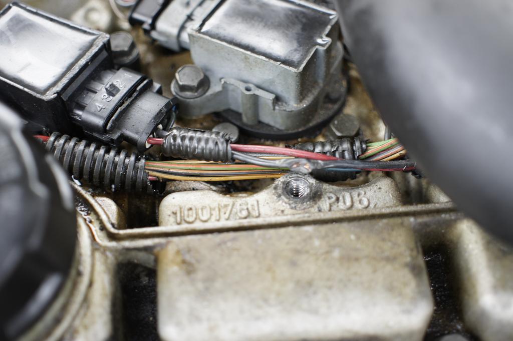

Hi y'all, I just picked up a 1999 V70 XC for a song. Previous owner said it had a misfire but he had no intention to fix it. I took the chance since the price was too good to pass. Heck, even I have to do a head work the price is still not bad.
I took the car home and pulled the code. Sure enough misfire on cylinder 3. When I open the engine cover, first thing I noticed was there was lots of oil under the engine cover. So the PCV is clogged I guess. Then I immediately noticed what might be the cause of the misfire -- someone carelessly drove one engine cover bolt through the ignition wire, so the circuit was completely shorted! Still waiting for my compression tester to come and fingers crossed no need for a head work!
I have seen lots of discussion on the coil pack but had a hard timing finding info regarding the ignition wire bundle. I am wondering what my options are: replace the wire with some OEM parts or just solder it? Please advise! Thank you all!

I am only concerned that the tube will not block moisture very well. And if I need any patch wire, what gauge/whatever other spec should I be looking for?

Also I just noticed there are actually two black wires run parallel, should I keep them separate or is it ok if I mix them up?

Black wires are likely ground so that smashed wire may not matter.

so it is still possible that I am facing a head job down the road! my compression tester is on the way....rspi wrote:Black wires are likely ground so that smashed wire may not matter.
- Posts: 36142
One is the HV ground and I think the other is 12VDCcohomology wrote:Also I just noticed there are actually two black wires run parallel, should I keep them separate or is it ok if I mix them up?
You cannot mix them up.
Just cut, solder, and tube /electrical tape the repair. These are low current wires so they are easily dealt with
Try moving the number 3 coil to cylinder 1 to see if your misfire code moves
Pull all the spark plugs , take a picture and post here
Make sure the 10mm M6 bolts holding the coils are tight and clean, these are also the coil grounds
The 1999 on models hVe a lot less trouble with PCV blockage than the earlier P80 models as the long PCV tube is heated with hot coolant which keeps the vapors from condensing.

Best way to fix including water proofing.
use liquid tape and heat shrink tube over the solder joint.. I use liquid tap over the solder joint and wait until it dry before using heat shrink tape. Water going inside the tube is not going to cause any problems.
