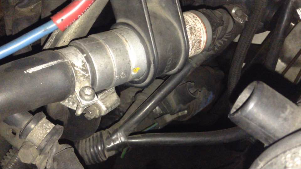

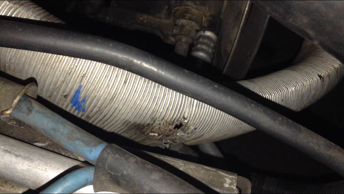

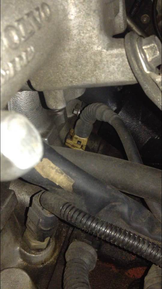

I'm not positive that this is the ect sensor I'm no expert but I think it's the yellow one right?
And does this picture help figure out if I has an egr setup?
Yeah it doesn't get too cold over here I just mean when the engine is cold haha

Ect sensor yellow one?
Egr setup?
Egr setup?

kaiboy760 wrote:ect sensor
The yellowish one has a spring clip on it that is pushed in towards the plug itself, and then gently pull upwards. If you can, ground an ohm-meter on engine block, and measure both sides of the ECT. The other plug is for dash's temp gauge.
The other item shown is an Idle Air Control (IAC), and it can be cleaned up internally.
On Rex-I/Regina, the IAC is specific to Regina...a Bosch LH 2.4 IAC will not work.
On Rex-Regina Ignition, there is an air temp gauge; clean it too.

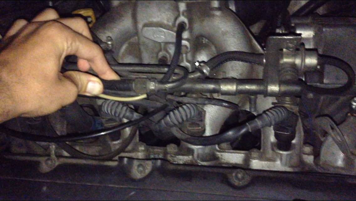

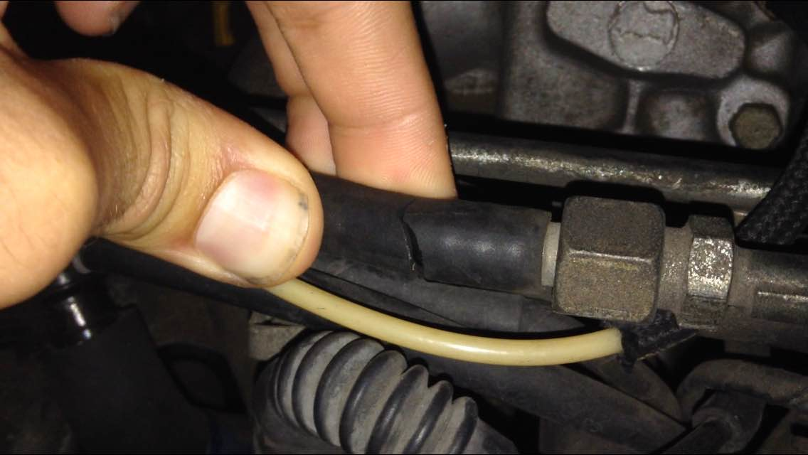

Noticed this crack, could this be causing any problems?
zoomed out
zoomed out

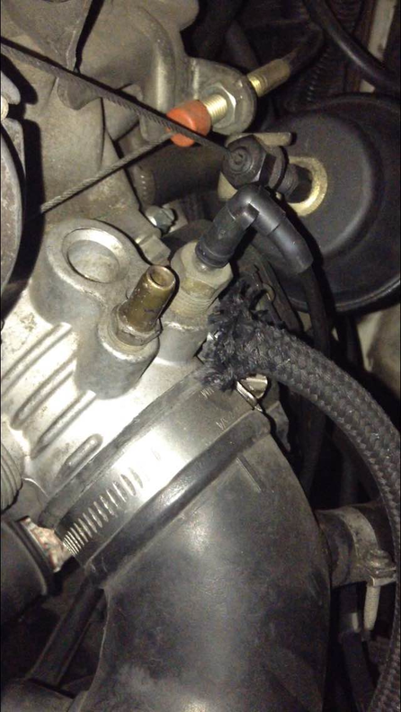

this hose keeps popping off the throttle body, doesn't seem to affect the way the engine runs whether if it's connected or not. What is this for?

Throttle Body Port - For emission control...there should be a charcoal canister adjacent to driver's side headlamp, on its rear side. Myself, leave it hooked up, cause it sucks fumes from gas tank. It looks like someone has replaced that hose; mine is just a rubber hose.
Pre-Heat Hose - I would disconnect that silver tube where it inserts into air filter box. If the thermostat is working inside of air filter box, incoming air will be regulated so it is at a set temperature. Problem is, when thermostat fails, engine receives hot air from exhaust header.
Rubber Hose Cracked - That's the high pressure fuel line, but I think the outside part just has a rubber sheathing to protect inner hose.

Cracked rubber hose has a nylon inner tube.
