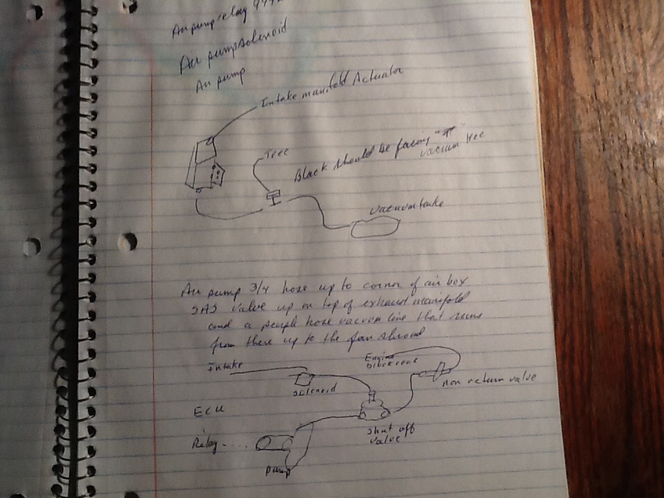

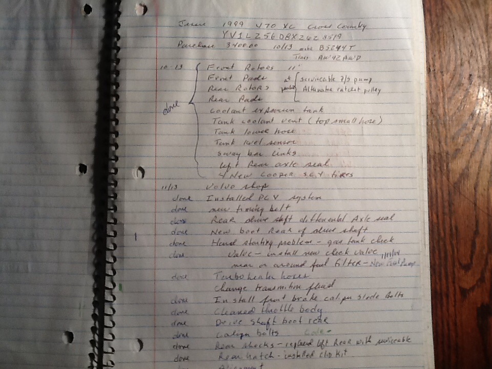

I think where to start would be an inspection of engine, transmission, suspension and fluids. I would get a notebook and start taking notes of your car.
Spark plugs are easy. If coil packs are good leave them alone. If you can find a throttle body from the same car it should be a direct install. We have 5 V70 XCs in the family. Here are some notes of their preliminary inspections.
- Take lots of notes
- image.jpg (169.29 KiB) Viewed 1632 times
damn quite a list... maybe you could put that in excel, i have terrible eyesight.
