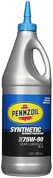

Pennzoil Synthetic Gear Lubricant (75W-90)
Fully synthetic. GL-4. And from Pennzoil. Some folks love their Pennzoil. One would think that you could find this in an Autozone (they sell all their other Pennzoil stuff...) but no, you won't find this everywhere. In fact, half of the reviews on Amazon complain about how hard it is to find this oil. (The other half complain about the tip that needs to be cut in order to be poured?) No one seems to be complaining about the price. At over $30 a quart, this stuff is super expensive... Anyone put this into their tranmissions?

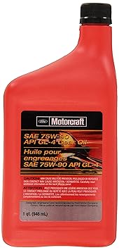

Ford Fluid XT-4-QGL Gear Oil (75W-90)
I don't think it's synthetic... It's Ford. I know they make decent oil filters. (Nothing any of us would ever use... but decent for other cars!) I might put this into my car. Again, if it didn't cost more than the Volvo branded stuff. At $24 a quart (a quart!!) you have to really believe in this to use it. Anyone try this?

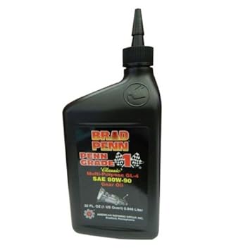

Brad Penn Penn Grade 1 Multi-Purpose Classic (80W90)
Dyno oil. Love the "classic" on the bottle! Isn't my wife's 98 a classic? It's a GL-4 and one review on Amazon has someone using in their 56 something or another... I guess it would work. It's only $10 a quart. :mrgreen: Anyone experiment with this?

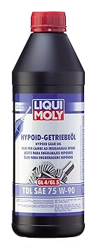

LiquiMoly HYPOID-GETRIEBEOL (75W-90)
Like Pentosin (and to a lesser extent, Motul) here's LiquiMoly's HYPOID-GETRIEBEOL! It is fully synthetic and seems to be compatible with everything out there. It's another one of the GL-4/Gl-5 gear oils out there. It's $17 bucks with prime shipping. I almost pulled the trigger on this one. Seriously, what is there not to trust about LiquiMoly? But it's only got one review. (And it's a crappy review about better gas mileage! Who cares about mileage, I want buttery shifting!) Could any of you see yourselves using this? It certainly sounds like it'll work... And work kind of nicely. Hmmmm
Here's what they write about this oil:
Liqui Moly's Hypoid Gear Oil TDL SAE 75W-90 (GL4/GL5) is a multi-purpose gear oil for universal application in commercial vehicles. This "TOTAL DRIVE LINE" (TDL) gear oil is most suitable for lubricating all drive elements, from synchronized and non-synchronized manual transmissions to geared axle drives. Because of the reduction in the number of product types and the reduced risk of confusion between them, Hypoid Gear Oil TDL contributes significantly to streamlining the modern vehicle fleet. Reduced friction as a result of the optimum viscosity level helps to save fuel. Universal use for all manual, auxiliary and differential transmissions. The transmission manufacturer's instructions must be followed. <-- LOLZ :lol:

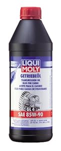

LiquiMoly GETRIEBEOL (75W-80)
LiquiMoly's pure GL-4 gear oil. I don't know if it is synthetic. Can't seem to find the information... $19 a liter is pretty pricey...
