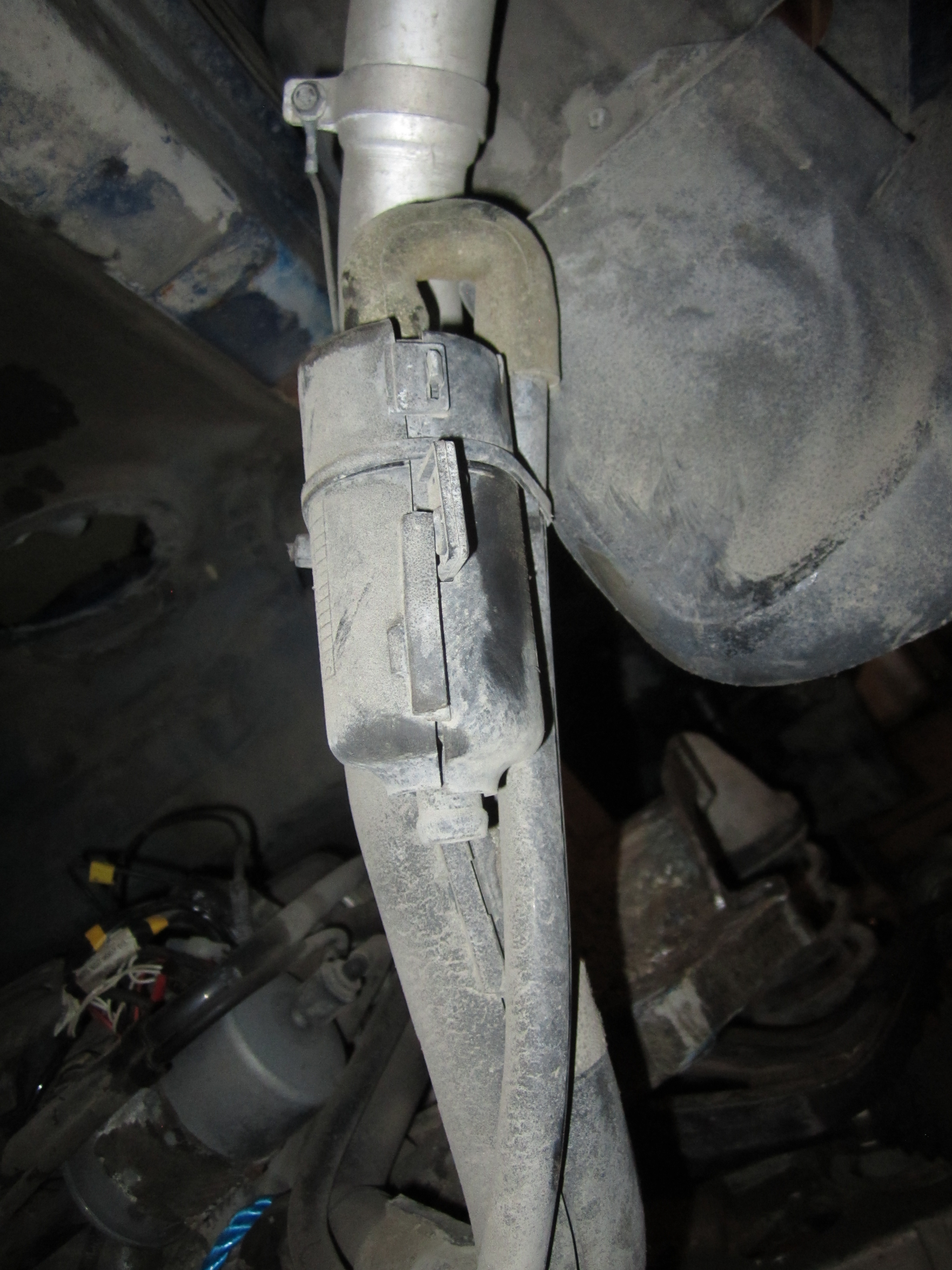

Not as familiar with FWD fuel systems, but many of the V/S 70's have an air filter in the fuel system mounted up at the top of the fuel filler pipe. I don't know if there is a recommended service interval on these, but depending on where you are driving, perhaps they get blocked. Also if your car has an anti-roll over valve, these can also fail or partially fail not allowing air to exit the fuel system quickly enough when filling causing the system to 'choke'.
If you decide to replace the fuel line air filter, be careful with the old plastic protector as they are obsolete I believe (but do verify). Warming the clips may help to make the plastic easier to bend to pop out the clips holding the filter cover together.
I paid about $40 CDN for the filter (about $30 US) from my local dealer.
This is the filter protector/holder on my 2000 V70R AWD.

I have pulled a few tank/filler neck assemblies now, nothing like that filter on the FWDs I have worked with. I learn something new every time Neil posts about AWD (and then promptly forget most of it lol)!

I'll have to go outside and look when I get a few minutes. I think I remember seeing a plastic housing like that on the fuel filler neck.scot850 wrote:Not as familiar with FWD fuel systems, but many of the V/S 70's have an air filter in the fuel system mounted up at the top of the fuel filler pipe. I don't know if there is a recommended service interval on these, but depending on where you are driving, perhaps they get blocked. Also if your car has an anti-roll over valve, these can also fail or partially fail not allowing air to exit the fuel system quickly enough when filling causing the system to 'choke'.
