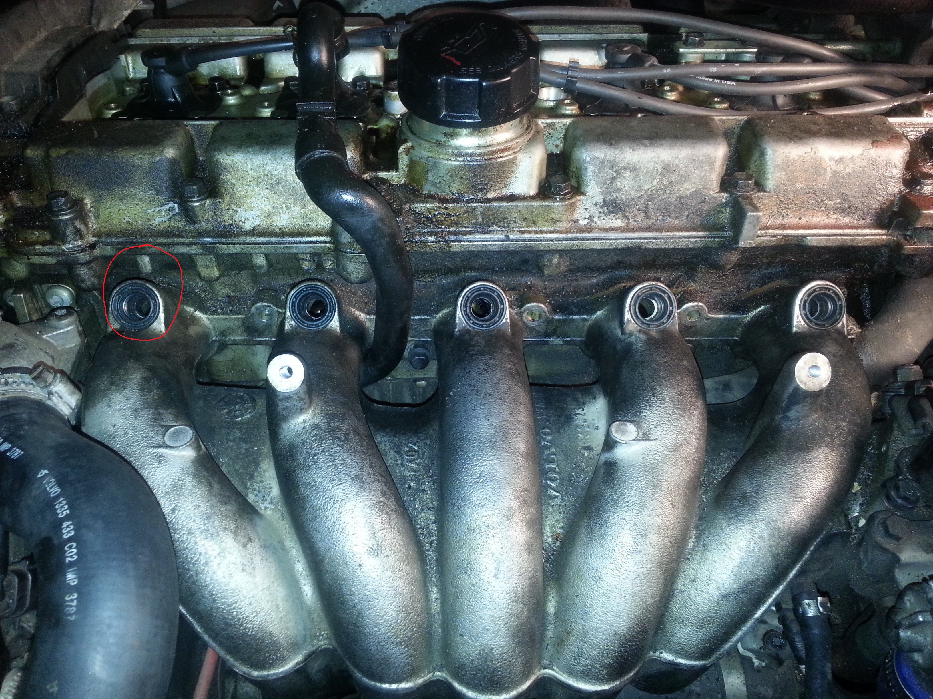

EDIT: OK i went ahead and kept going the PCV replacement, I took out dipstick, unscrewed the bolt under the intake, then i took out the top 3 bolts on the manifold, loosened the bottom four, although my 10mm got stuck on the bolt under the thermostat,i figured i'll take the manifold off and then take it out...but manifold doesn't come out! it keeps hitting against the head i can't lift it out. I circled in red the part that keeps hitting that metal notch when i try to lift the whole thing up. Is there something else stopping it from coming out??

You need to loosen the bottom four to get some movement of the manifold towards the front the car...not just crack them. On my 1999, this was 2-3.full turns, or even take them out. Find them and put them back in to reinstall of course.

What abscate said. Loosen them quite a bit, then tilt and lift.

Use smart phone or mirror to take a look down there to see if there is anything holding the intake manifold.

i can't seem to find anything else holding it, it just keeps bumping into that notch when i try to lift it up. I've just given up and tried to put everything back together...EXCEPT now i have yet another issue is that the manifold for some reason got shift to the right, if you can see in the pic. I can't push it back for some reason... i don't know what made it do that....

should i just remove the lower four bolts?? does having an EGR mean there's more bolts to take off??

- Underneath the Intake Manifold: reach your hand down, there are two (2) 12-mm bolts holding the Manifold to the L-shaped bracket(longer bolt) and Engine Oil Dipstick (shorter bolt). If they don’t come out, get a socket and long extension passing in front of the subframe and come from underneath with breaker bar (R hand hold socket/swivel extension; L hand holding ratchet/break bar). No need to have car on ramp. I did all this job from above.
