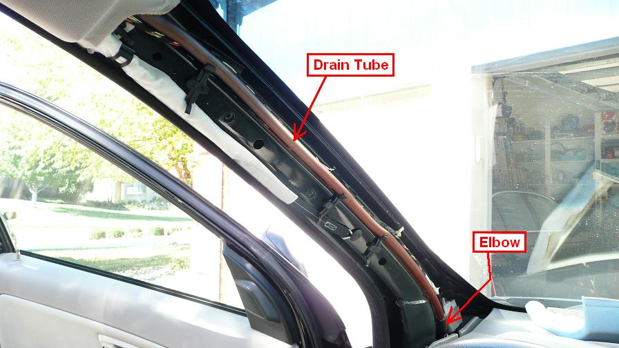

PROCEDURE:
1. Pry the tab off, and remove the 8-mm bolts.

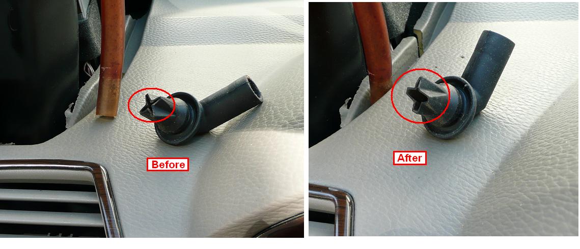

2. Drain Tube drains into Rubber Elbow:
3. Not sure why the Rubber Elbow has flaps to restrict flow (my BMW X5 has the same design!!!). I cut diagonally to increase flow. Whatever you do, during installation, make sure the Rubber Elbow fits properly (pay attention to the flange that sits inside the car round hole).

4. I put 2 Zip Ties (optional) as shown to prevent the tube from coming off the Rubber Elbow.
5. During re-installation, make sure the Black weather strip sits on top of the White Trim.

3. The rubber valve that I posted above: in some cars it does not exist. I think this rubber valve is over-engineered and contributes to the clogging process. This was why I cut it open to allow more water to flow.
I did this (cut the rubber valve open more) yrs ago, and so far so good, zero issues.
