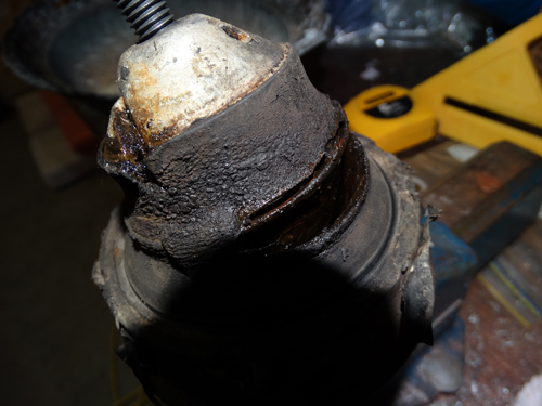

So I am fairly certain now I have a warped flywheel, the problem started a few months ago and I first tried to ignore it. From releasing the clutch in first gear there is a engine shudder, it seems worse when hot...there is also a shudder when down shifting to 2nd. I was hoping it was the engine mounts and checked the top stabilizer finding the firewall mount had completely failed.
New firewall mount installed and the shudder was reduced but still there so I replaced the gearbox link brace and also the main two mounts, the rear mount had also failed. The rear mount on a turbo car is really difficult to replace, I had to remove the bracket because the turbo almost sits ontop of the mount...anyway a very little shudder remains if I feather the clutch..if I give it some gas and let the clutch out fast its ok but will sometime get tyre spin on a hill.
here is a pic of the rear mount that had failed, the massive hole wasn't visable from under the car and cant be seen from top because of the turbo.
