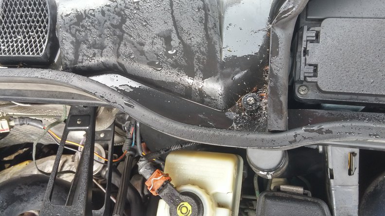

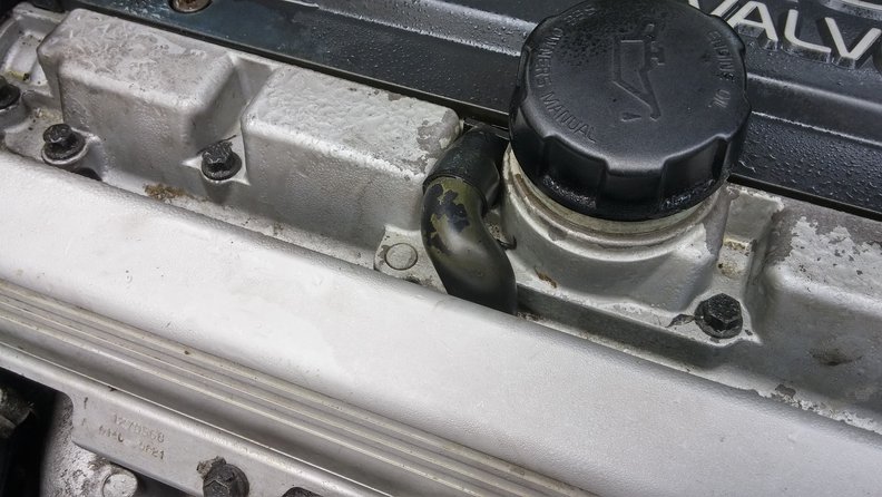

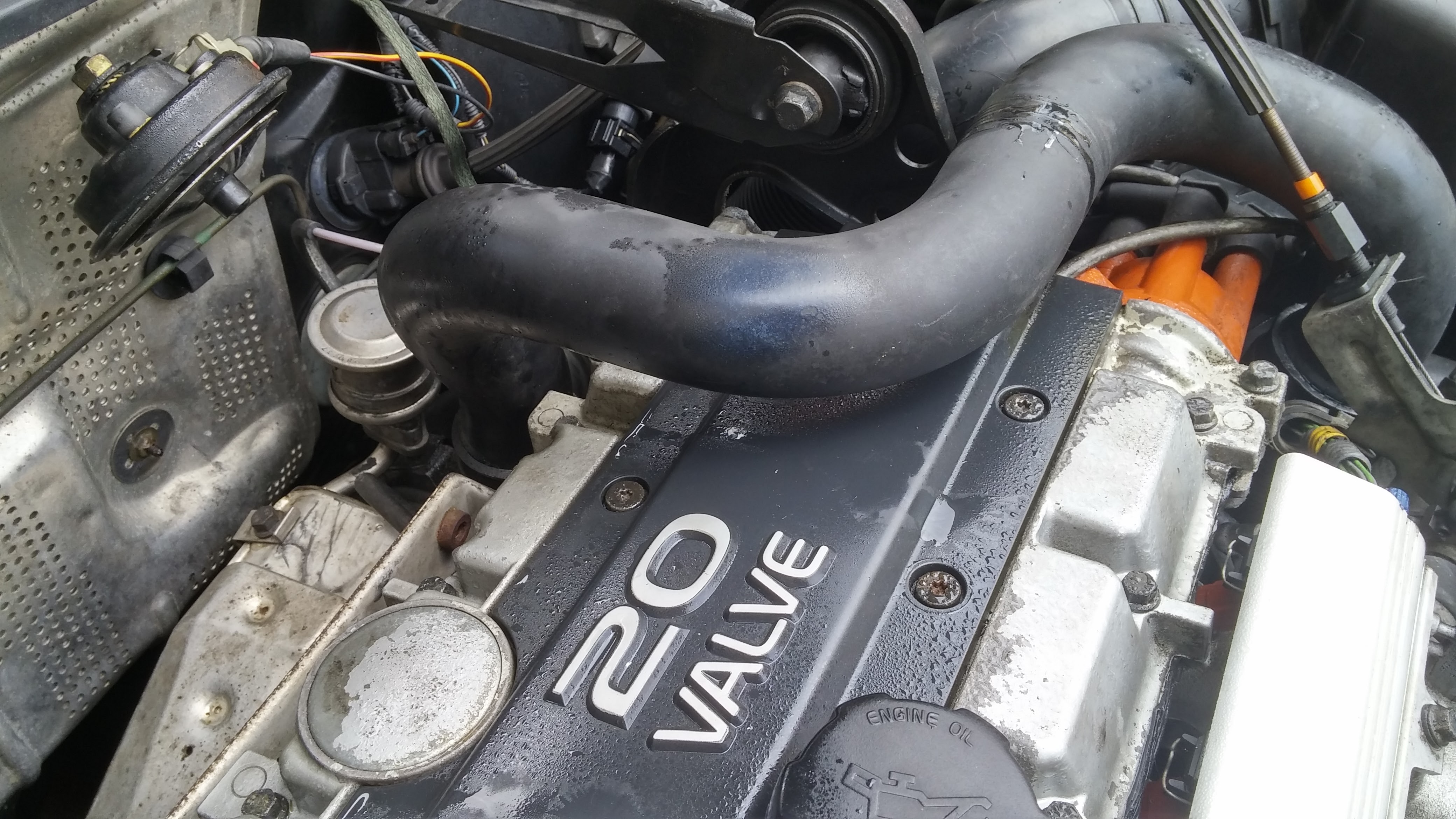

It's been rainy here the past two days, and I had just put in new license plate lights, and I was going to test them. I opened the hood to jump the car, and I find water everywhere. Just looked like condensation from something, but it was definitely wet. The valve cover, spark plug cover, thermostat housing, radiator hose, brake booster, and battery were all wet. There is also and iridescent blue residue on the intercooler hose and strut tower, and green on the valve cover PCV hose. It won't come off, and it seems dry.
I left the hood up and ran some water on the windshield to see how it drained. There was nothing coming in, but there was water pouring out near the steering rack. I'm pretty sure that is a drain that's supposed to be there (if anyone knows, that would be appreciated). It's on the passenger side, just in front of the fire wall.

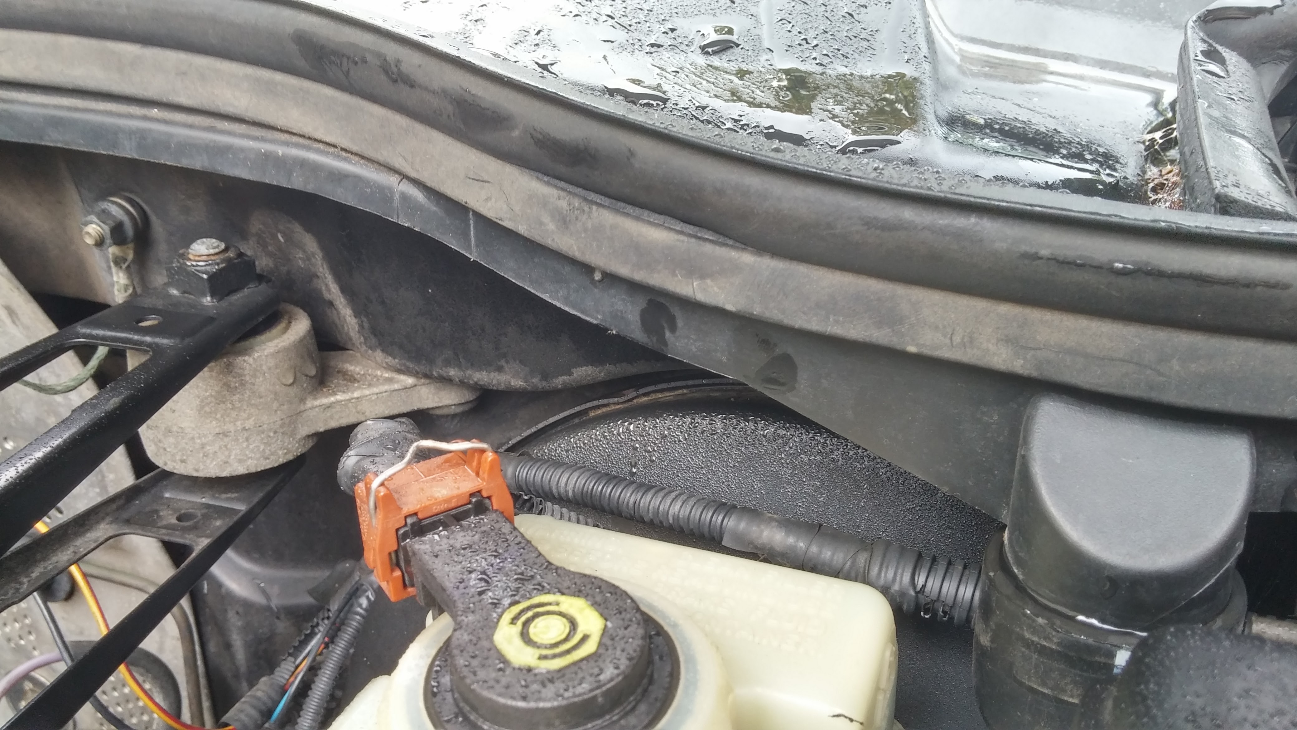

I thought it could be that seal along the cowl where the wipers are, but it doesn't seem to be coming in there. It is broken, but that doesn't seem to be a big problem. However, water is dripping down right onto the brake fluid reservoir and brake booster through that cowl.
Does anyone know where the leak is coming from, and how I can repair it? Should I run some RTV along the bottom of that cowl?

On the pictures it looks like water condensation rather than a leak, with most of it occurring on the metal srfaces. This can happen easily if the car has been sitting a long time in warm humid rainy weather.
I would blow the excessive moisture with some compressed air or even with a leaf blower before I start the engine, just for peace of mind.

That's what I think, but the turbo/exhaust manifold shield collects a lot of water.

To the OP: There are drains for the cowl below the windshield on both sides of the engine. I've circled them in your photos. Each has a hose (about a foot long and 2in diameter) attached with a spring clip. Either remove the hoses, clean and replace or flush with water and compressed air. Once these are free, you'll have much less water in the engine compartment.

Okay, those ARE drains. Thank you, and I'll take a look at those today!
- Posts: 36149
- Been thanked: 4068 times
Yuo will need to clean the holes up top, where the hoses attach, too. It looks like they are blocked.
