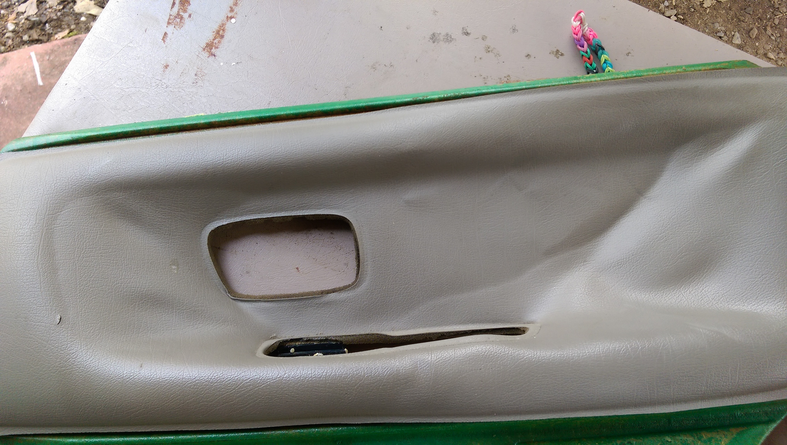

This is a write up of my solution to the ugly door panels that the 98-00 Volvo's suffer from. It may not be for everyone and improvements to this method are welcome and wanted.

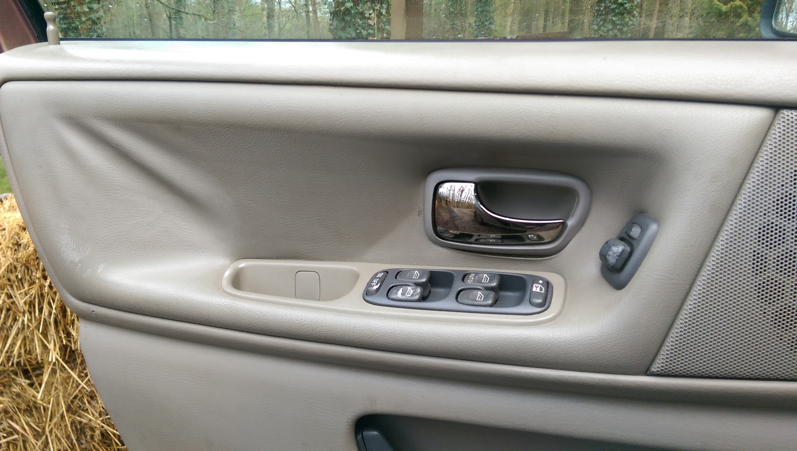

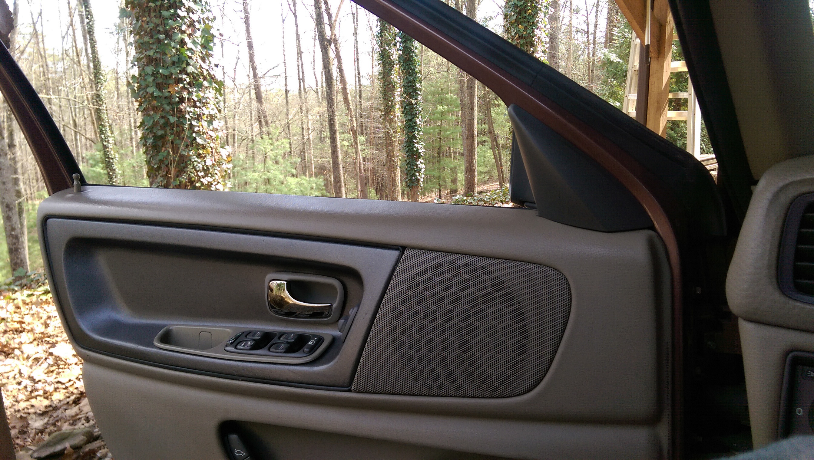

Many of us have this in our cars.
And this is my solution.

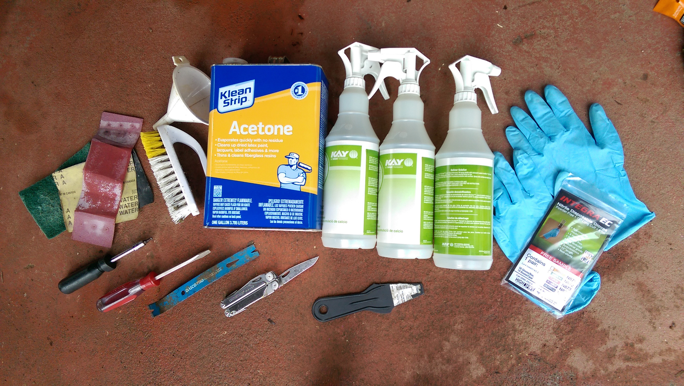

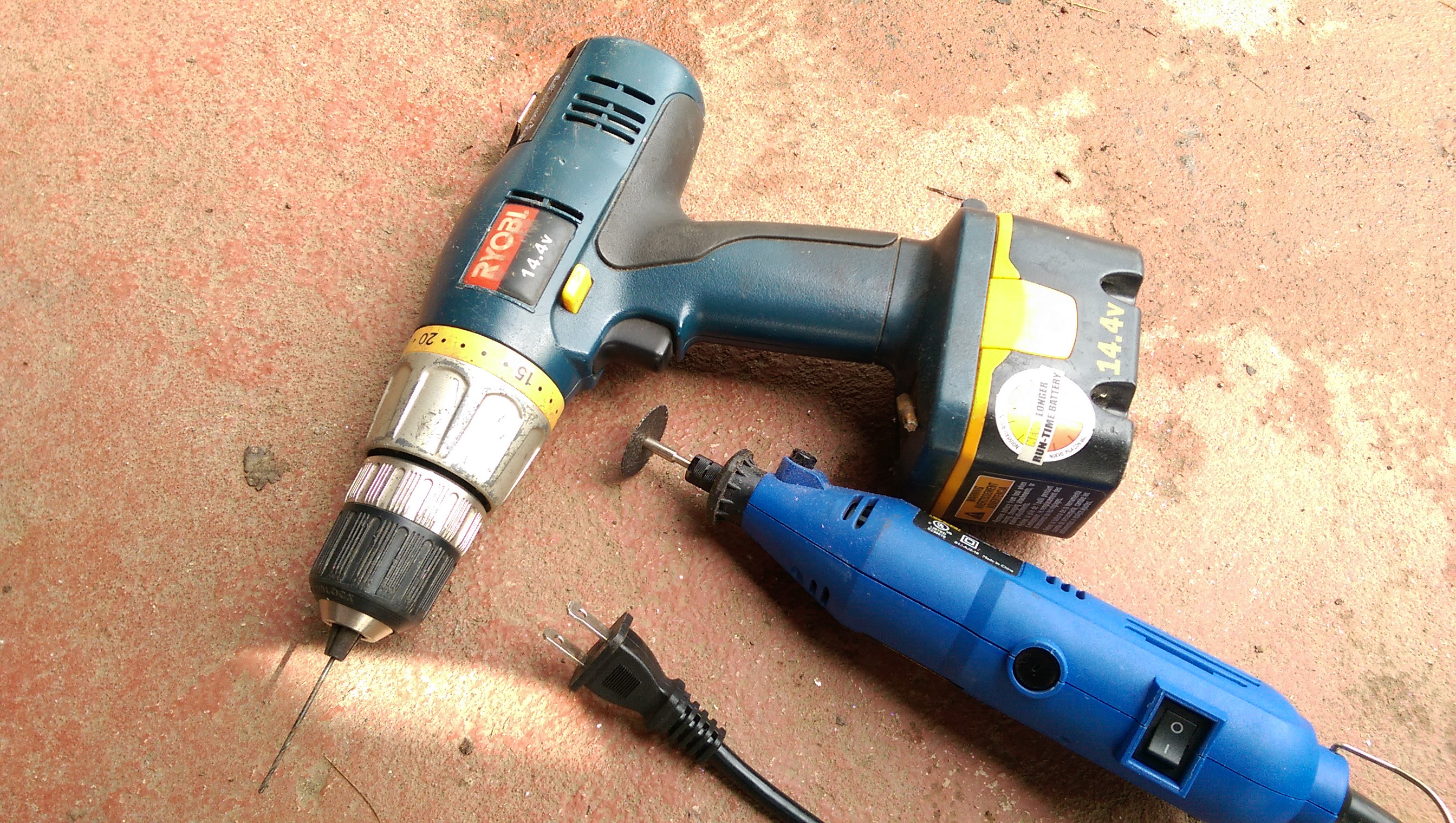

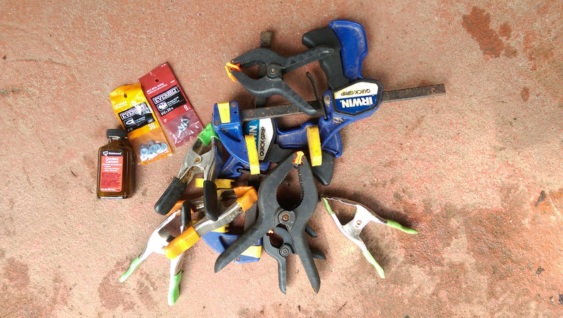

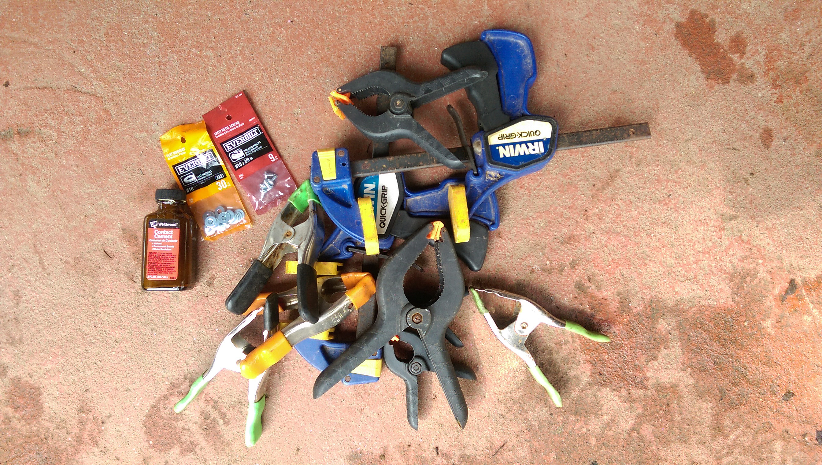

To get to this point use the following tools and chemicals.

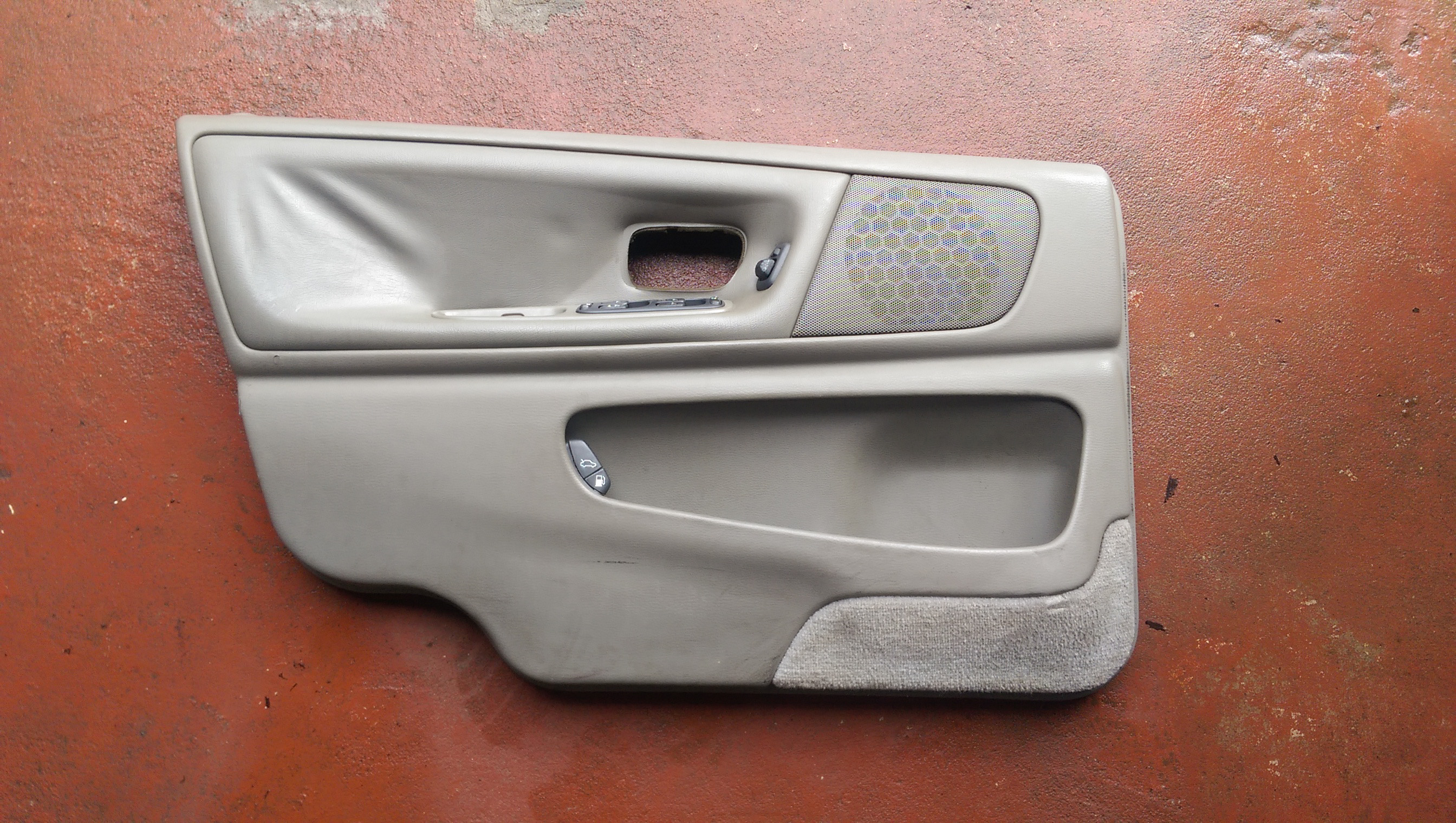

Remove the panel. No details on how this done here, check out posts on how to remove door panels in this forum.

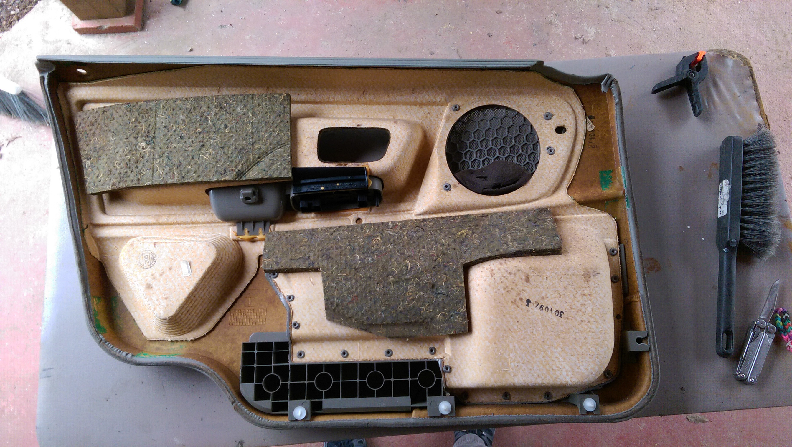

This is where you will begin to disassemble the panels, from the back.

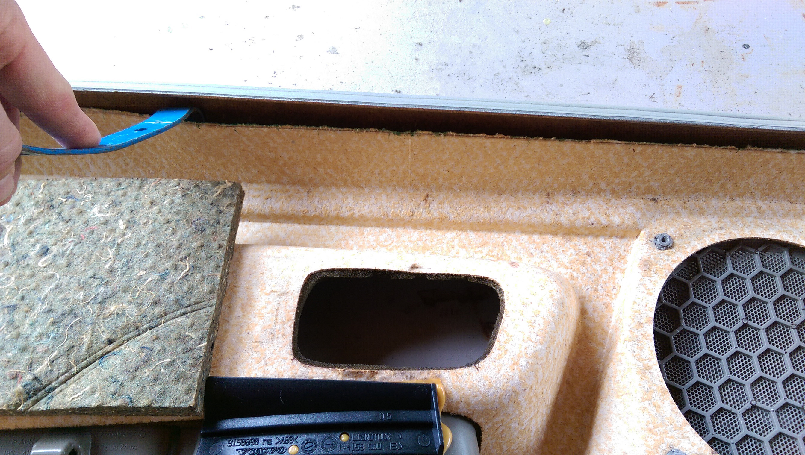

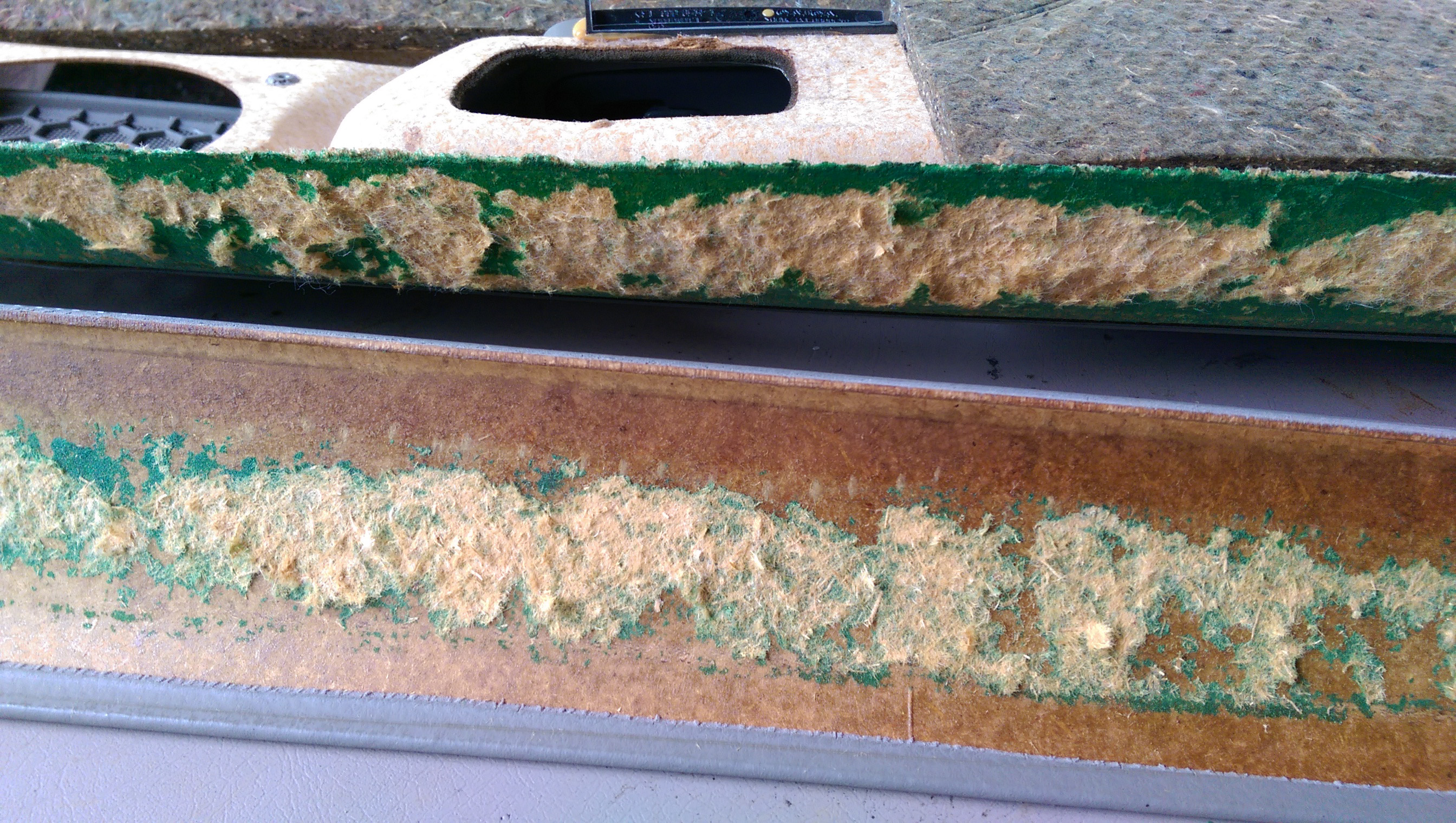

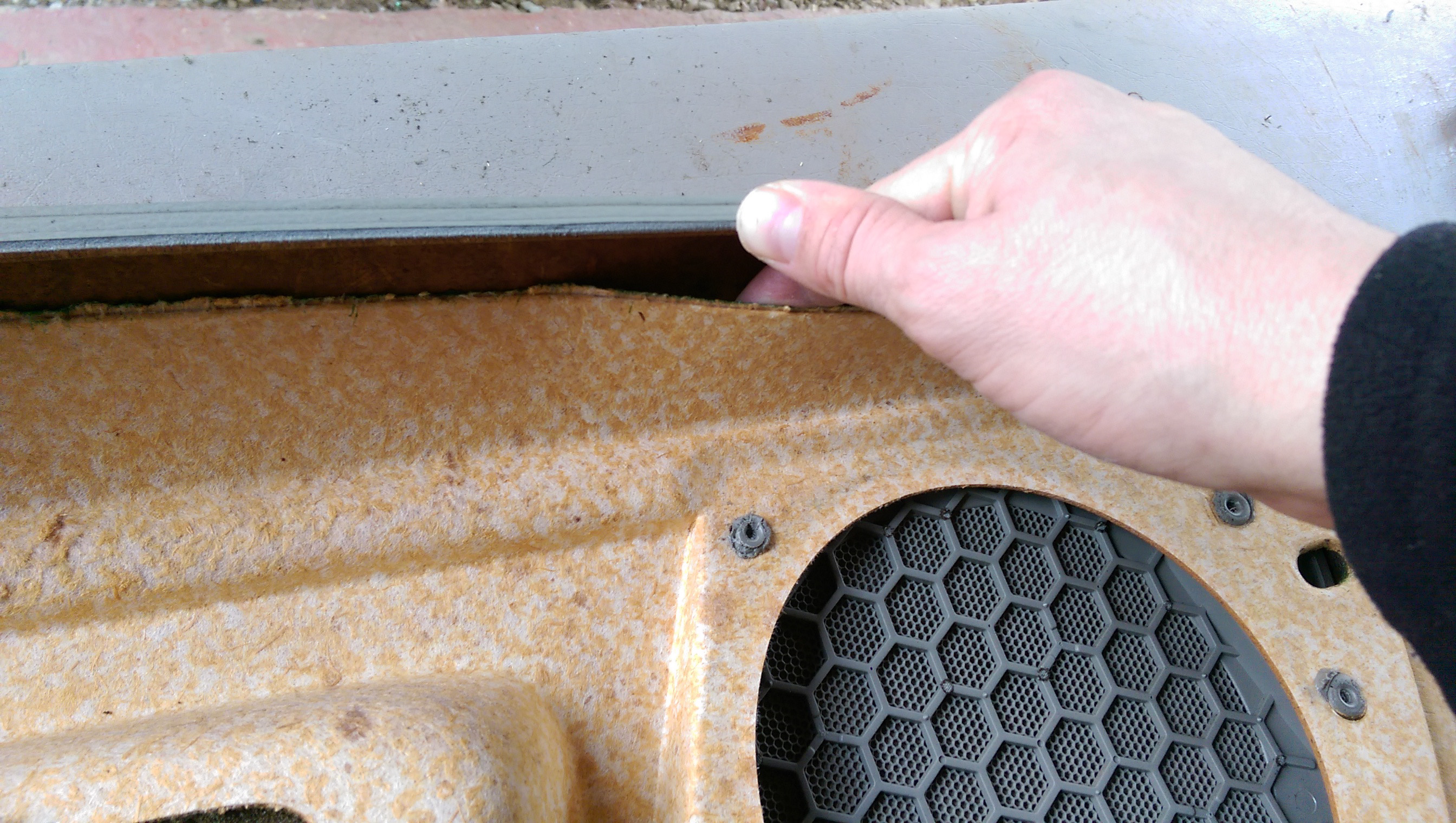

The glue in many of the panels in these cars are no longer holding everything together. You can pull and pry all around the edges of the fiberboard to loosen the two main parts.
Use tools to get behind the fiberboard and pry apart the two parts.
Some sharp tools may be necessary.
Some areas are easier than others.

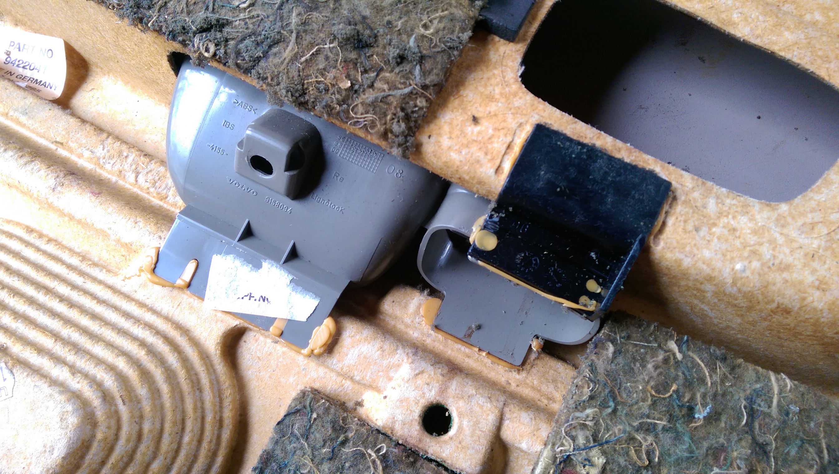

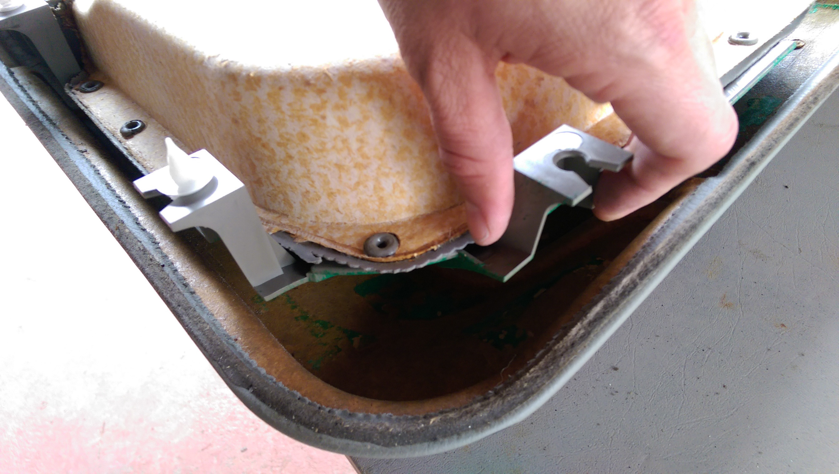

The area where the handle is glued together has very strong glue. Take time and care cutting this area. Only cut loose the grey handle from the fiberboard and the black plastic. Don't cut the black plastic from the fiberboard. The grey plastic part will pop out of the panel once you free it from the glue. Remove all the glue from the fiberboard/handle, because when replacing the handle, the fit is different and needs to set lower.

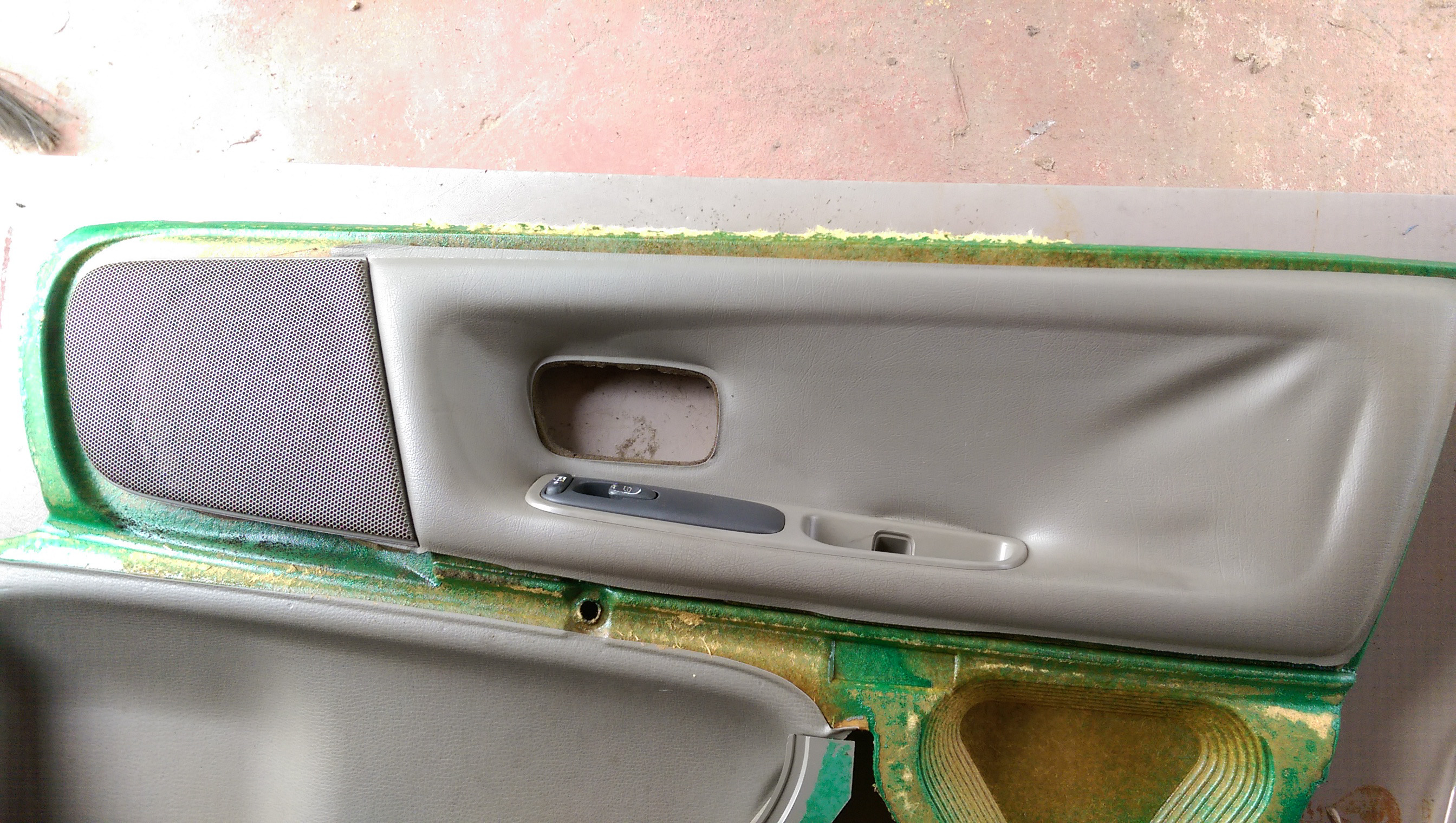

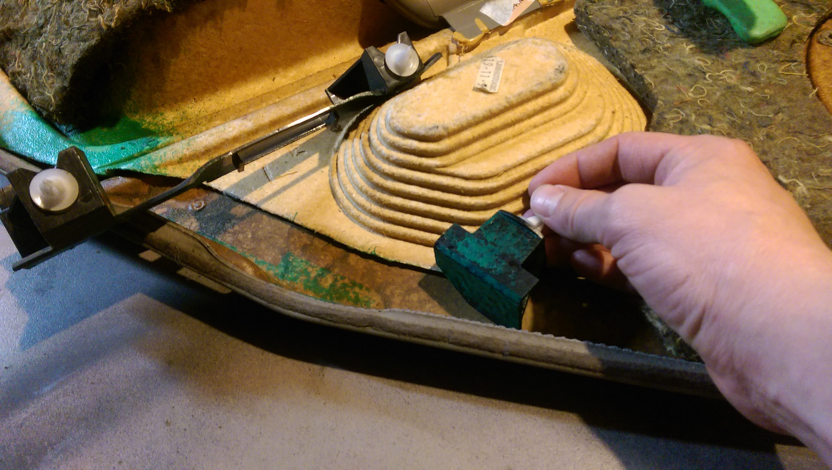

The two main parts will eventually come apart.You will most likely also have a few of the black panel clip attachment points fall off, not to worry they can be glued back on.

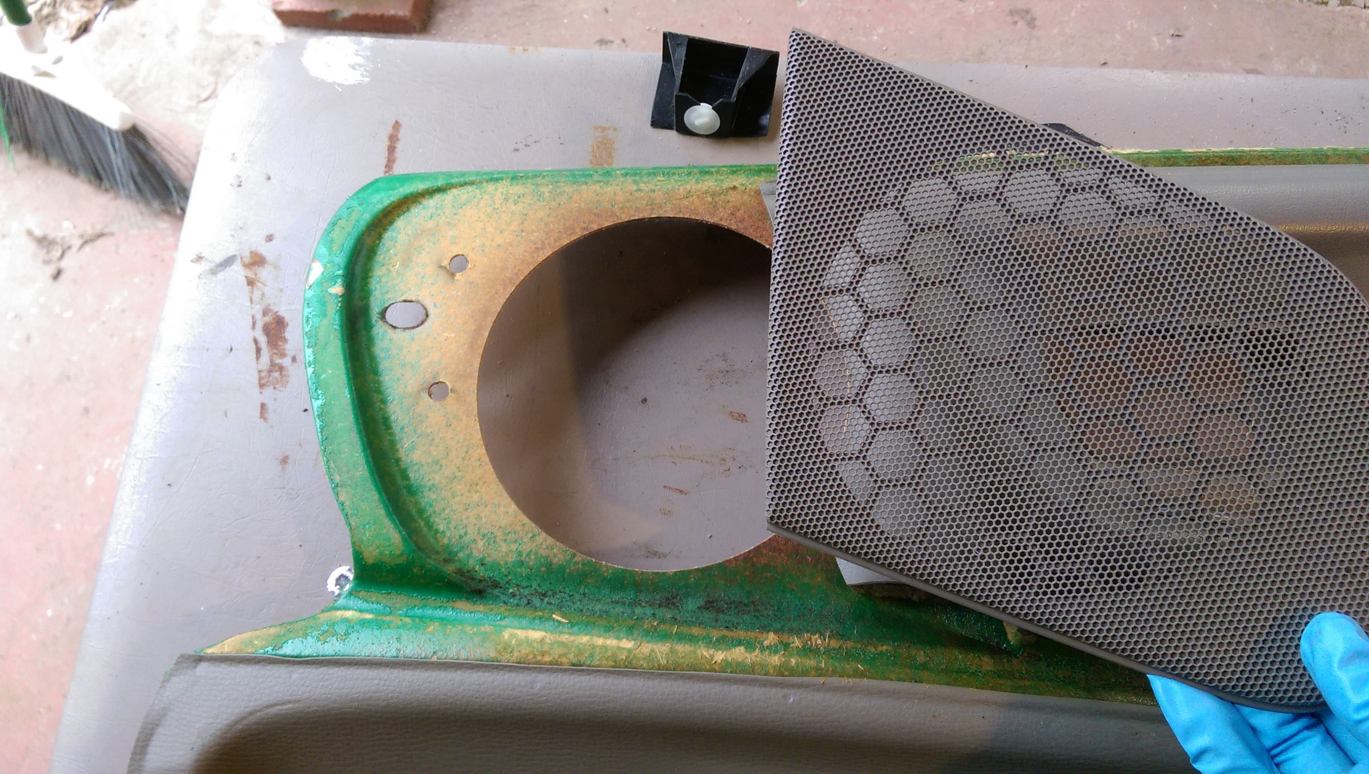

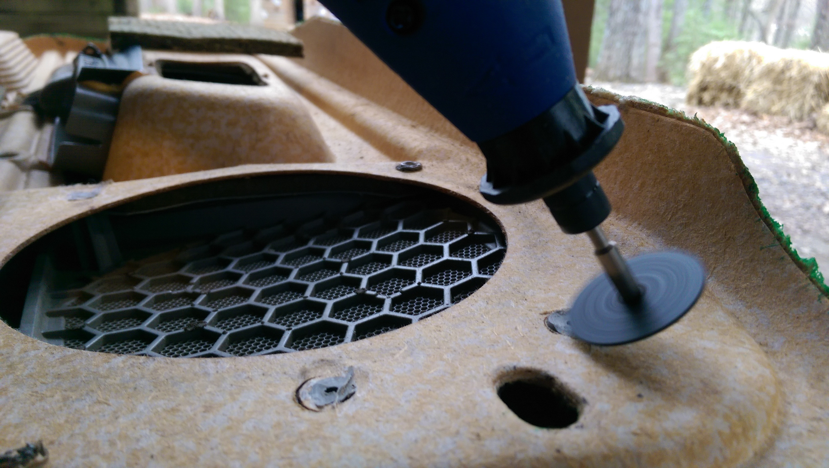

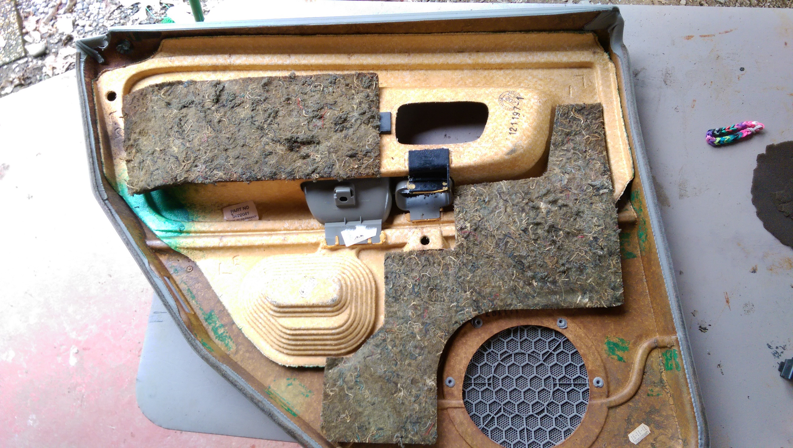

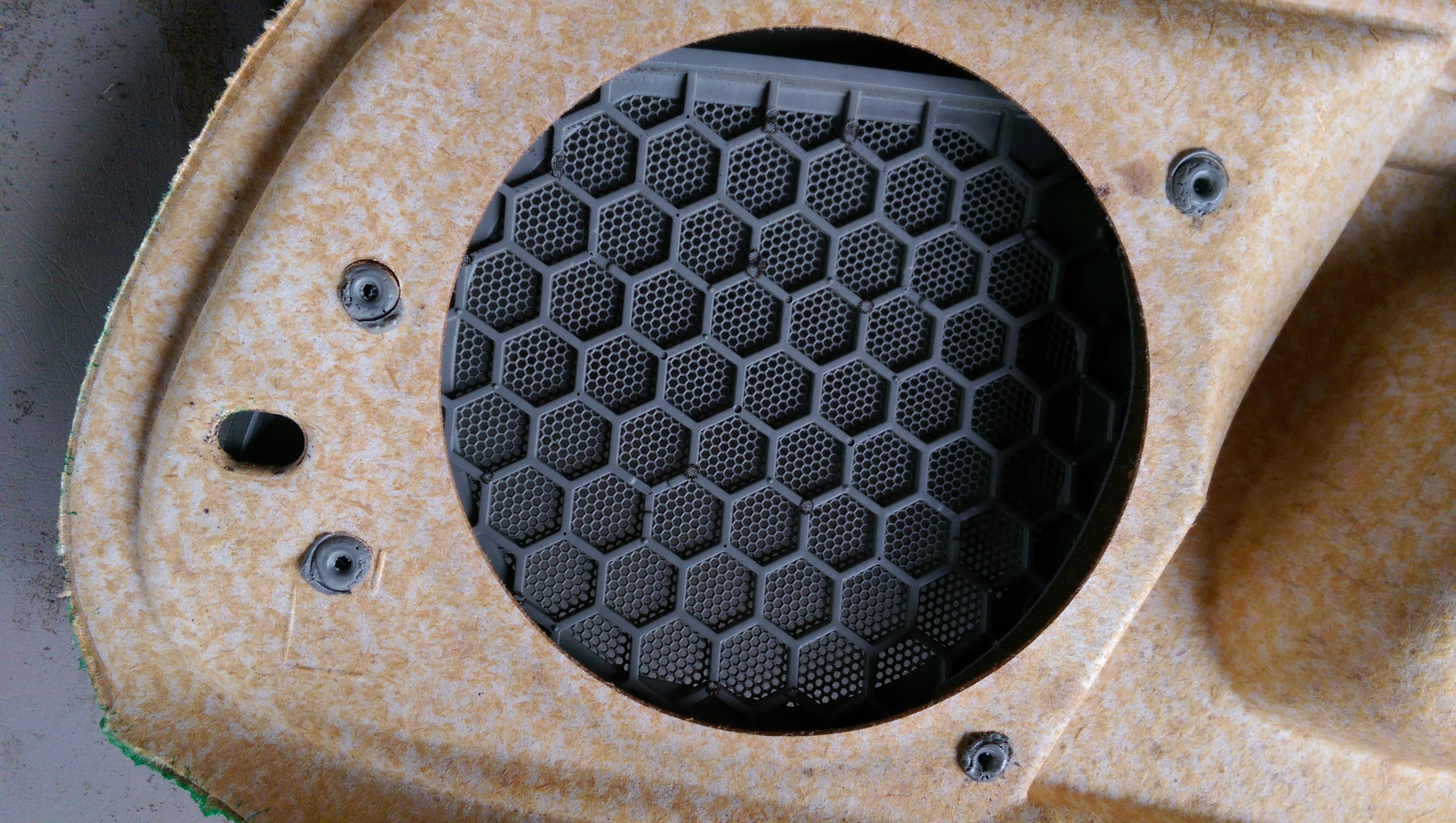

Here is the part you will be working on. You can see where much of the glue never fully made contact with the other half. Now to remove the speaker grill.

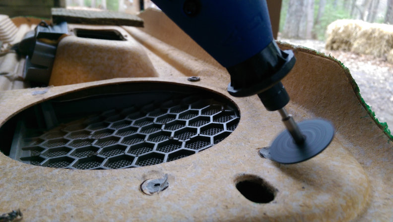

Using a dremel tool, cut the plastic welds. You will use screws later to reattach.

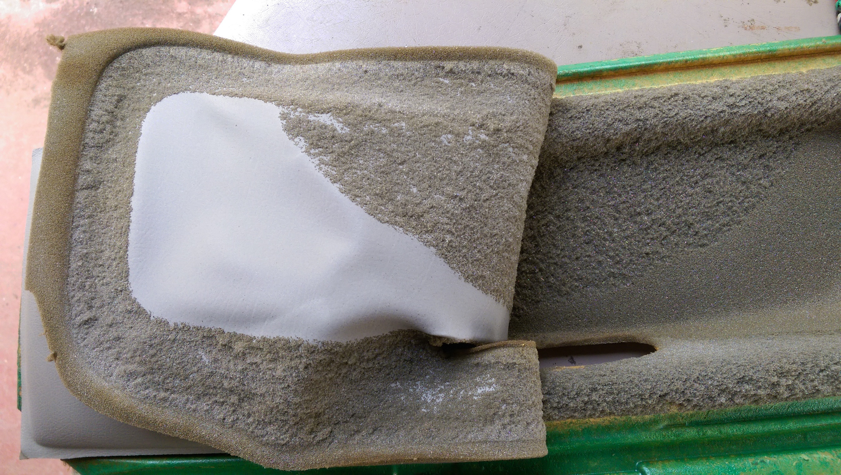

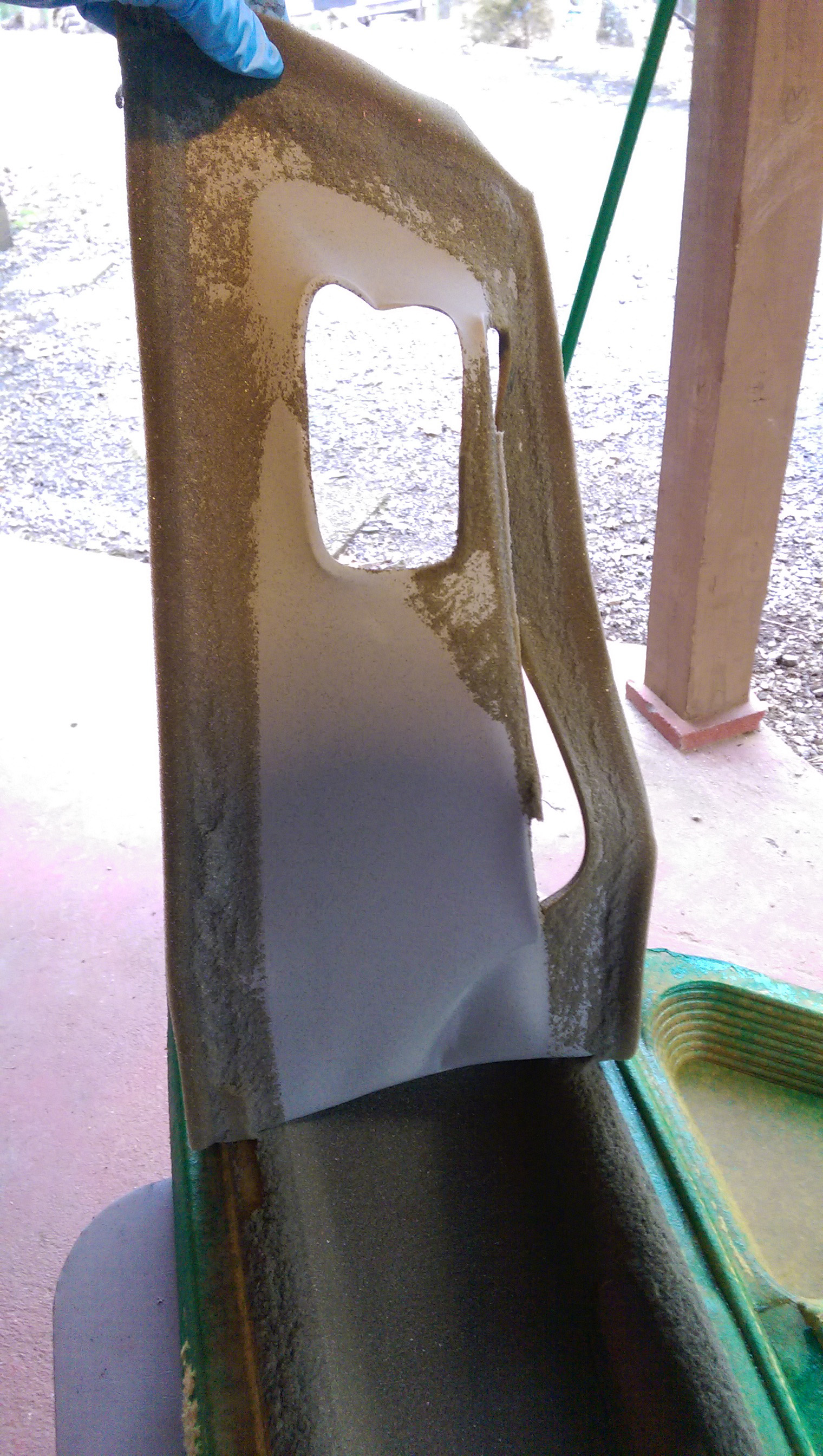

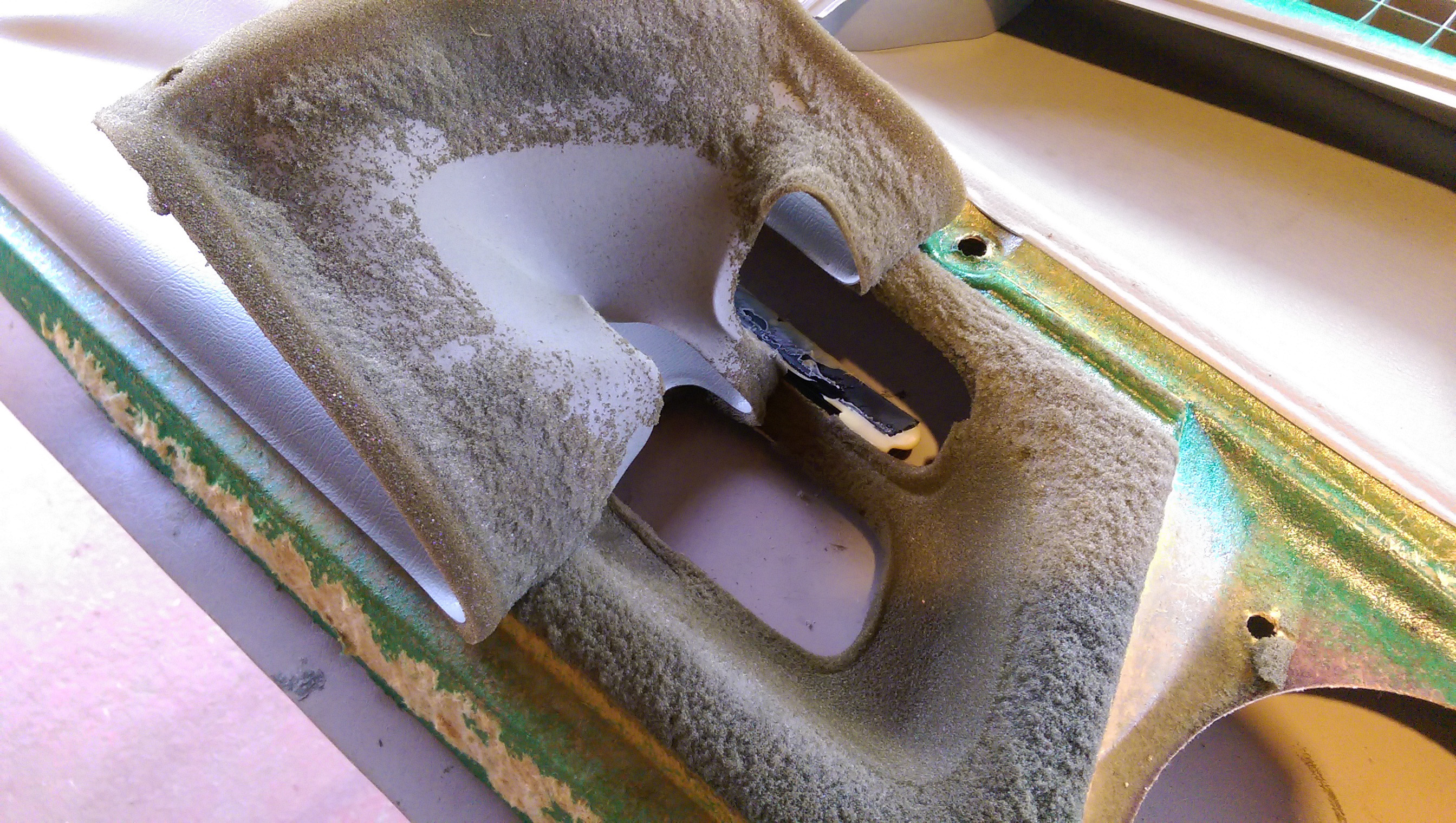

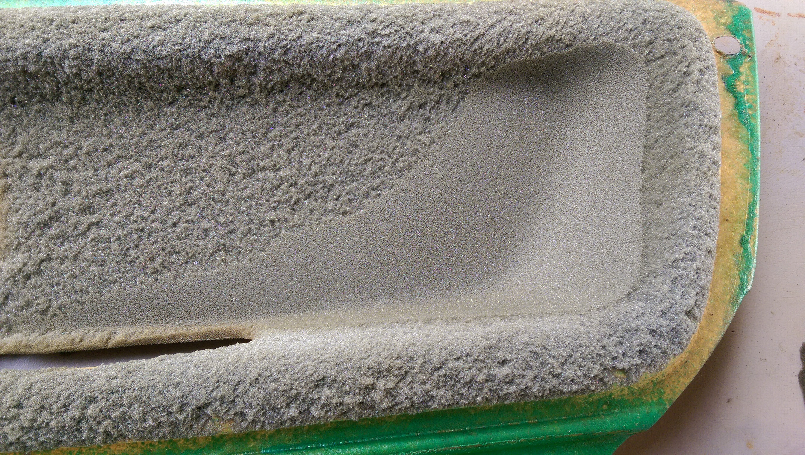

The next few photos show why these doors look so bad now. The manufacturing process failed to completely adhere the vinyl to the foam in a few places and when the vinyl began to shrink from heat and age, it pulled away from the contours of the panel and the foam glued to the fiberboard.
