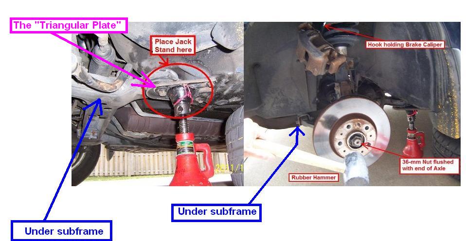

Safe places for jacking:
- Factory center jack under front door: this will lift both wheels on the same side in the air.
- The "Triangular Plate" where subframe is attached to the car.
- Under the subframe itself.
1. When I do brake job, rotor etc. and I don't get under the car:
* 1 jackstand under subframe and the floor jack right under the "Triangular Plate" (just nudge it up tight and one stroke to engage it).
2. When I need to get under the car:
a. Routine oil changes: I use wood ramps, drive the car up, change the oil, drive the car down. Photos already in forum, you can search for them.
I feel very safe when the front wheels sit on wood ramps!
b. Axle work etc. I do same as erikv11: 2 jackstands.
- However when I work on one side, let say LF axle: I place both jackstands on the LEFT side of the subframe to be safe (what if you place a jackstand on the R and the other one on the L, and one jackstand fails, it is rare but it has happened before!!!).
- I use 1 regular jackstand (with 4 legs, not shown in photo) and the screw-type jackstand seen in the photo below.
- There is a problem when one uses two (2) 4-leg jackstands on the same side: once the 4-leg jackstand is used, it is difficult to use another 4-leg jackstand on the same side of the car, simply b/c the 4-leg jackstand goes by click-click-click increments and nothing in between.
- The beauty of the screw-type jackstand is that: I can easily place it under the subframe as a 2nd jackstand, turn the screw up until it is tight, then turn another 360 degrees or so. Now the load is shared between 2 jackstands (a 4-leg jackstand and a screw-type jackstand).
A few more points:
1.Whatever you do, chock the diagonal tire on both the fore and aft part of the tires using bricks or wheel chocks.
If you do brake work on LF wheel ---> chock RR wheel.
2. Flat surface is crucial. Avoid doing work on a slope!
3. Quality of surface is also crucial. Concrete is best. Asphalt on a hot day in July-August: the jackstand can sink into the asphalt!
So place a thick piece of plywood (about 3/4-inch thick). Avoid gravel driveway, if you must do work, then again, use thick plywood.
4. Avoid working alone, always tell someone where you are just in case. Have a cell phone nearby too.

The center factory jack point will lift the entire side of the car.
To avoid damaging the lifting bracket, I slip a hockey puck between
the jack and the car. It not only spreads the weight and prevents
damage to the jacking point, it also provides a better "grip".
Once it's in the air, the triangular plate referenced above is a solid
point for a jack stand. I also buffer this with a hockey puck.
As far as only supporting a single point to work? I've never done that.
I always support at least two corners at the front or back before I start
wrenching to keep things symmetrical. Just seems more stable to me.
