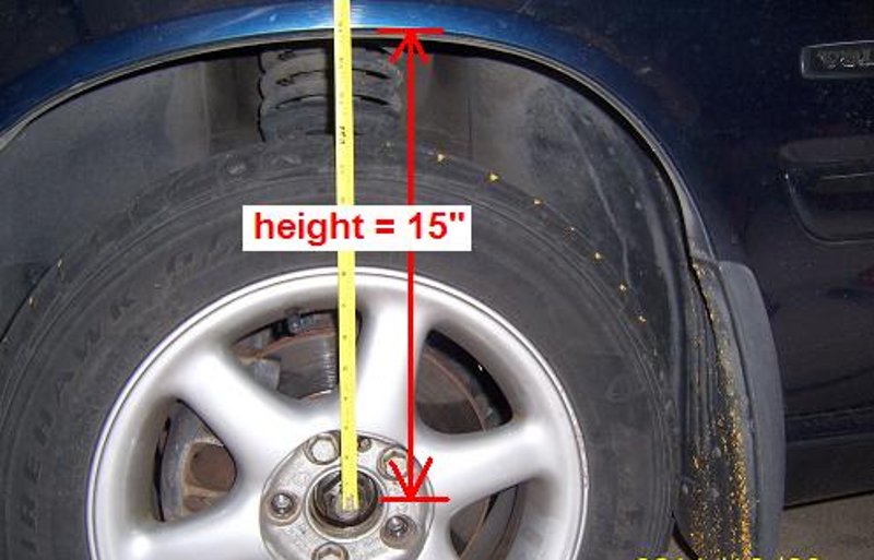

2. The other "proper" way is to measure things before the job.
In most stock P80 cars, the distance from fender to center of axle is about 15 inches.
So when you tighten the control arm bolts, just follow this...
PS: You simply cannot "overdo" this, once you jack it up to about 15", no matter what you do the car will keep going up in the air!
In other words, you cannot get it to 13" or 12".
