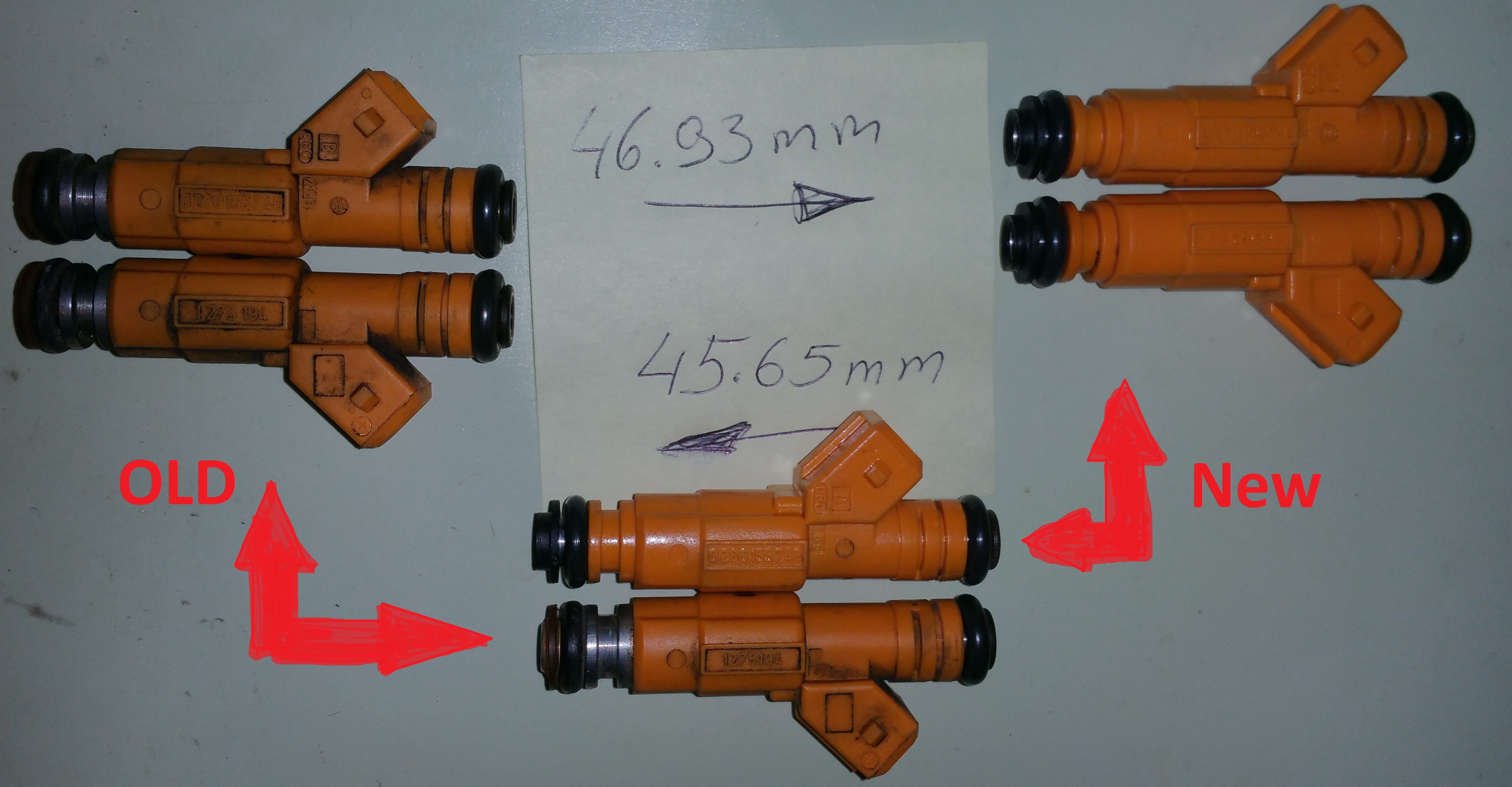

I recently purchased re manufactured Fuel Injectors for my Volvo S70 1998. I paid $90 for 6 of them on eBay. I decided to buy them re manufactured instead of servicing/cleaning my old ones ($20 per injector for total of 5 would cost me $100) because it was cheaper and I also was guaranteed that new re manufactured injectors were tested and working perfectly. My old injectors were factory originals with 80k miles on them. There was nothing wrong with any of them. However I decided to do them because I was replacing PCV system along with all other things (Clean throttle, intake manifold, replace thermostat, etc.) that I could get to while my intake manifold was taken off. Anyways, when new injectors came in I noticed that nozzle end had different O-ring retainer. You can see the difference in the photos. All injectors have same codes (0280155746). Difference between total length of injector between old and new ones is barely 1.8 mm (0.0708661 in) which is less than 1/5 of a cm (1 in = 2.54 cm).I also inserted rubber fuel injector spacers in fuel rail which are called for but were not included with the old set up (they are about 2 mm thick and go between fuel rail and top of injector). Does anyone know if I can use new injectors without any adjustments or do I have to replace the o-ring retainer to match the old ones? Any advice greatly appreciated.

- This is what my re manufactured fuel injectors look like (look at the injector nozzle and o-ring retainer)
- Finjector nr1.jpg (75.68 KiB) Viewed 5787 times
- This is what my old fuel injectors look like (look at the injector nozzle and o-ring retainer)
- fuel injector nr2.jpg (57.67 KiB) Viewed 5787 times

What matters is that the o-ring seals well and the position of the nozzle in the chamber, i.e. that the o-ring to nozzle distance is approximately the same. Total length is of no consequence as long as the injector and rail will fit in the engine bay (and a few mm is not an issue). Should be fine.

They fit perfectly fine into fuel rail and into manifold. However, I'm getting a sense that I should be smarter to just return them...Thank you for the help.erikv11 wrote:What matters is that the o-ring seals well and the position of the nozzle in the chamber, i.e. that the o-ring to nozzle distance is approximately the same. Total length is of no consequence as long as the injector and rail will fit in the engine bay (and a few mm is not an issue). Should be fine.
