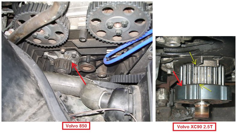

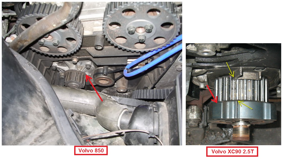

I took some random photos from Volvo 850 and Volvo XC90 2.5T engines to show the concept of "Axial" movement, i.e., movement along the axis of rotation.
- The WP has a "inner flange" that prevents the TB from "walking inward", touching the engine.
- The Crank Pulley (harmonic balancer removed for better visibility) has an "outer flange" to prevent the TB from "walking outward".
Within this "confine", the TB can only move so much from side to side.
So, let's say the TB width is 24mm, and the "confine" is 24.5mm, then the TB can walk 0.5mm from side to side.
Probably within spec (I may be wrong though).
Of course, there are other factors too:
- Any play in WP bearing?
- Are Cam sprockets "straight" (no wobble)?
- Any play in mechanical tensioner pulley?
- Any play in Idler Pulley?
- The Crank Pulley: is it straight and true?
- Is the TB nice and straight from factory? BTW, Gates TB is kn own to walk from side to side, simply b/c Gates TB is not as straight as Conti.
Just some of my thought process. Anyway, the photo to show the "confine", see RED arrows...
