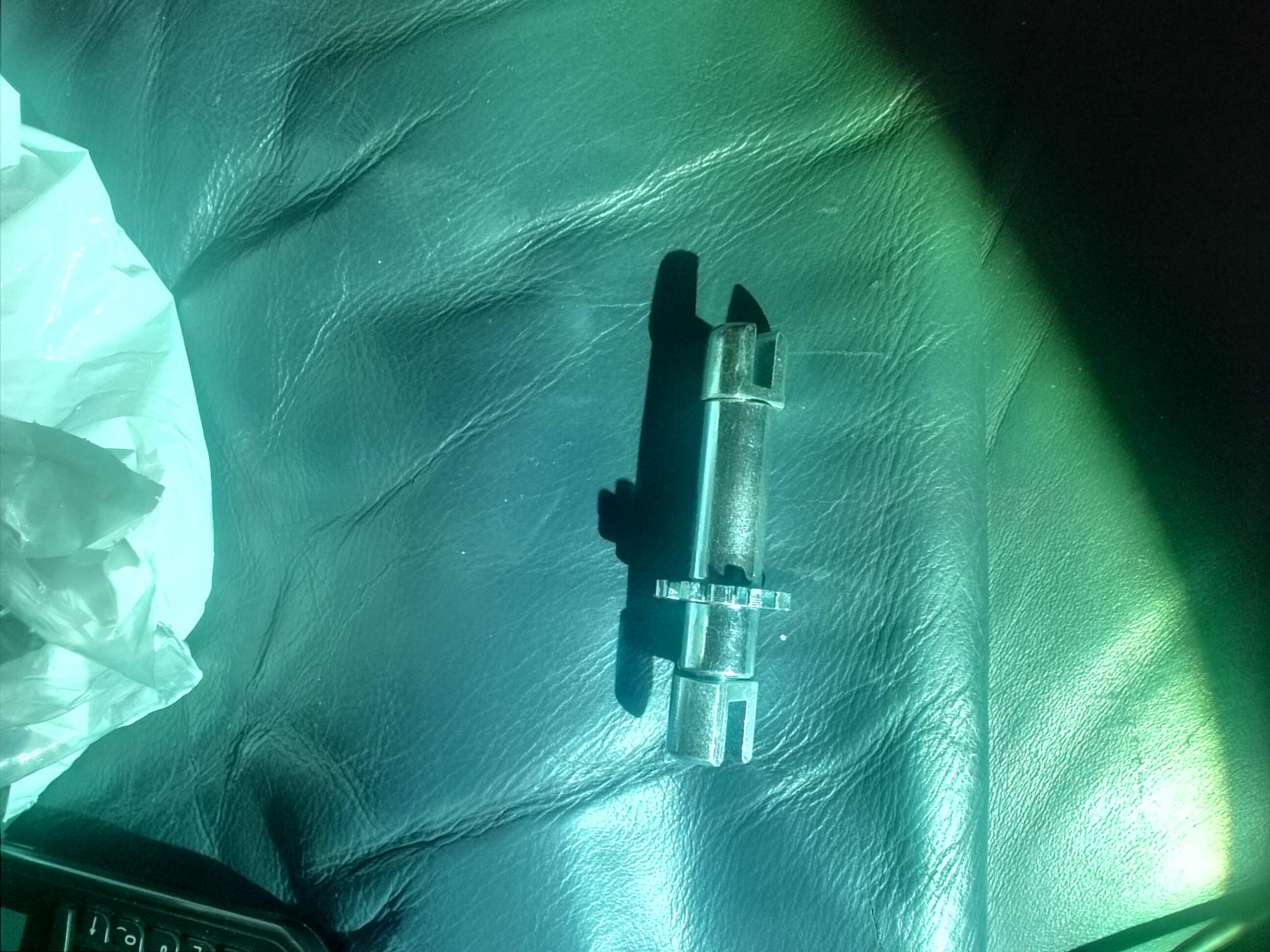

Ou2mame
Posts: 142
Joined: 08 Apr 2015, 10:42
Year and Model: 2004 xc90
Location: Long island, ny
Post by Ou2mame »
I installed adjusters to make it easier to adjust them because the one in the center console just doesn't work right.
