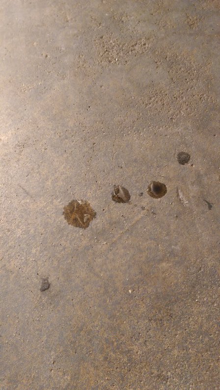

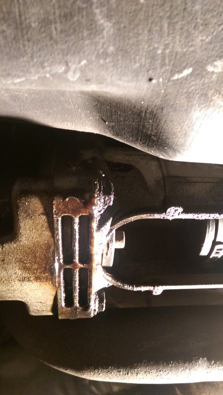

I noticed what smells like gear oil on my garage floor today. Jacked it up and found the leak area. It was dripping as I had the car up.
For the last couple bad weather days to me I felt like my awd wasn't working.
I did the VC test for the torque on the front wheel per Volvo and it easily had more than 50nm resistance.
What is the likely source of this leak? Anything else I should check on the awd function? It only feels like fwd as the front wheels keep spinning and nothing seems to lock up. New Colorado shaft last year no noises other than rarely on hard stops I could possibly hear a clunk in the rear after stopping.
One photo is the leak area the other is how Mich has dropped in 10 mins. I replaced all driveline fluids in the summer so I know they were topped off.

The VC doesn't have gear oil in it. It has a silicon solution. If you look up into the opening under the VC unit (as seen in your photo) there is no fluid at that end of the VC unit. What it looks like is you have a leak at the front seal of the rear differential possibly. To access that you need to remove the VC unit. But to be blunt, I would take this to a specialist as there is a pre-load requirement once the seal is replaced.

Thanks. After more searching it seems like it is likely the pinion seal.

Agreed, looks to to be the diff pinion seal leaking.
Here is the procedure from vida.

Everything needs to be marked and put back where found. The VC to the diff flange and the flange to the pinion.
