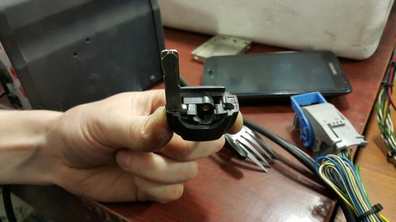

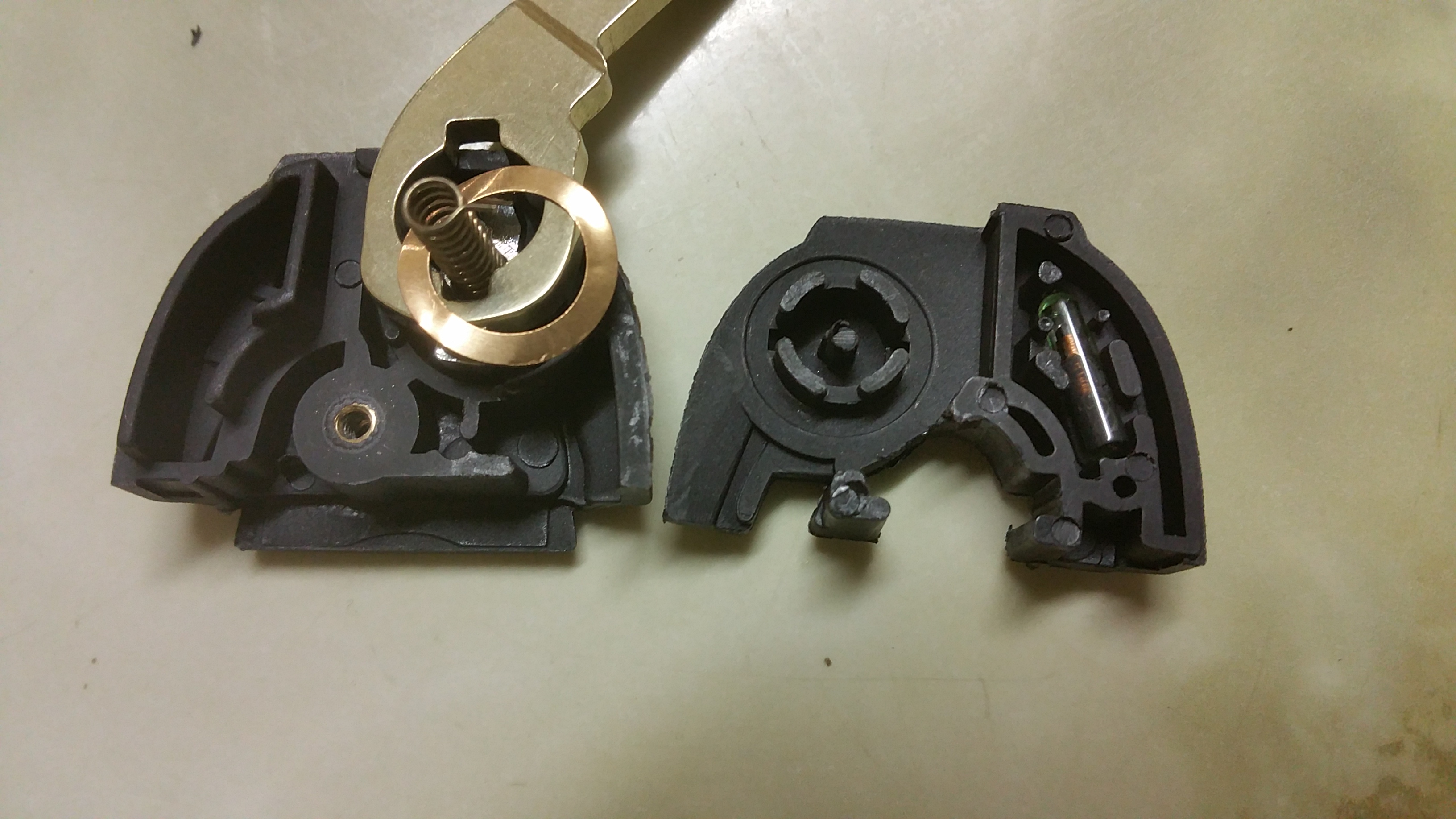

The ID48 megamos transponder is embedded just next to the keyhead and is responsible for immobilser function and can be removed only by cracking open the case and therefore breaking the keyhead. Careful drilling can be done to remove the transponder however it is a delicate operation.
Photo above shows a new keyhead which must be glued together while tensioning the key return spring (easier said than done)
Doublebug can program a new transponder with keyhead (look on Ali Express seller ECU-Sells.com) on post 2005 cars using your Dice and his software. He did this for me on a customer's 2006 XC70 just before Christmas. We introduced 2 new transponders so we supplied 2 new keyheads however we used the old keyblades. It took about 25 minutes to program.

Hi Neil. Thanks and best wishes to yours. The transponder is the tiny glass chip in the photto above. You can see it as a small capsule-like shape in the right keyhead half. This is the only thing that requires programming; not the board which has the onboard battery.
When we programmed the customer's 2006 XC70 afew weeks ago which like yours had that Starting Prevented message, all we had to do was place new transponder codes on the CEM and place new keyheads near the antenna ring while Henry logged in to do his magic. The remotes could have been in China and we would still have been able to program the keyheads. So dealer has no basis in saying this or perhaps your terminology of the components is a little fuzzy.
It was a very simple exercise. I simply taped the glass transponder capsule to the customer's old keyhead and inserted into ignition. The old transponder chips had to be physically removed to avoid interference. The new keyheads arrived the following week.

Best to order the keyhead even if you don't want to cut a new key due to difficulty in not damaging the casing when removing the old transponder.
Photo shows drill point for old transponder removal
The later CEMs (post 2004) can be hacked and programmed with no more than a Dice and internet connection.
