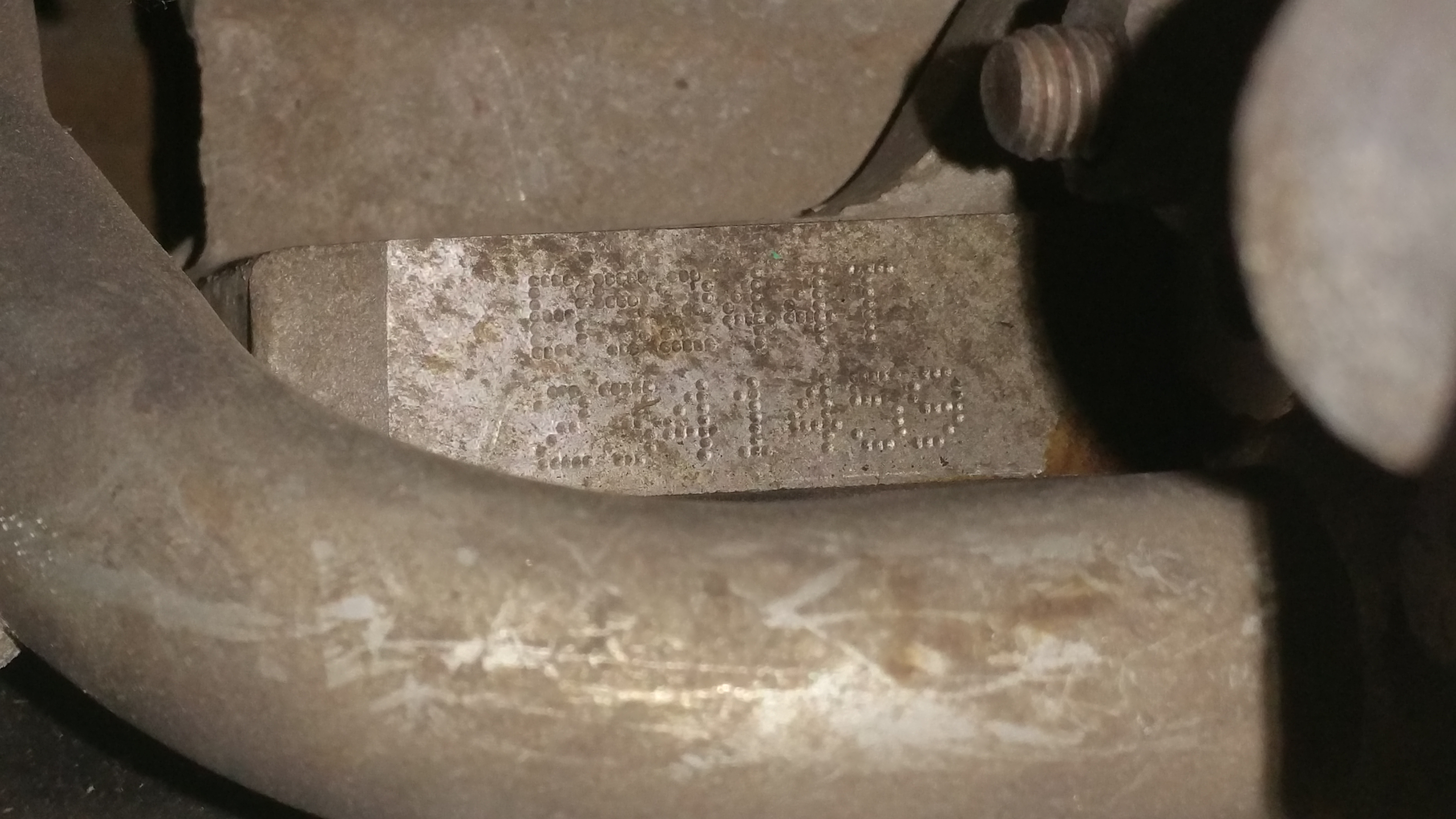

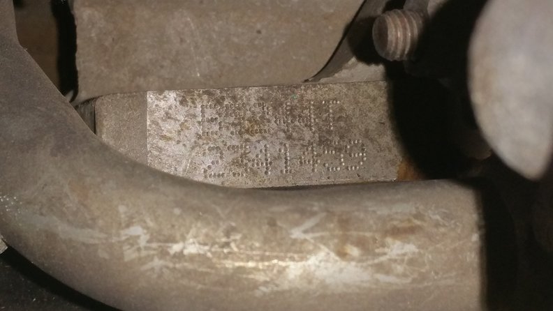

If you require a definite engine number for insurance or registration purposes it's located on the engine block next to cylinder 1 exhaust port facing up. A smartphone with a good lens will pick up the number. First row says B5244T second row says 2341459 Example is provided below:
