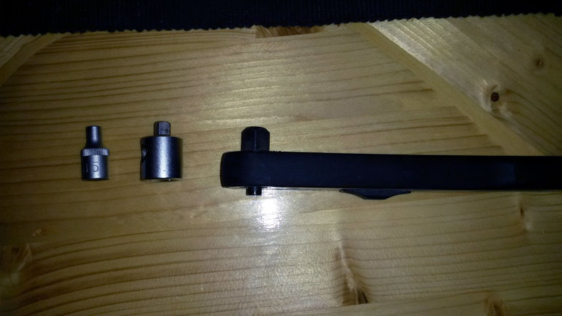

I was lucky that one of my socket wrench sets had all the E type sockets in it, so I didn't have to buy the E5 for the removal of the module, plus it's a slim one. The socket I have is a 1/4" and I put it on a 1/4" to ½" converter.
This worked really well and I only had to remove the aluminum hose from the exhaust to the air filter box to get enough space to remove and reinstall the module. No bent fingers or scraped knuckles :)
