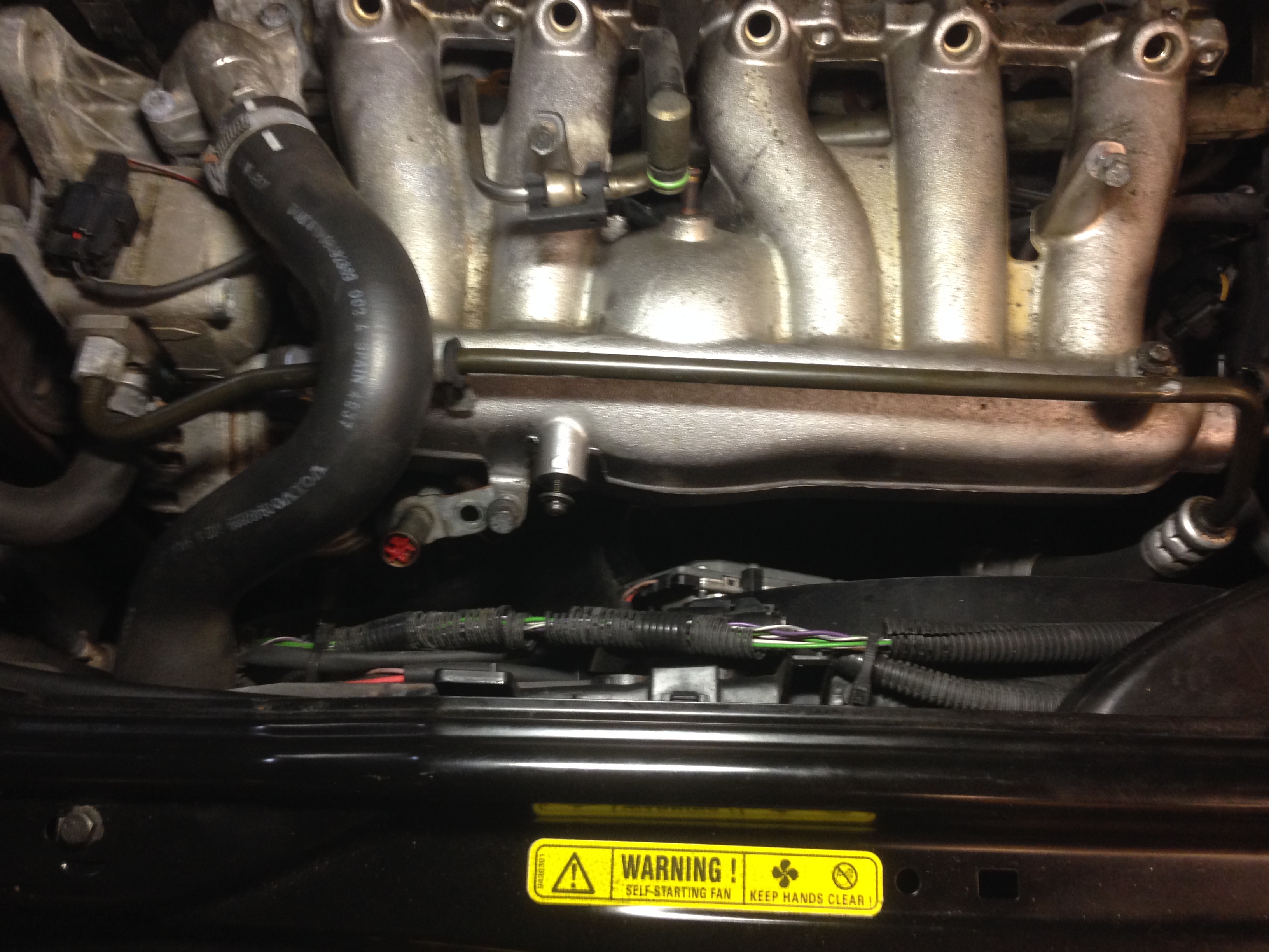

I appreciate the help so far y'all. Yeah that 7mm pipe clamp was an absolute b**** to get to... Had to take it off after most everything else was loose because it was situated with the screw pointing towards the engine block! Thankfully it was loose enough that yanking on it in slight desperation caused it to rotate and I reached in from the right side of the IM, up underneath with a socket.
The dipstick bolt on top is one of the first things I took off. It's still in the way, and the handle broke off in my dealings with other components. Earlier versions of this vehicle supposedly have a lower bolt on the dipstick tube? Cannot find it on this one. Do I just yank it out to release the seal where it connects?
I was hoping to not have to take the coolant hose to the thermostat... Crap
As far as the lower IM bolts, yeah, they're out already. It won't come out by just sliding it up, as I said. Now I did get quite irate at the 8 mile long, fine threaded bolts
. Is this so you can really back them out... I mean really. Cause I can see possibly rocking the IM back (with EVERY other obstruction in the front side removed, which obviously I hadn't figured out so far) and it possibly clearing the top side of the block that overhangs it. Oh well, I do know that putting them in first is the way to go, but only if I can lean it towards me enough to get it back in that way.
As far as the insulated line underneath, that goes to the back of the compartment ( what is this specifically?) , it is connected without a clamp and I don't foresee getting this of in a friendly manner, since its preventing me from getting the IM off, which it seems needs to be done in order to get the hose off :/ ... It must be the "don't break this really expensive, delicate connection, catch22 pipe..

Aren't we all forgetting something?
Under the intake manifold is a 17mm banjo bolt close to the thermostat. Feel under there; it faces up and totally prevents removal of the intake manifold.
When releasing the bolt get ready to catch the upper and lower copper washers as they fall to the ground.
The union that the banjo bolt tightens is the one that carries coolant.
Trust me there is almost no way to get that manifold back on withoit bending/damaging the fuel line unless you remove that black safety catch and use a fuel line release tool. The shape of the fuel line prevents it going back on.

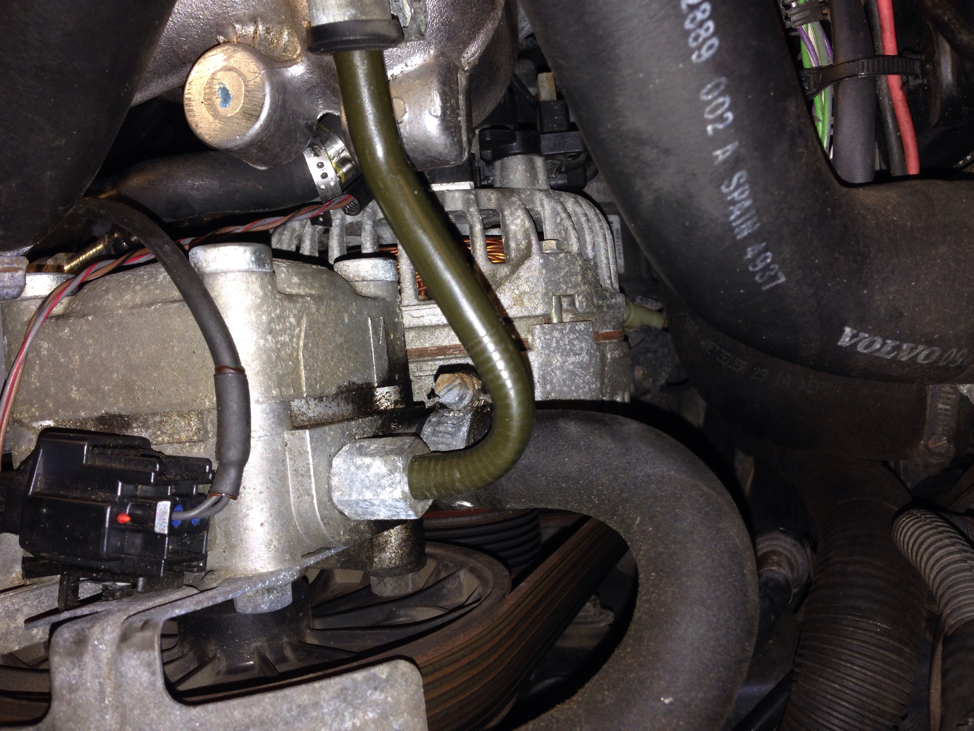

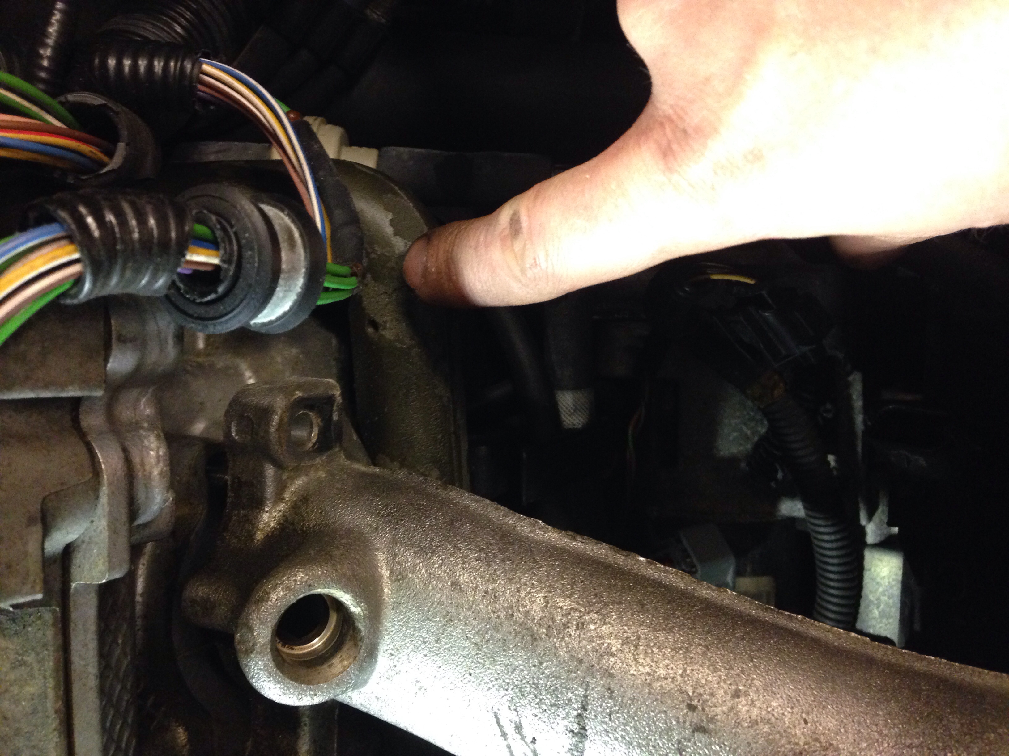

So these two things are keeping me from getting the intake manifold off. The first being what it looks like a power steering hose, since it's connected to the power steering fluid reservoir. The second being that insulated line connected to the IM and running underneath of it.
Will fluid come out that I need to guard the alternator from? Or does the pump have to be running for fluid to come out?
This attaches to the bottom of the IM . Any tips?

Power steering hoses dont interfere unless someone has put in none stock.

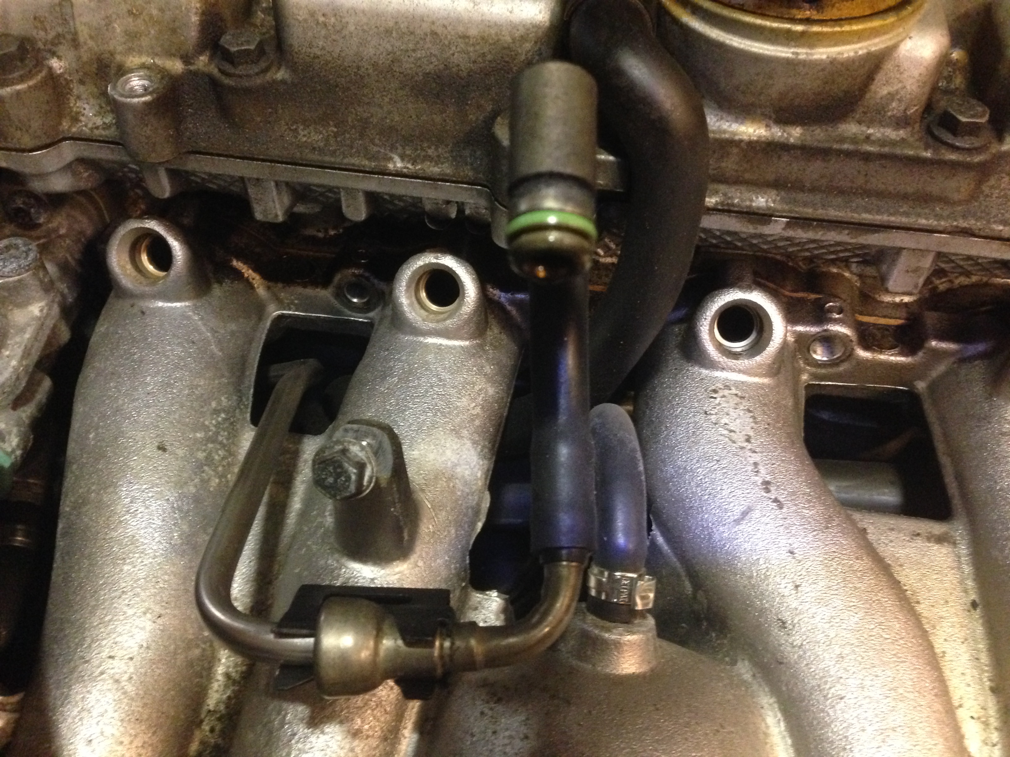

The PCV attaches to the IM at the banjo holt Mike talks about up thread.
Picture of the PCV foam pipe showing the banjo bolt...that's the only place they connect
Ps...get some paper into those fuel injector holes before you drop something in them and really mess up your day.

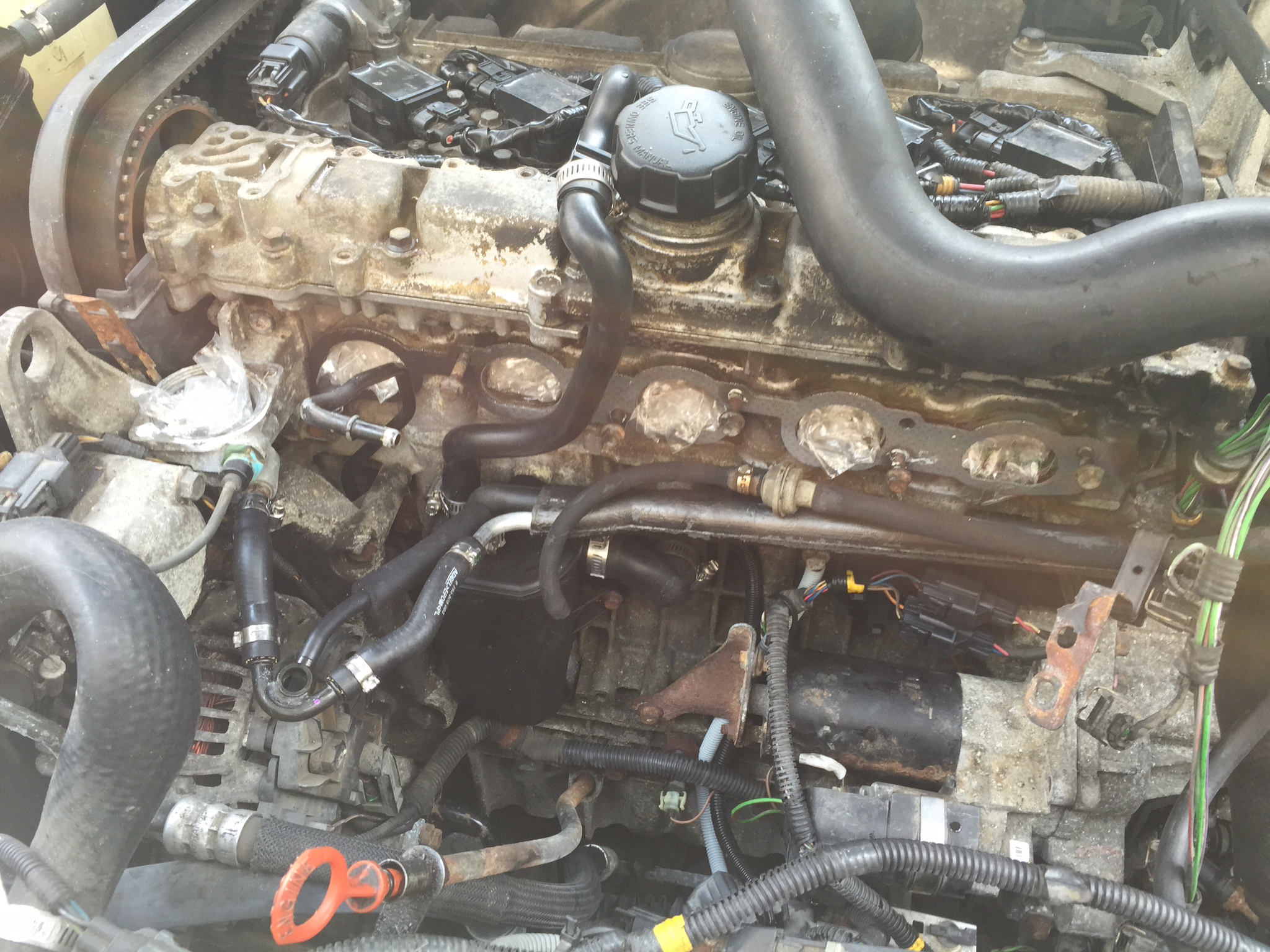

Drain the radiator (be careful not to crack the petcock... or buy a replacement before you start the job). Flooding alternator with coolant will automatically mean you'll have bearings and/or diodes shot in no time.
Drain the block as well, or coolant will flood everything when you remove second banjo bolt from the block on driver's side. Petcock is located on passenger side on the back. Make sure you don't flood CV axle's carriage bearing, which is located right under petcock.
One bolt of oil trap is hidden. I didn't want to remove half of compartment to get to it, so I just broke a piece of trap off. Maybe I did something wrong, but keep in mind.
I did PCV on a 2.5T engine first time in life in like 9 hours. Was frustrated a few times, but overall it's not that bad.
