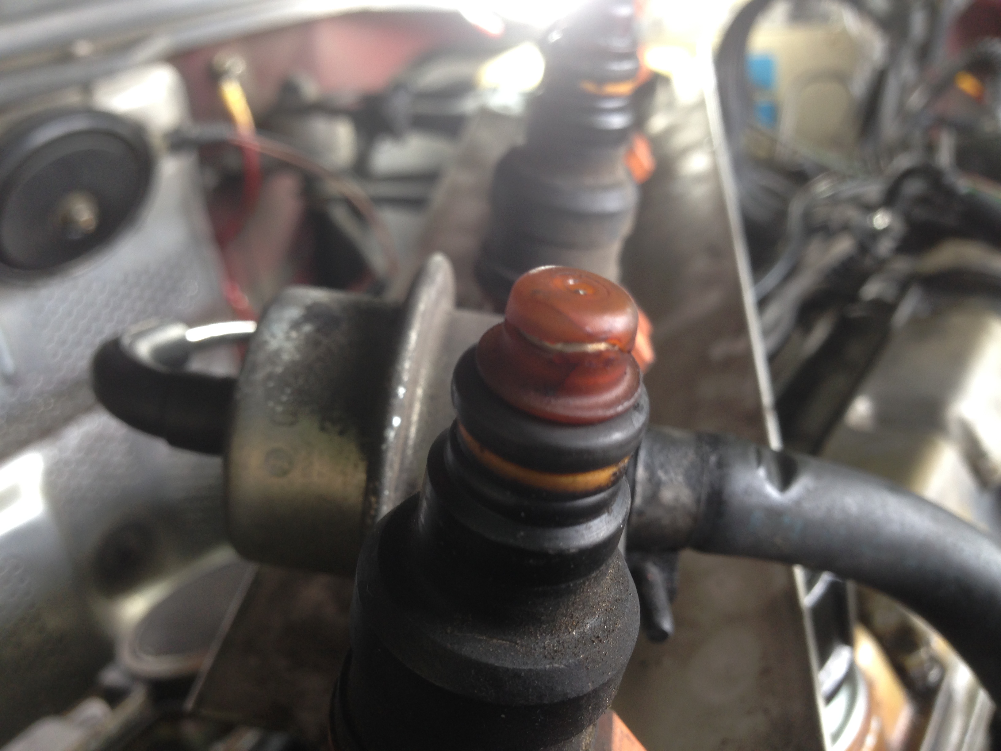

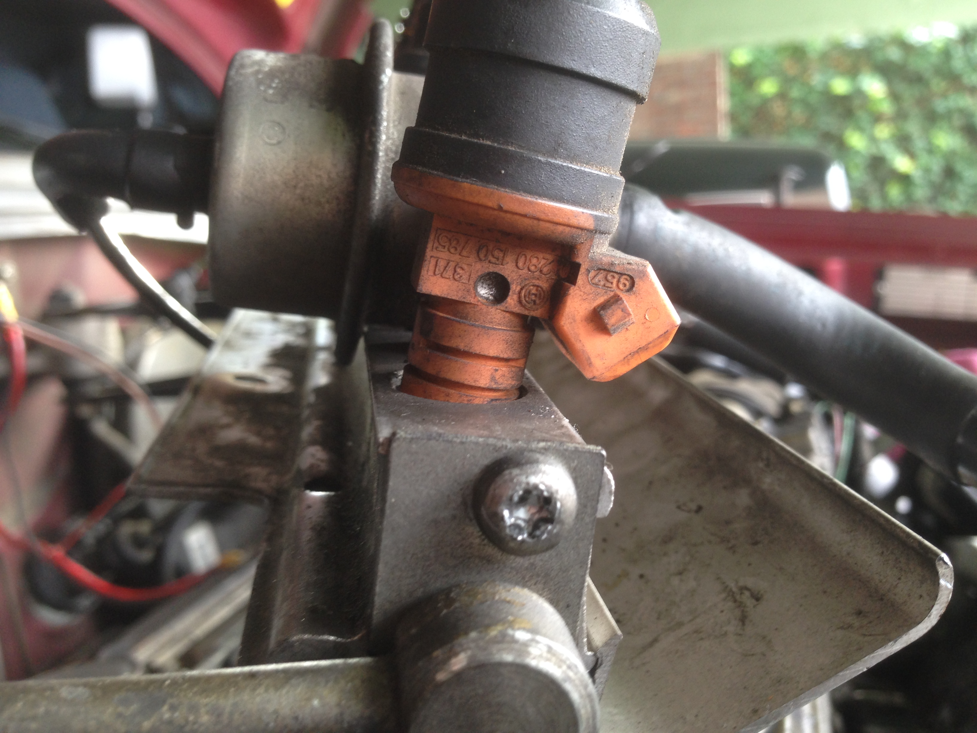

Hi, during my PCV service I checked the injectors and I could see that the plastic cap is broken. I want to replace them before I but them back in but I don't know where to search for them. Of course I could ask the dealer but the prices there are crazy

Replace that fuel hose attached to fpr from last picture,it's damaged.
Caps,i guess,could be found at places where injectors kits are selling.
You could try on junkyard too for whole rail with injectors.

Wow thanks guys! Didn't know that there are kits available to fix that. Great!

The blue caps look like the same ones that Beck Arnley packages. Those caps tend to fit on the Bosch injectors a bit strange and they actually take two "snaps" to get fully seated. At least they did when I put some on my daughter's Porsche.
They worked fine once I go them installed.
