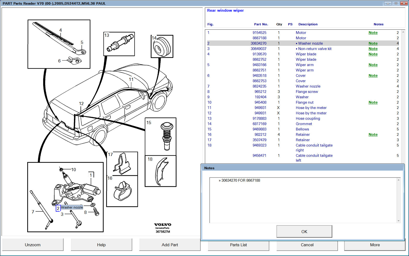

Apparently there is a connection valve inside the rear panelling as per the attached diagram but I cannot seem to pull the trim off.
