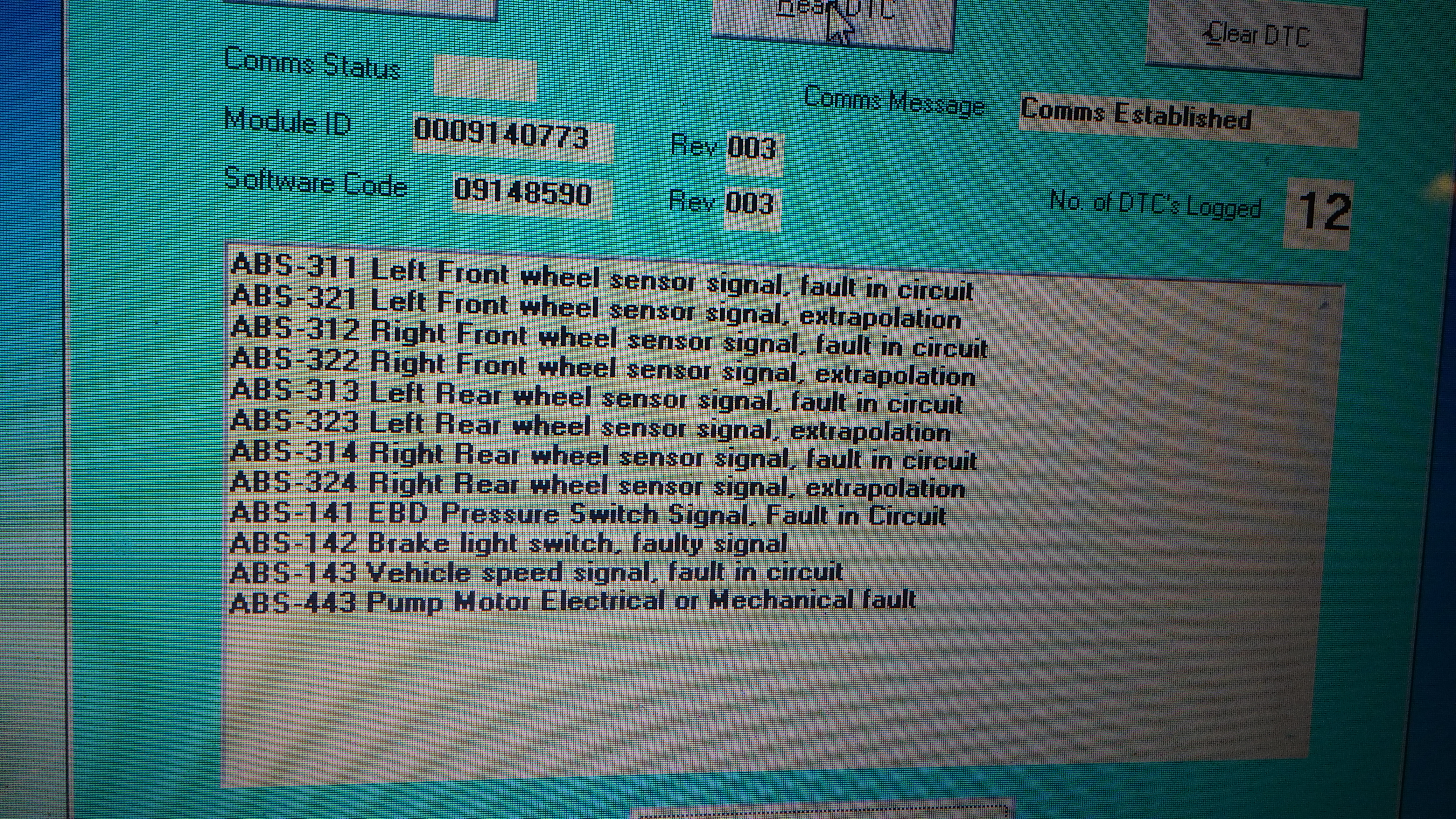

Abs-313 and 314 are both open circuit codes, they should have been preceded by extrapolation or faulty reading codes for each given sensor. That's provided you didn't previously erase the codes, then that would explain why you just have two circuit fault codes now.
Pump motor code is normal for a faulty module.
This is how codes normally populate with a faulty module, this particular one has been faulty for a long time.
