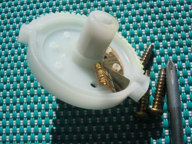

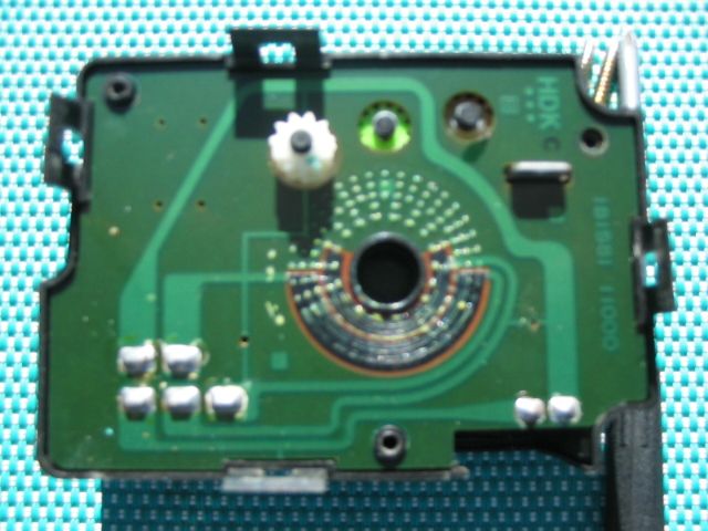

Reading up on this issue, I pulled the driver temp motor, made an index mark on the shaft & case, opened the case, marked both gears with an index mark, verified the motor still worked with a 9V battery, cleaned the carbon pads, checked for solder/trace cracks and verified continuity between the various five pins. Then regreased a few turning friction points and reassembled.

Very cool look inside the damper motor, I had not seen inside one if these before.

It's odd that the HOT & COLD is now reversed. Formerly, driver was HOT; pass COLD. Now it's reversed. Odd that....the drvr temp damper "flops" to COLD when the motor is removed. I stuck a screwdriver in there and easily moved it to the other limit, which I guess is HOT. I also made sure to index the motor, which is seen in the photo, and it's about in the center of travel.
