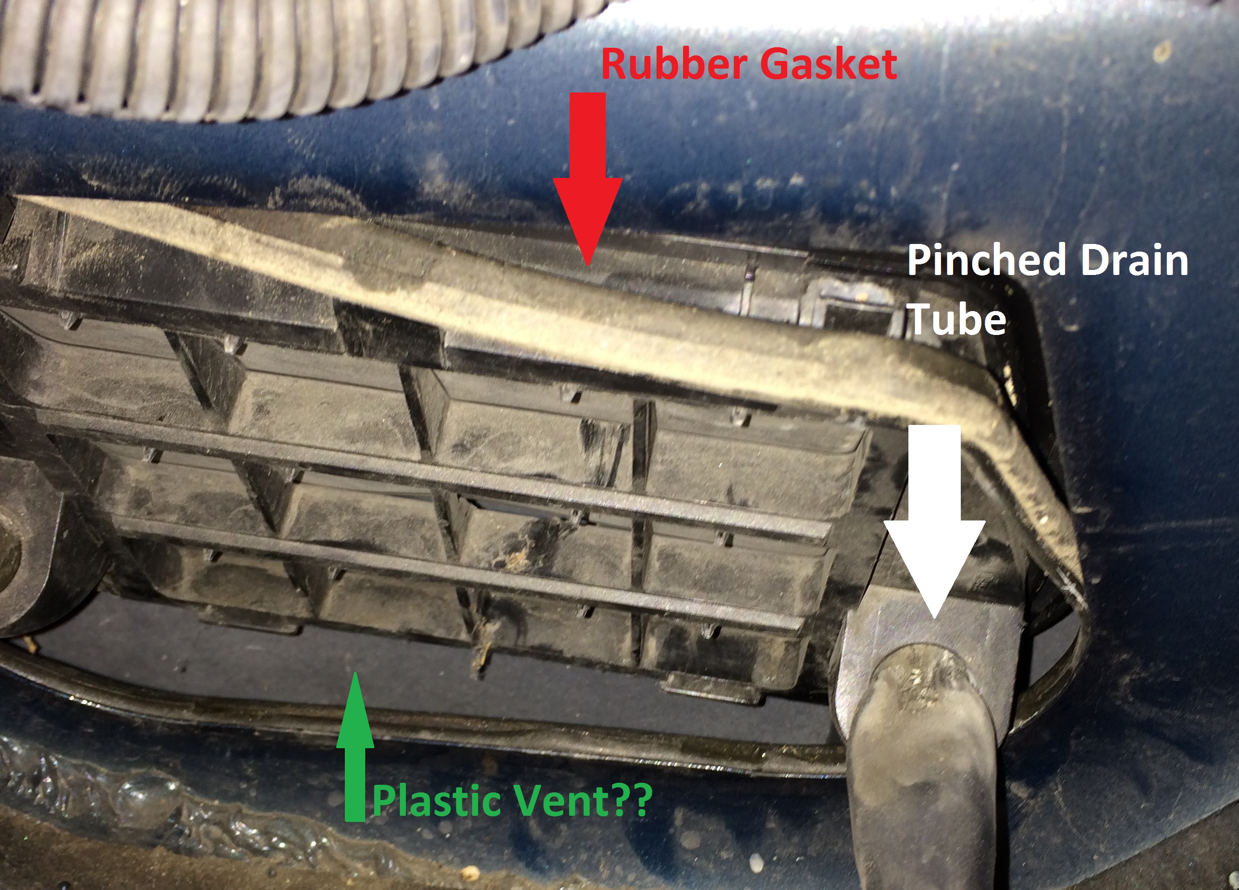

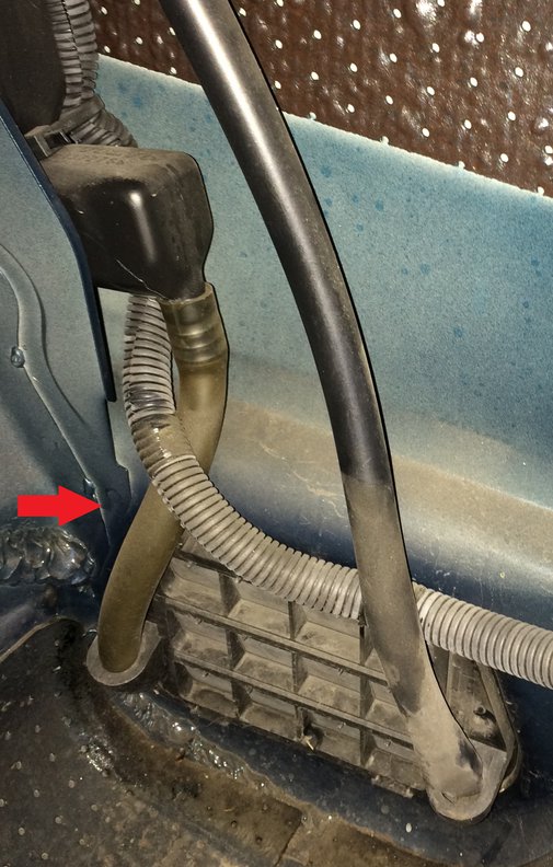

Thanks...I was working on the right trunk drainage tube and I've run into some questions, AND unfortunately I believe I'm stuck as well. as I'm not sure how to put it back together. I have put in 4 labeled pictures that I HOPE will remain on the server.
I would appreciate any input on this as this is something I have not done before, and seems simple, yet complex in other ways.
Picture 1-Before the Trunk Drainage Tube was removed.
1. What is the green arrow pointing to? It's a tube that goes up behind the interior cabin's wall and car frame
2. What is the purple arrow pointing to? Seems to be a plastic vent
3. What is white arrow pointing to?
4. The sky blue arrow is pointing to the trunk drainage tube, you can see it is pinched when it connects to the black vent. Is this typical ?? I suspect this is why it's clogged. Pic 2 What is the Tube and that Black box it's inline with the Arrow is Pointing to?? I have disconnected from the black vent at the bottom. This is a better view of the tube from Pic 1's green arrow Pic 3. When I attempted to remove the black drainage tube (white arrow), I thought I would need to remove the vent. The vent is held into the frame via some tight fitting plastic tabs that are part of the vent's mold itself. Around the vent was a rubber gasket which was wet.

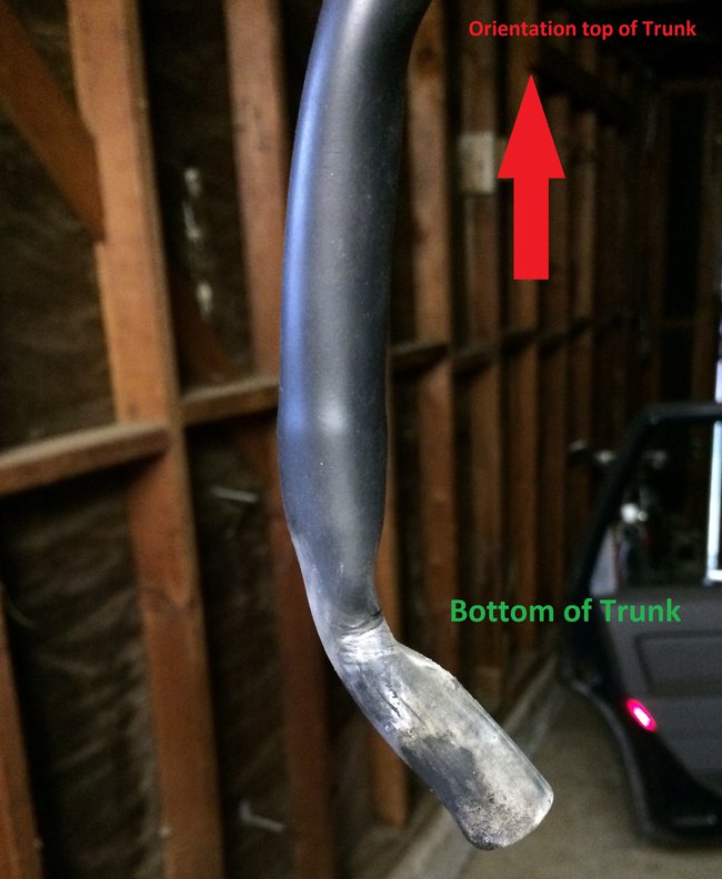

My Picture 3 questions are the following
1. How do I remove the plastic vent and pull it into the trunk, is that even possible, it seems not to fit. The location of the vent is right behind the car's rear bumper.
2. How do I put the gasket around the vent and put the vent back into place WITHOUT dislodging the gasket off the vent. It seems near impossible to me.
3. Is the gasket needed?
4. After I flush out the Drain Tube is there more to flush out that would be "below" the drain tube that I cannot see??
5. Am I better off getting a new drain tube, OR finding some clear tubing and using zip ties to hold the tubing in place?? I thought maybe clear tubing would be better than black tubing so I could see for the future.
6. Another view of the Pinched Drain Tube, that's how it looked when I removed the right side trunk panel.
I'm really at a loss at this point as to how to put this back together. I didn't expect to find a plastic vent, let alone a gasket. It SEEMS that these may be assembled into the car with the bumper removed, but I don't know.

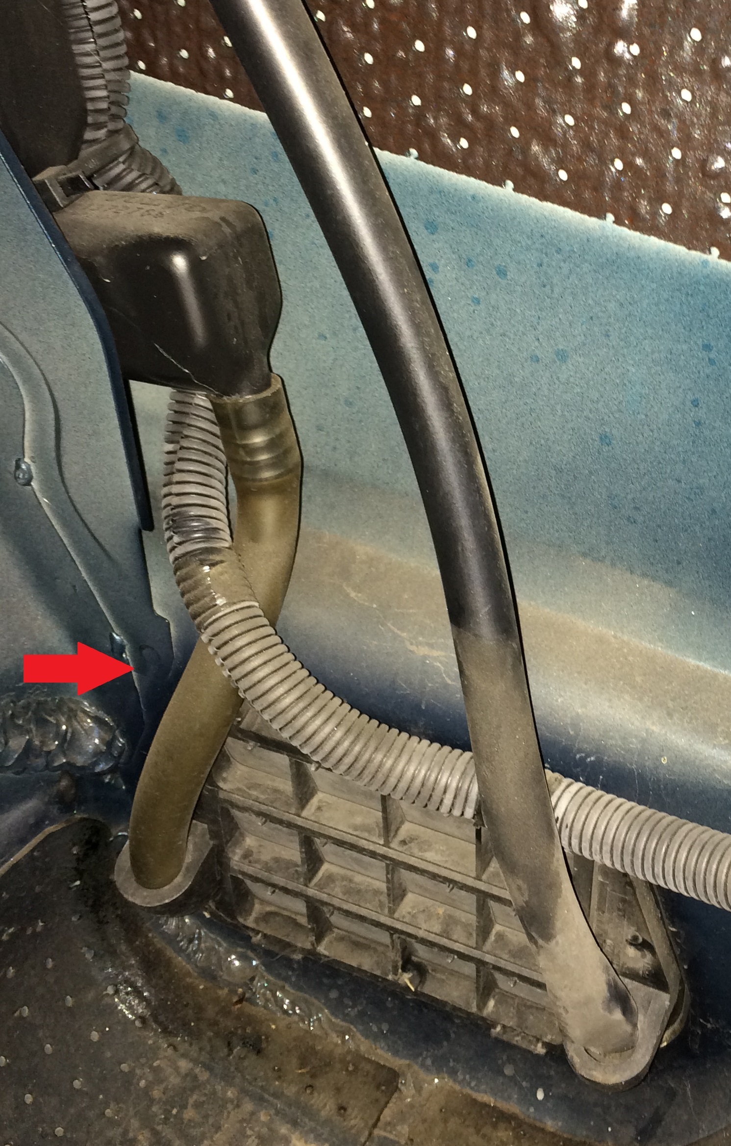

Pic 4 What the Drain Tube looks like in correct orientation but not attached to car

Do you have a sunroof on your car? If so, then that is what the green arrow is in the first picture.
The vent is what I call an equalisation vent. When you slam the doors in your car it allows air pressure to dissipate, it also allows in the case of a sedan for air to vent when you slam the trunk lid. I have only had wagons recently, but I recognise the trunk drain. The pipe can deform over time, and it looks like it has a cut in it from your picture. Try some of the self healing silicon tape you can now buy to fix the crack.
Not sure how the vent is removed. I think it may have 2 screws (1 either side), but may be worth a trip to pick n pull to find out! I think in the wagon case it may be 2 snap pins or 2 screws. I would upload the picture but for some reason MVS says the file is too large (never had that issue before). To access the other side requires removal of the bumper. Not too hard, 2 bolts under the back of the bumper and in an 850 there are 1 either side of the trunk near where your drains are. Be careful with the 2 main bumper bolts as they can seize and snap.
White arrow is a drain in case of the issue you are having. Make sure it is clear, as sometimes undercoat gets sprayed over them and blocks them.
I believe the black box is an anti-glug vent to allow the sunroof drain not to back up.
The gasket to to try to stop water from leaking back in around the join and to prevent rust caused by water sitting in the join.
Can't answer the part about is there anything else below the drain tube as the wagon is different.
Clear tube is ok, but if you can use a clear tube that is tight, warm it in hot water to allow it to expand and then fit it.
Hope that is of some help.
