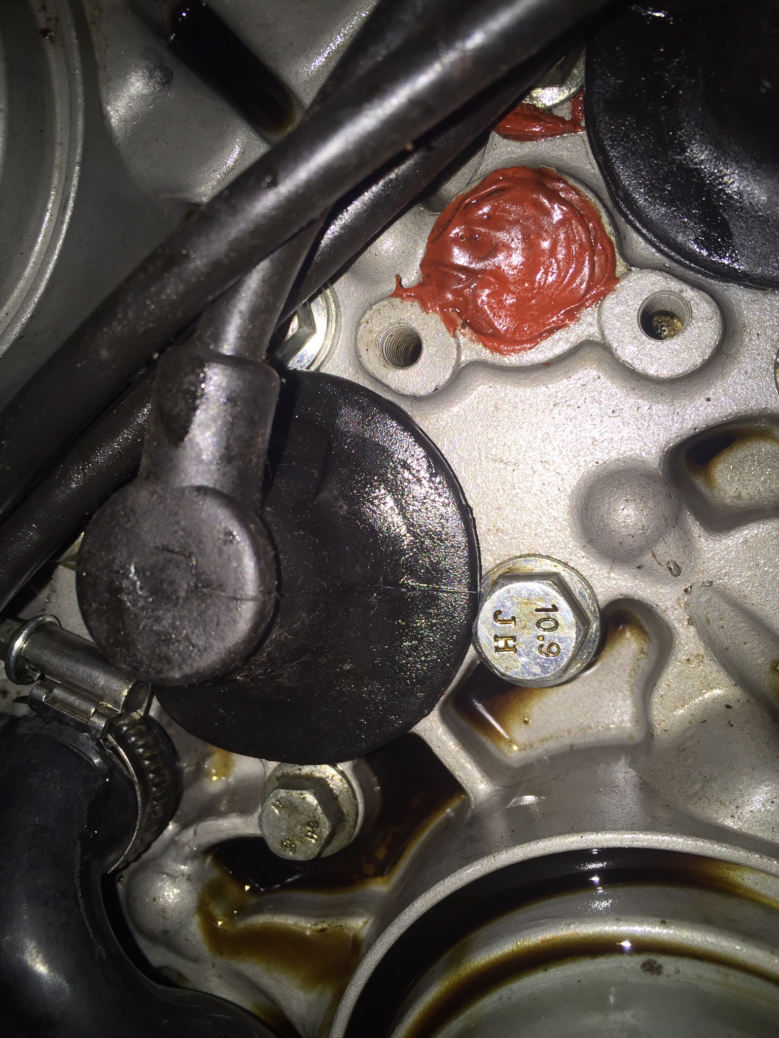

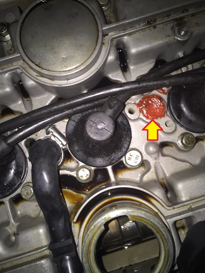

My question is in regards to this plugged hole in the top of the engine. I am the 3rd owner and have had to fix a lot of the previous owners jimmy rigging (why anyone would do the work on a car just to make more for themselves I have no clue) and see this as a possible addition to the list. After new PCV and seafoam treatment the dipstick blow by is not present, but there seems to be oil still leaking in the plug cover area and around the seems of the engine (probably the Head Gasket). If I unplug this hole will that reduce bad engine pressure and improve efficiency? or will it increase leakage and cause more shop time or jack stands?
Car runs fine as of right now. just leaky oil and low compression. 169xxx
here's a pic:
1994 Volvo 850 Turbo Cam cover Vent hole plugged....

That hole just has flat head surface underneath it, that poty is not used on these engines and not really a hole. In some 93 and/or early 94 setups it was used, but I have sketchy knowledge of those engines, and clearly it is not used on yours. If the cam cover is sealed properly then there is no leakage out of that location.
You may have one of those DIY gems where the cam cover is sealed with RTV silicone instead of anaerobic sealer? Check the edges of the cam cover.

Will look into another oil cap, the one I have on her is new so if its cruddy that may be the case. The sealant seems to be red/pink/orange from the looks. Another problem I have considered is this....
There are miss match bolts in the cam cover and some have a 13mm hex head with 10.9 rating. The others are what appear to be reused head bolts. If anybody has any insight on how likely missthreadin is in this situation it would be appreciated.

That is definitely silicone there in the hole. It is not needed but is not harming anything, I would just leave it there.
But around the edges of the cam cover, is it the same rubbery sealant, can you tell?
The cover bolts are easily over tightened, but offhand who knows maybe they are on properly. Again I would leave them alone for now. Clean up all the oil real well then see where it is coming from. No opinion here on the Stant cap, have never used one.
