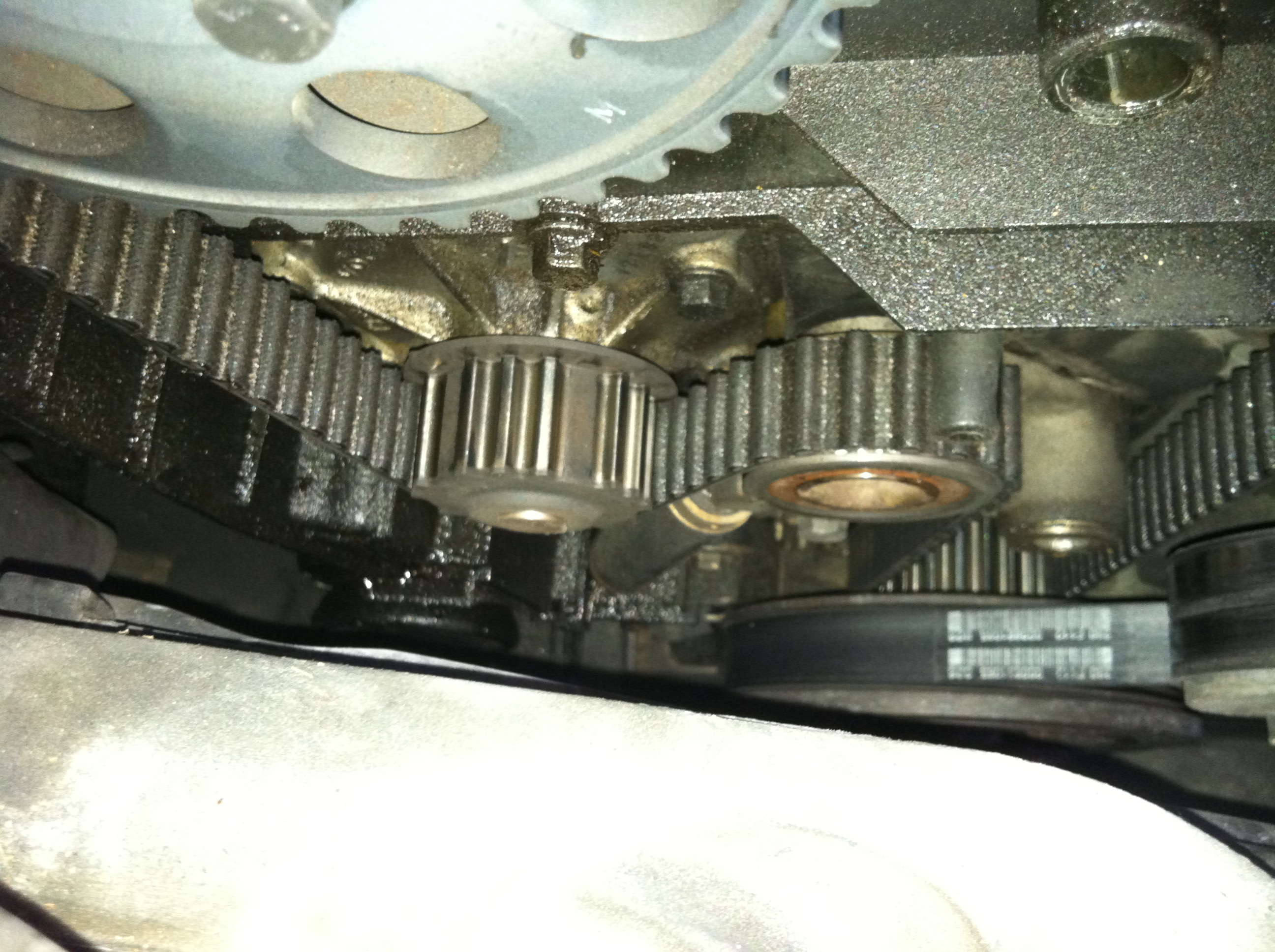

I hear ya. You will know for sure if you check though.
Hydraulic
Mechanical
Hydraulic
Mechanical
