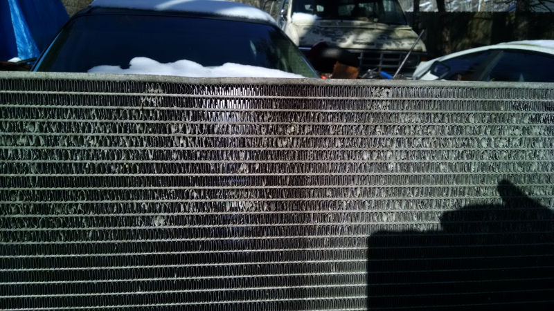

Good times. Finally got the condenser free. It's been slammed with stones on the bottom half and full of little pieces of sand (Image taken upside down). Just going to replace it. Luckily mine uses the cheaper one.
The original radiator was the Premair from Valeo. Putting in a Behr that is straight aluminum. I did notice that the hose necks on the Valeo one have metal inserts on the inside of the necks, reinforcing them. My 1 day job is now going into a week having to wait for parts. Ugh.

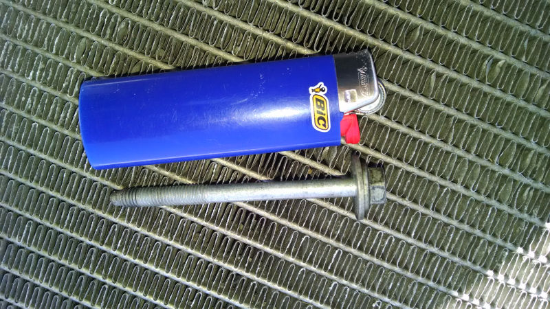

Anyone know the part # of the 4 long bolts that sandwich everything together (pic below)? Threads are 6mm x 1 pitch. Unit was missing the top one on the driver side. Can't locate them in Volvo's online parts diagrams and the condenser didn't have the threaded clip.

Just replace with a stainless steel M6x1 bolt of the right length. If you can't find it, buy one a bit too long, spin a nut onto it, cut off the excess length with a hacksaw (thanking yourself for buying stainless) and then spin the nut off to chase the threads straight.
