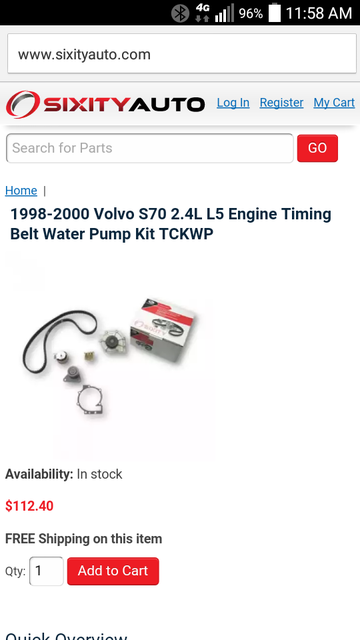

Was wondering if anyone has used this timing belt kit. Looking for some thoughts on it.
The price is definitely good.

Others with far more knowledge will weigh in, but, for me, this is one of the few items I would not be looking to economize even a large-ish amount like $100, given the amount of work, driticality of function, and length of time this will need to perform.

Fair enough and i agree. I've read some really bad things about the water pump catastrophically failing on different makes so I'm going to dismiss this set. I won't take chances on mission critical components. Any suggestions for a good kit or is a better idea to buy the components separately?

Go with a kit from FCP https://www.fcpeuro.com/products/volvo- ... it331wp198, if you're feeling adventurous and want to remove cams! 8) Otherwise, just get the OEM idler, pulley and mechanical tensioner and an Aisin or Hepu water pump. You can get a Volvo belt or a Continental belt, both have a following. Good luck with the job!

Ugh. Elring cam seals = crap. No go on that kit from FCP!
Of course it is fine to replace front cam seals as preventive maintenance but it is not really warranted. I will not replace front seals unless I have the cam cover off anyway (have done that a few times now) or they are leaking (never had one leak yet). If you want to do the seals, buy Corteco.
Gates timing belt kit - pass, as others have stated. Timing belt parts from Volvo will run you about $120 for belt-idler-tensioner, Aisin water pump wherever it is cheapest (i.e., as per Marco's post).

Yeah I'm definitely not bothering with the gates kit. I'll look around and put the set together from the info gained here. Thanks guys.
