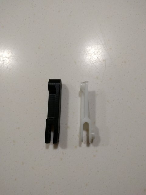

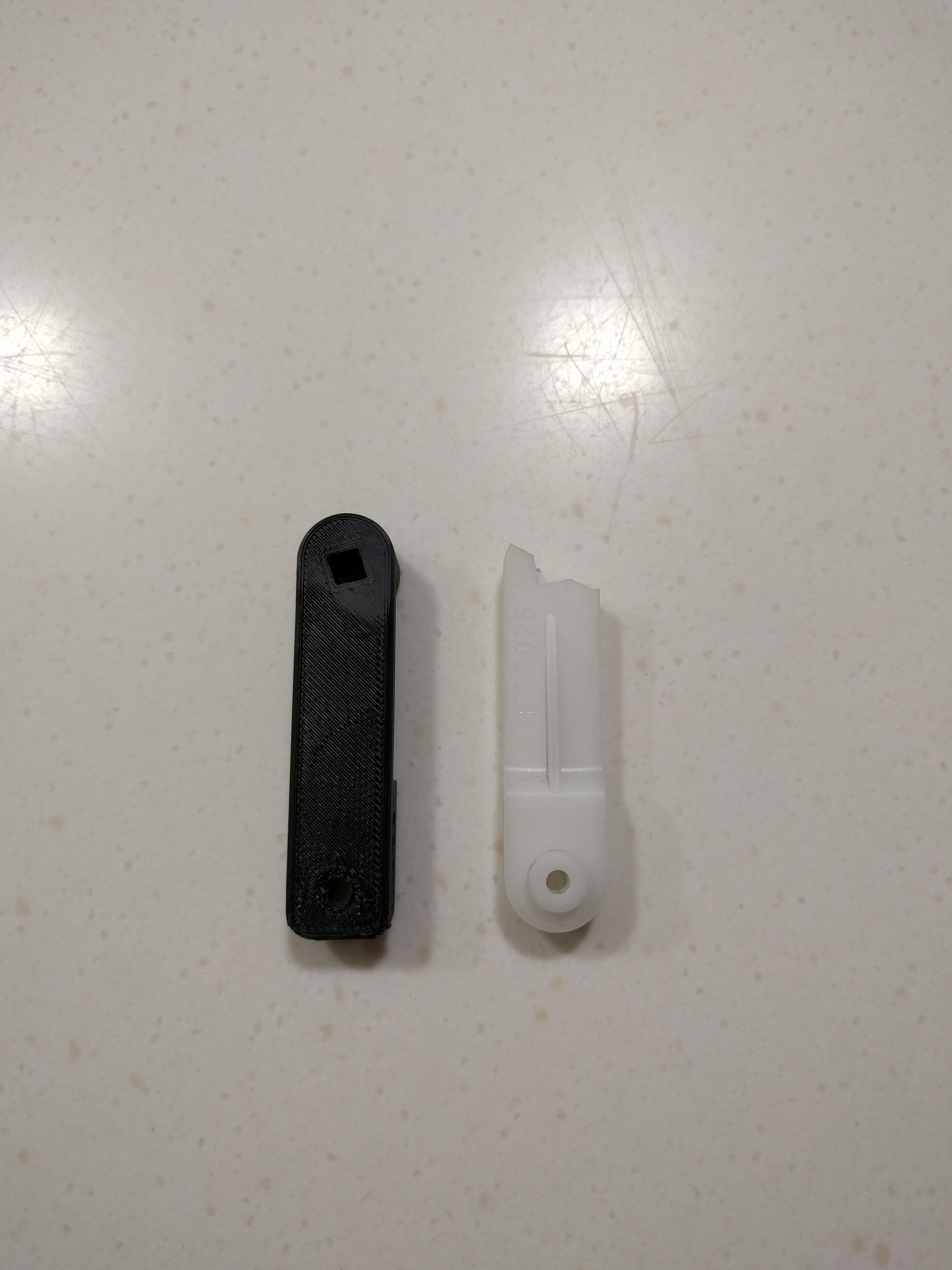

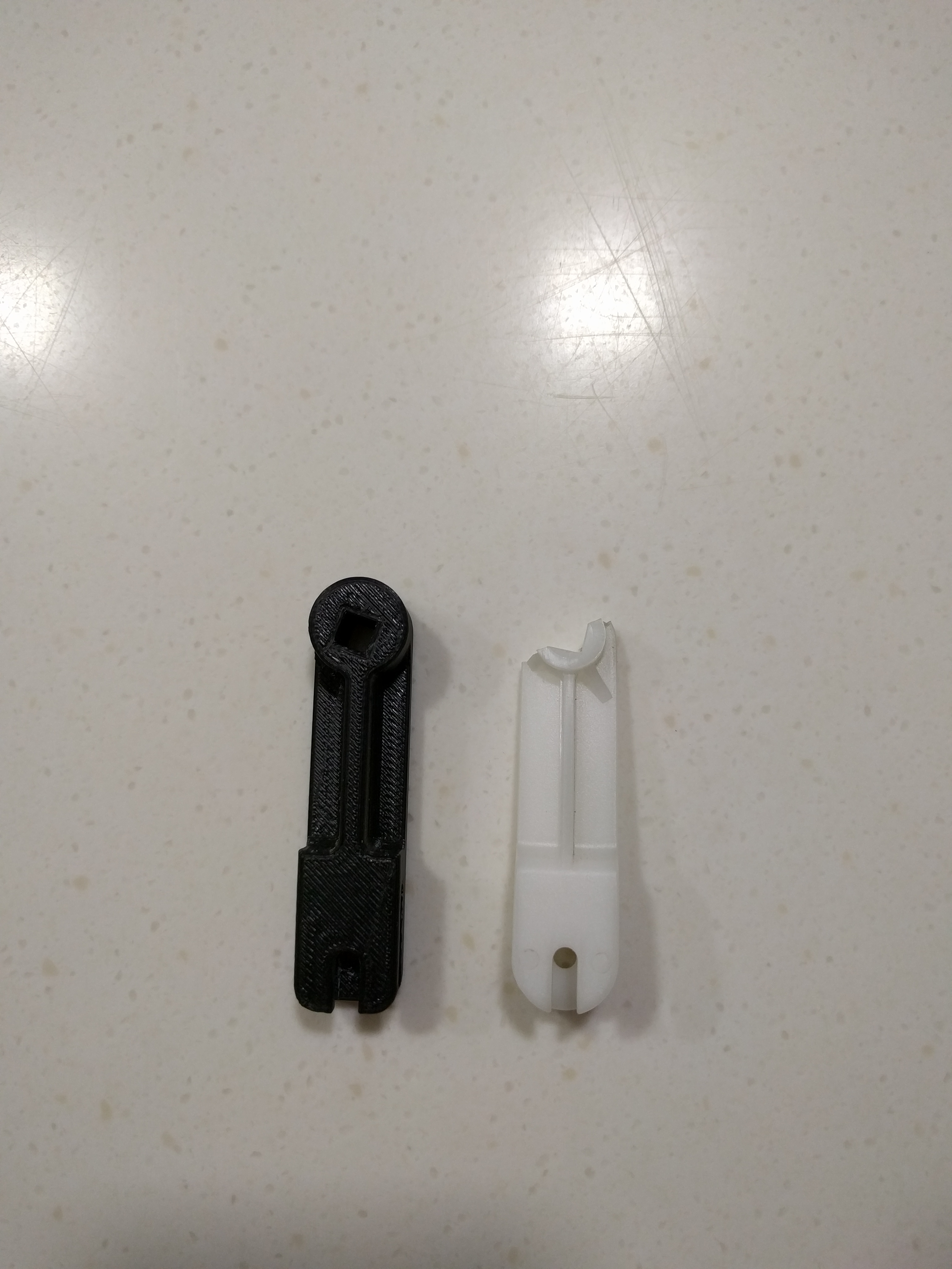

We were given a very low kilometre 1995 850 late last year.
Its had a few problems with the brakes from sitting so long, and some of the plastic is quite brittle when dismantly things so requires car and superglue.
We discovered the recirculating air wasn't working and on pulling the glovebox found the intermediate lever broken around the square drive.
Bit of a search revealed its no longer available and we couldn't find anything where anyone had found a substitute from a later model car.
So having a 3D printer, I designed and made a replacement. Beefier than the original and in ABS - a good engineering plastic.
If anyone is in desperate need, I would consider making them and mailing them subject to the costs of the plastic, time and mailing costs.
Replacement recirculate intermediate lever available.
