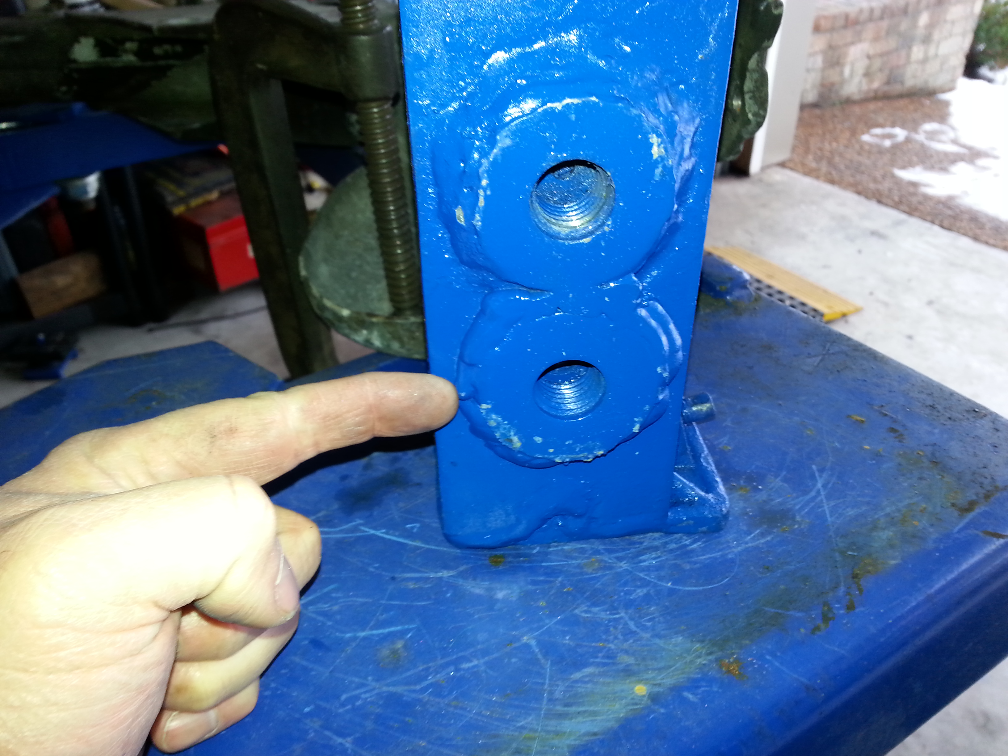

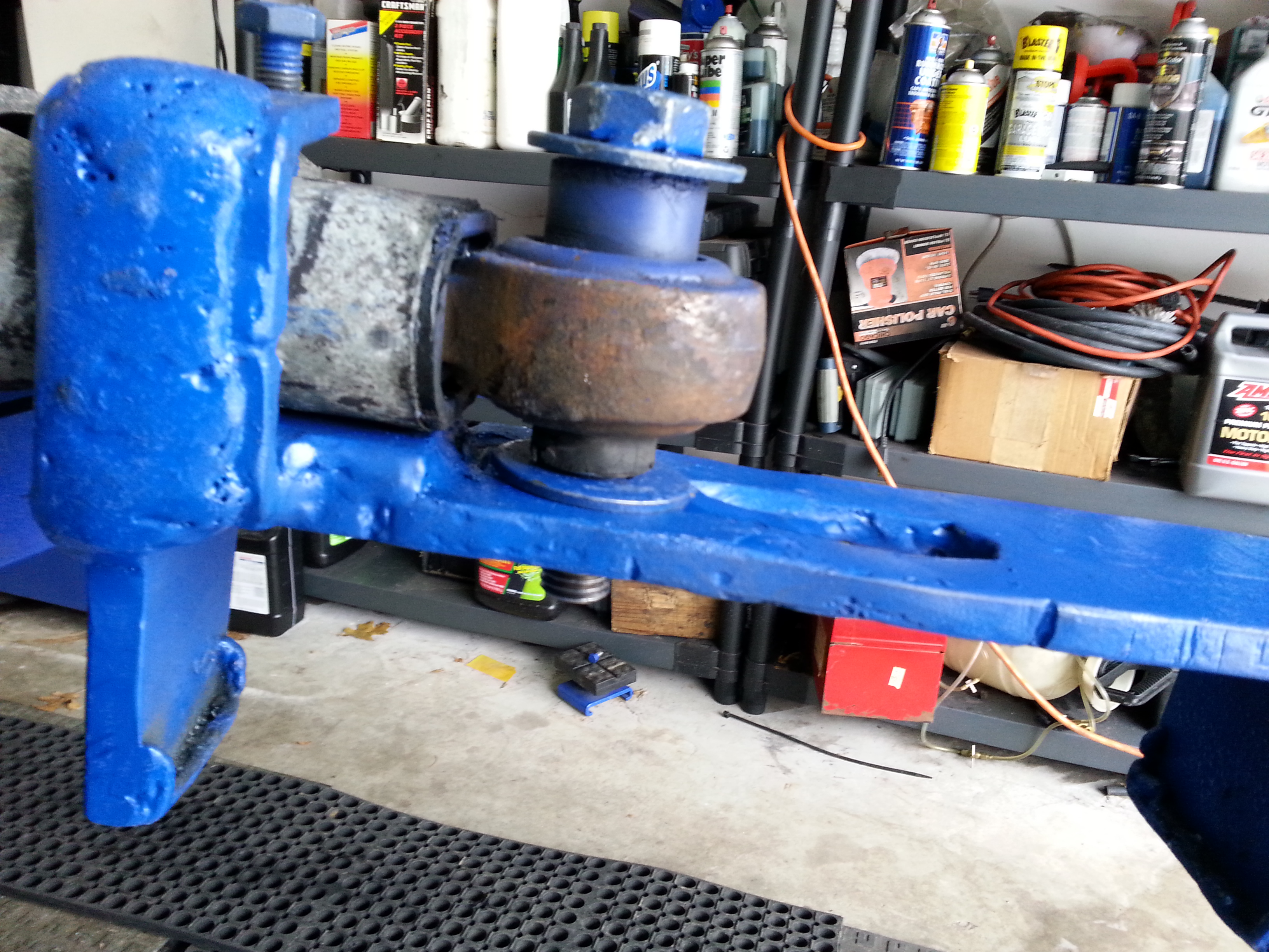

Due to continued breakage of the OE unit, I created and sent to Matt a hydraulic delta link tool. It should be available for rental now if not shortly.
It can create over 7000 lbs of force to pull out the delta link bushing (obvious overkill) .
It makes changing these bushings easy and fast.
I believe the OE version and this one can be rented from MVS . Please use at your own risk.
Here is a sneak peak. Please try it out. Its not perfect or pretty but it sure does change the bushings easily.

Matt will put up instructions with pics soon. I think it makes the job so fast it will be easy to rent if you don't want your own. Either way - Best Wishes.

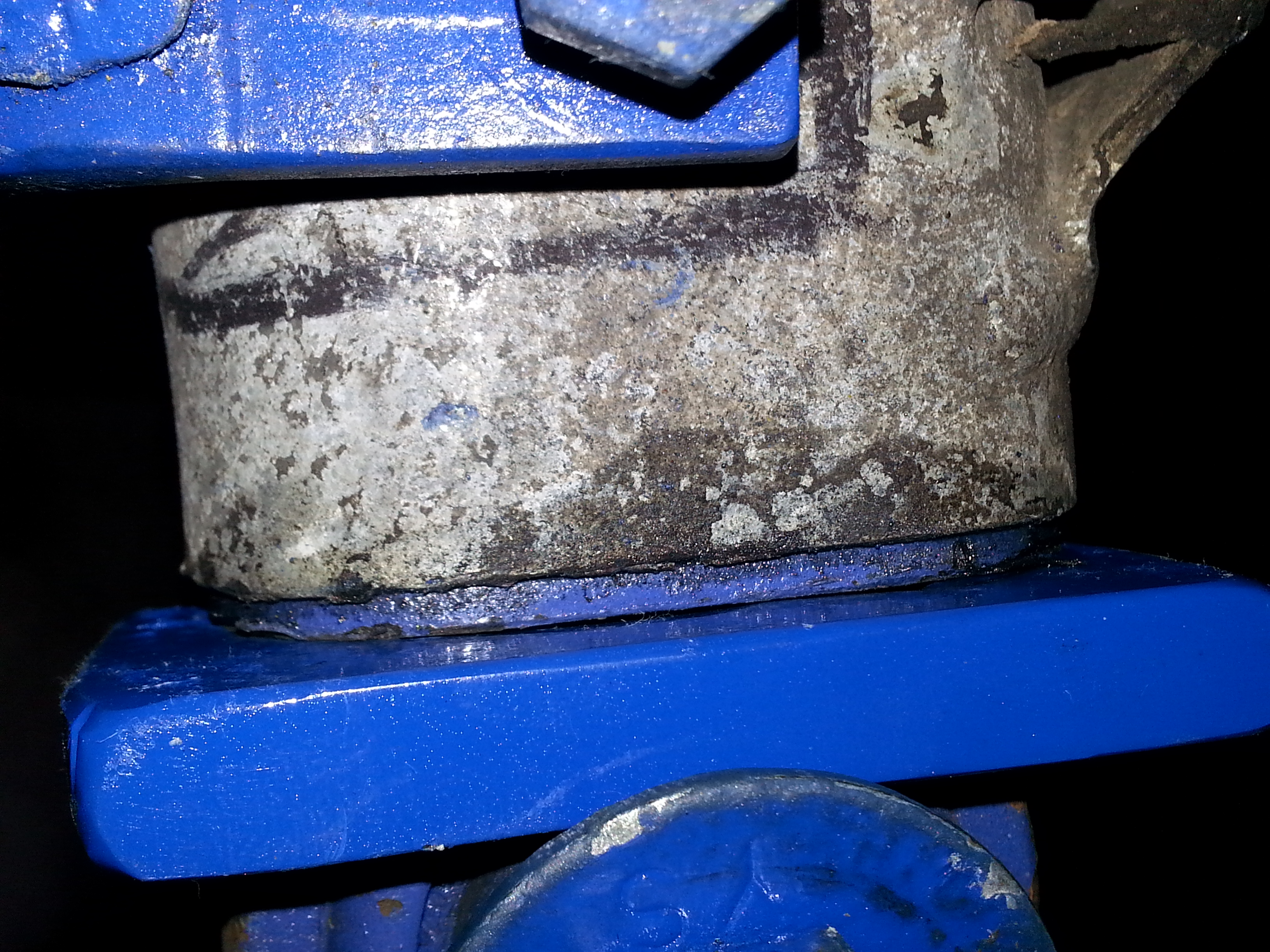

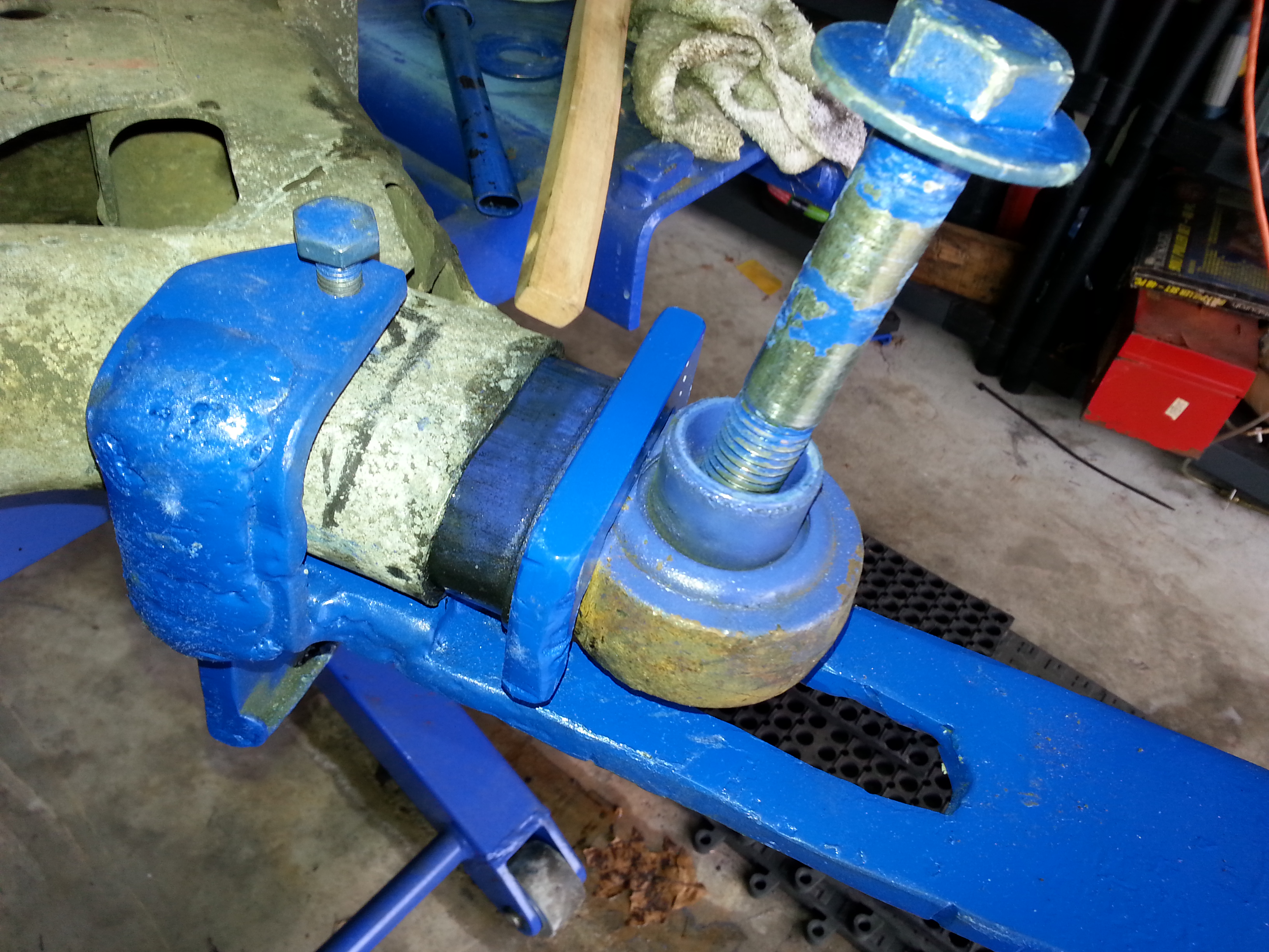

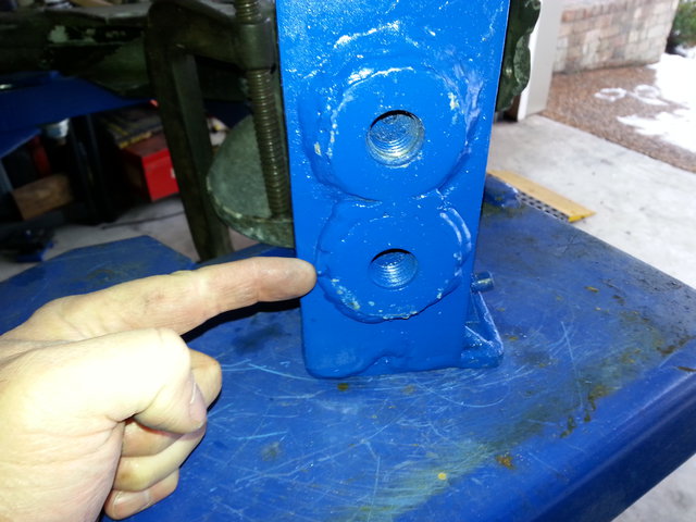

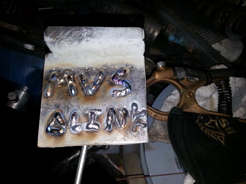

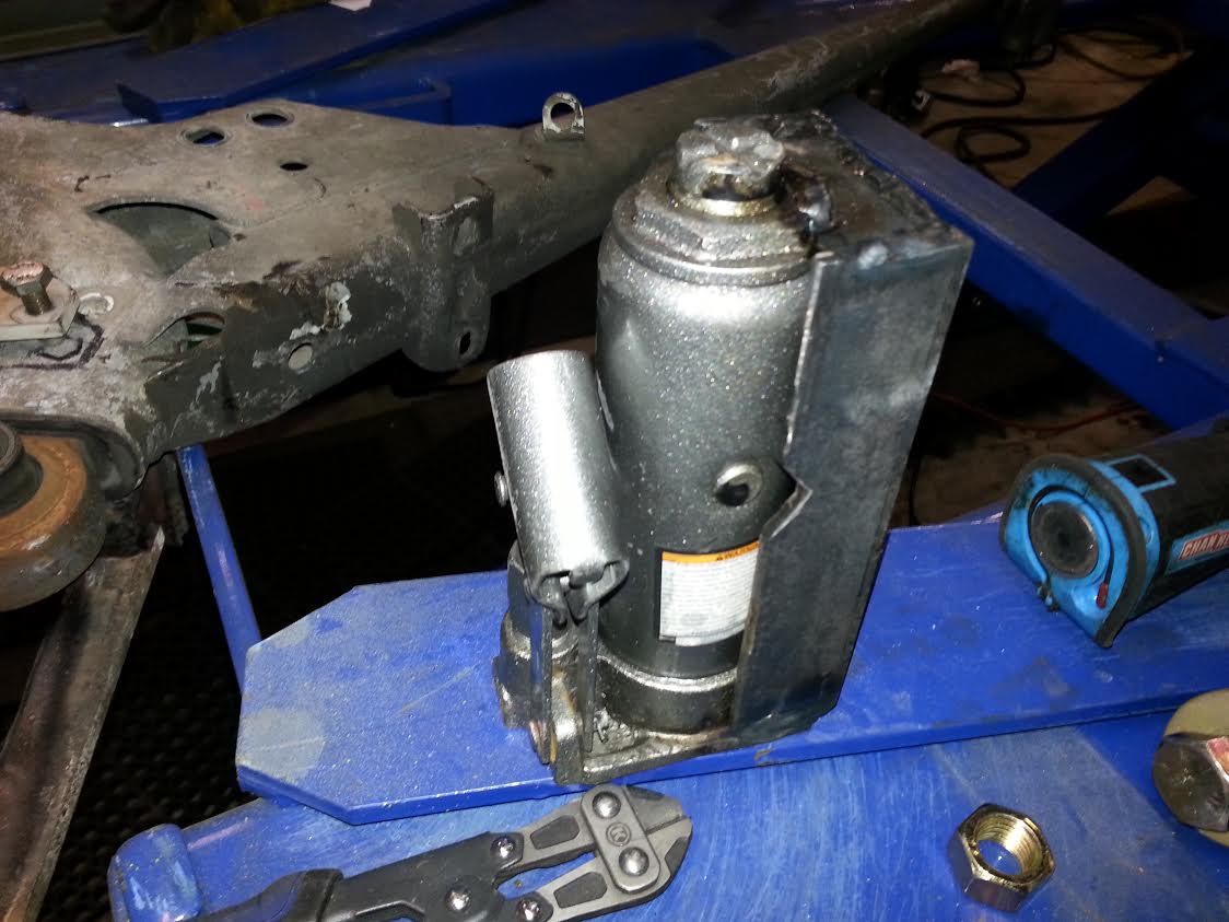

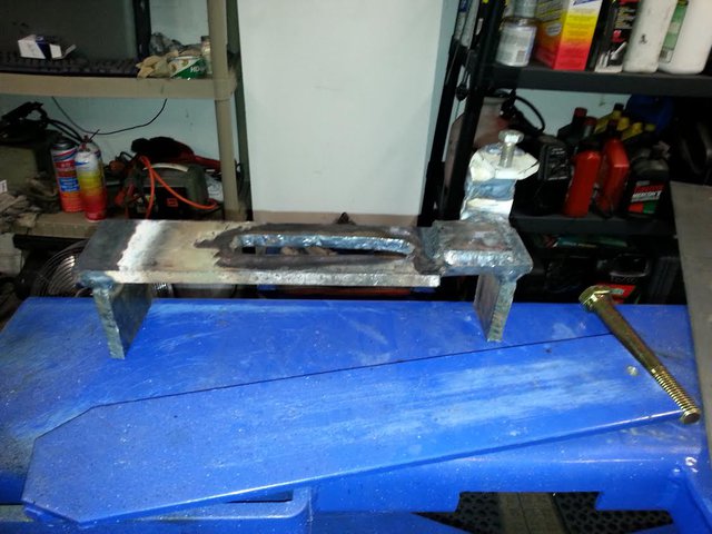

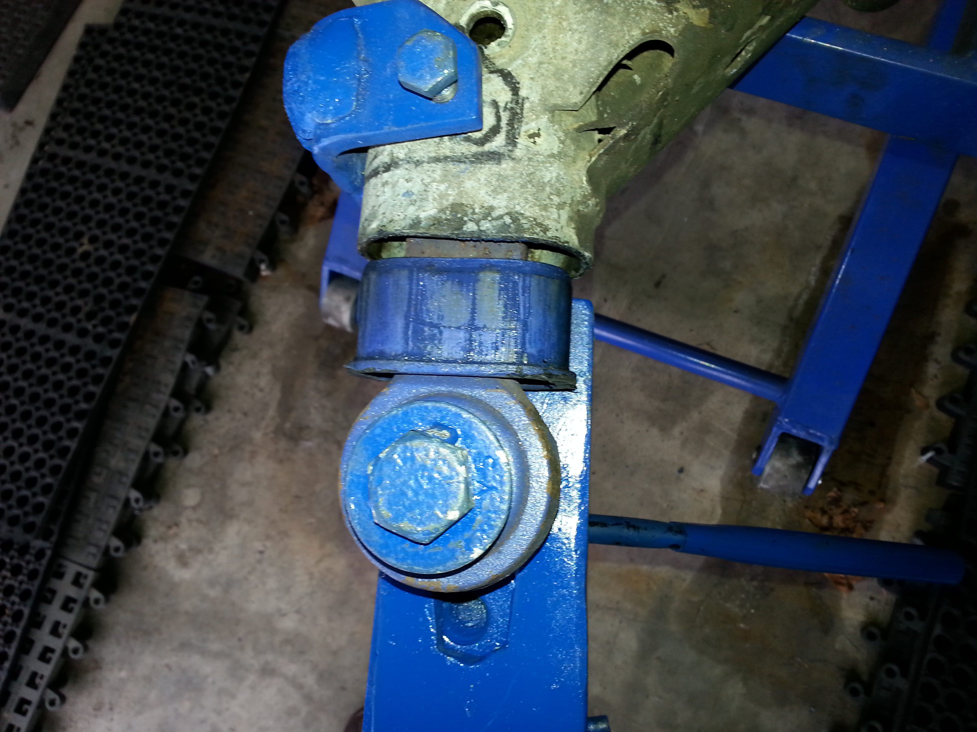

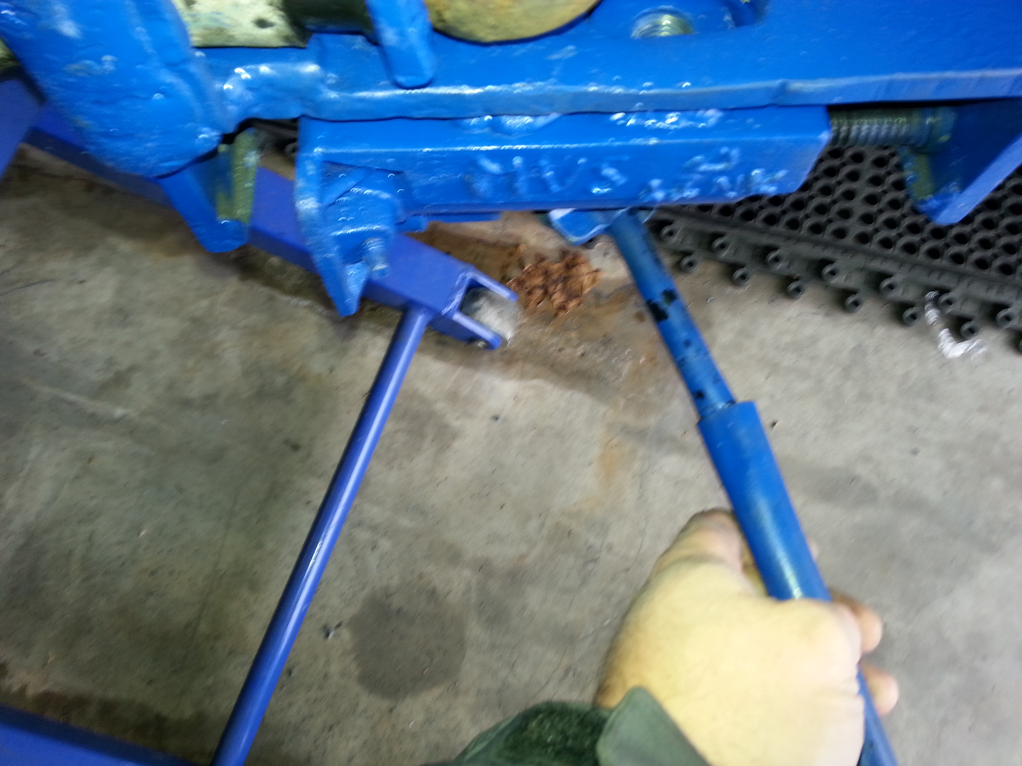

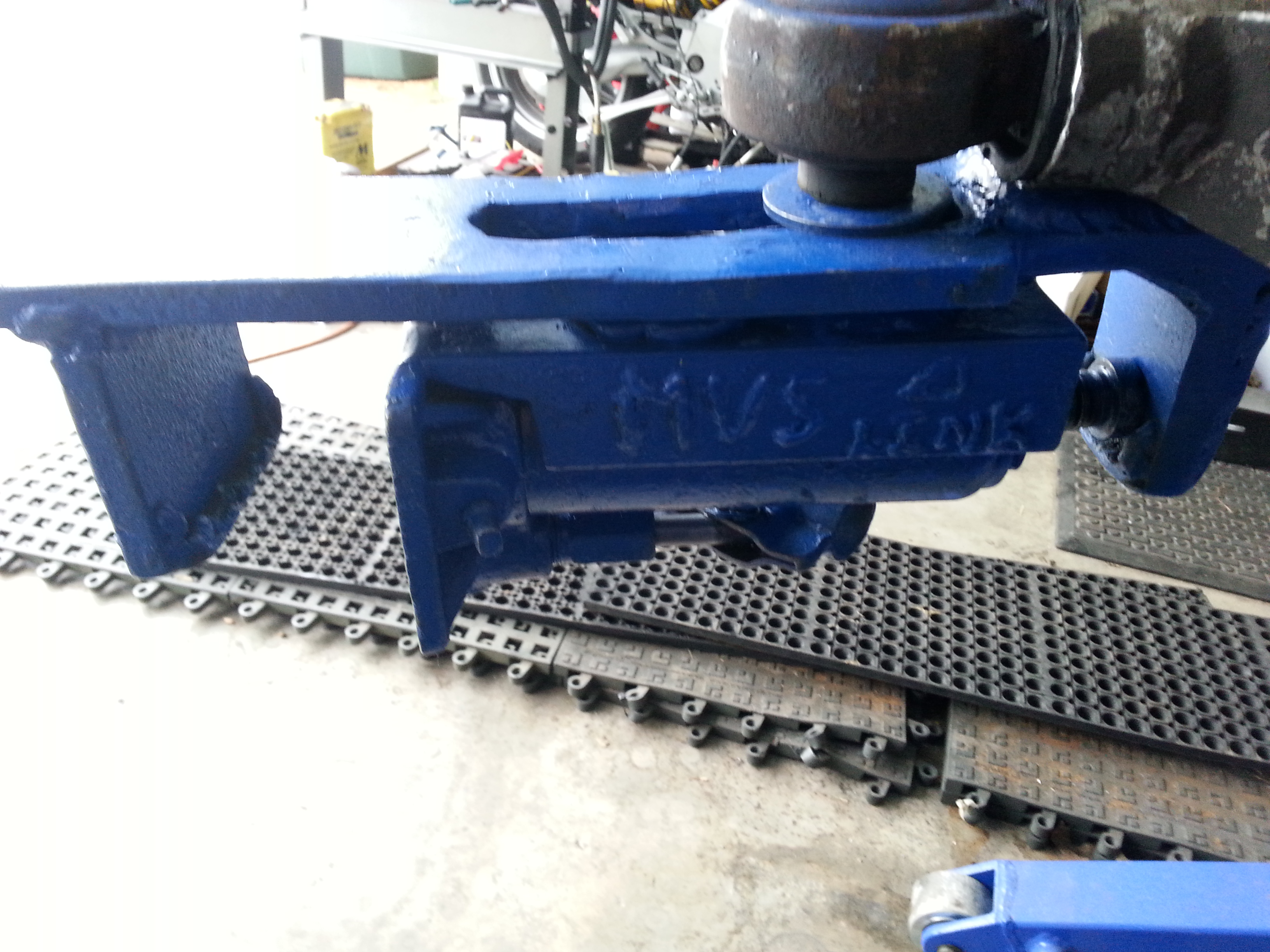

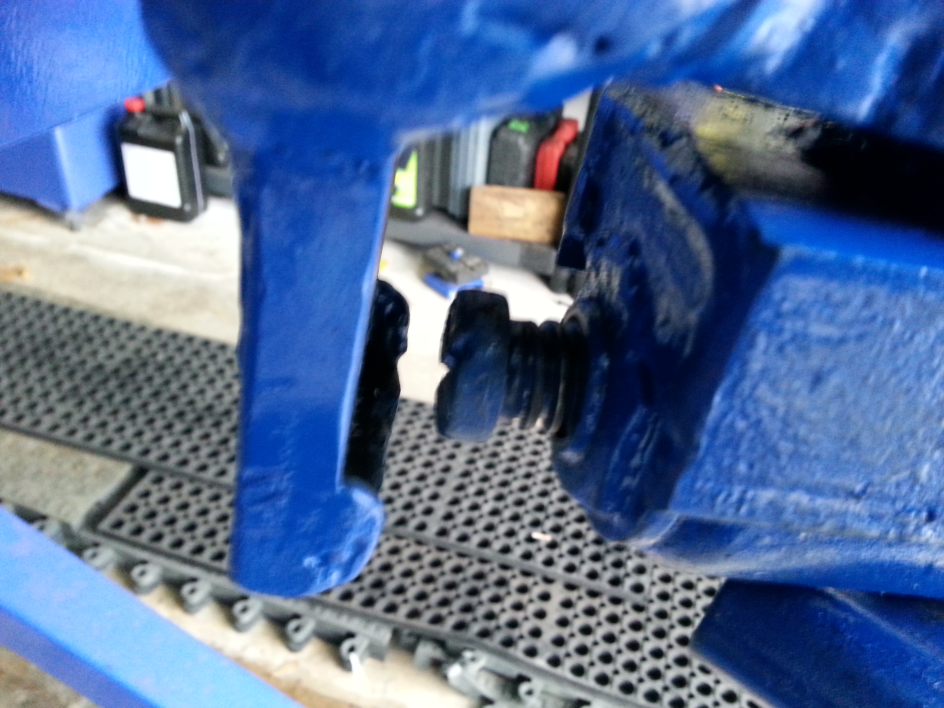

All the metal (except top bolt from Volvo) is grade 8 or stronger (including the pin that goes into the arm -it was an issue). The last 850 I did with this I was able to do both sides (impact gun and this tool) in about an hour. That didn't count putting it up on jack stands. I have a new fixture to weld on the jack that eliminates welding to the top.
Here are some pics from the first prototype.
- delta 3.jpg (56.86 KiB) Viewed 5219 times
- delta2.jpg (92.55 KiB) Viewed 5219 times
- delta1.jpg (84.01 KiB) Viewed 5219 times

You turn the jack around and use lower bolt hole . It presses the new bushing in for you. Works great. 80% of the metal of that unit is there just so it can press it in. Version 1 was a puller only. After I tested it I saw what a pain it was to insert new ones was. Then came version 2.

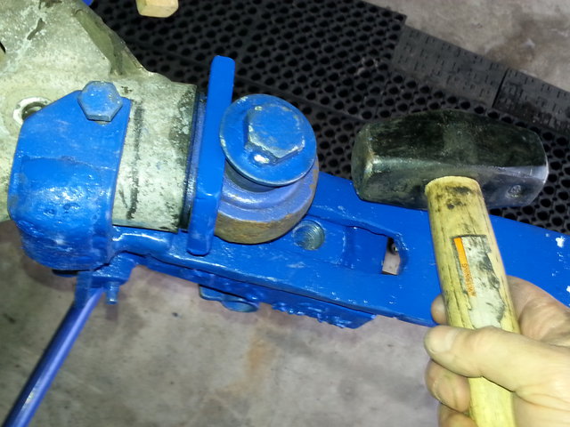

Its ugly, imperfect and in need of versions 4 and up. It leaks a little as the ram is overfilled to provide sideways force.
Don't worry about it, or try to fill it etc. Just use it and let us know. It is a work in progress. I have used it twice now. Love it.
Try to keep the screw ( in center of jacks ram) pointed up or level. ( I stick a piece of wood under the delta arm to almost level it when pressing in.) This gives you more travel on the ram. If you run out of ram ( shouldn't on this version). Just turn out the ram center screw and compress the ram.
When pressing in the final 2 mm just needs a smack from a hammer. You can push the bushing in past were the bolt goes through the arm- it just binds up there a touch. Like I said . With lube, a 3 lbs hammer and an hour I do both sides of the car ( not counting putting it on jack stands , removing wheels ) See pic with hammer 1-2 mm left)
Have fun - Thanks for using it.
