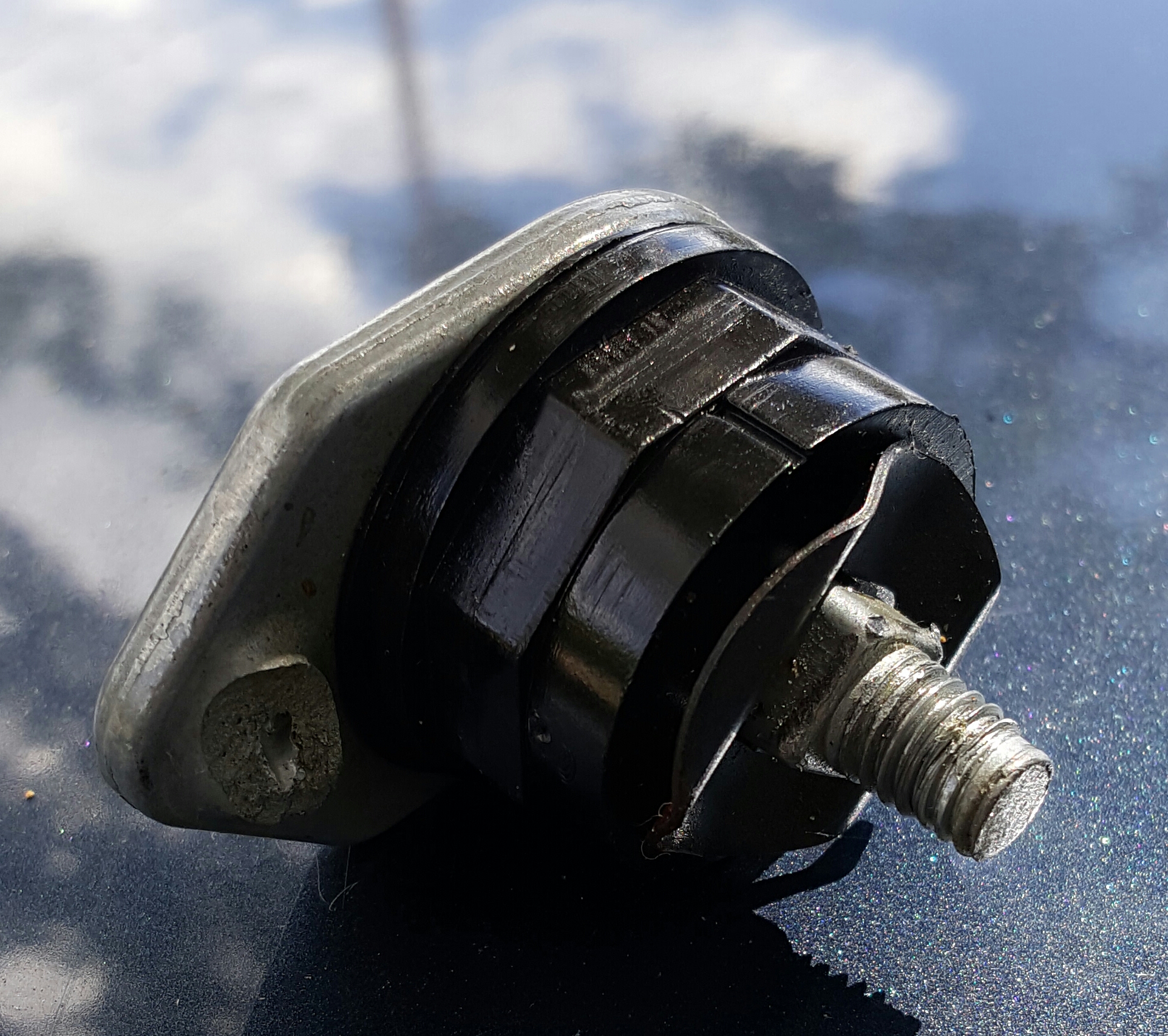

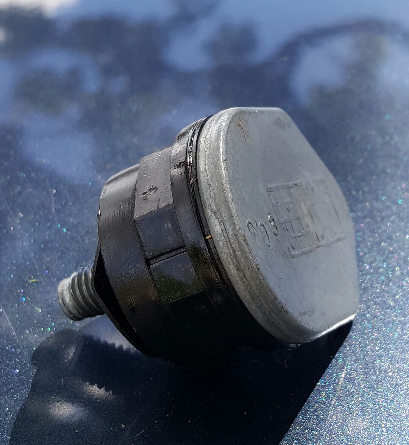

A friend of mine borrowed my S60, returned it to me with transmission problem. Car won't go into gear, only when reved high, it barely moves, but if pushed it will get going and once momentum is built it drives fine, until I get to a stop sign, then have to start over again. Also, found this part in the cup holder (see pics).....does anyone know where it might be from? Looks/smells like gear oil??
Thanks
unknown transmission component

Looks like the part snapped from some where. Can you see a part number on it?

Unfortunately no part number

You are describing the limp home setting of transmission. It takes off in 3rd gear so it is gutless but once you get to the speed range where it would be in 3rd gear normally it feels normal.
I am fairly sure that is not a part from a volvo. It looks like a broken piece of a rubber damped serpentine belt tensioner but your car does not use one of those.
Is there any message in instrument cluster about tranmission? Check engine light on?
- Posts: 36149
- Been thanked: 4068 times
Almost looks like part of a seat adjuster but both the thread and the casting are broken,so it's a part of a part problem
