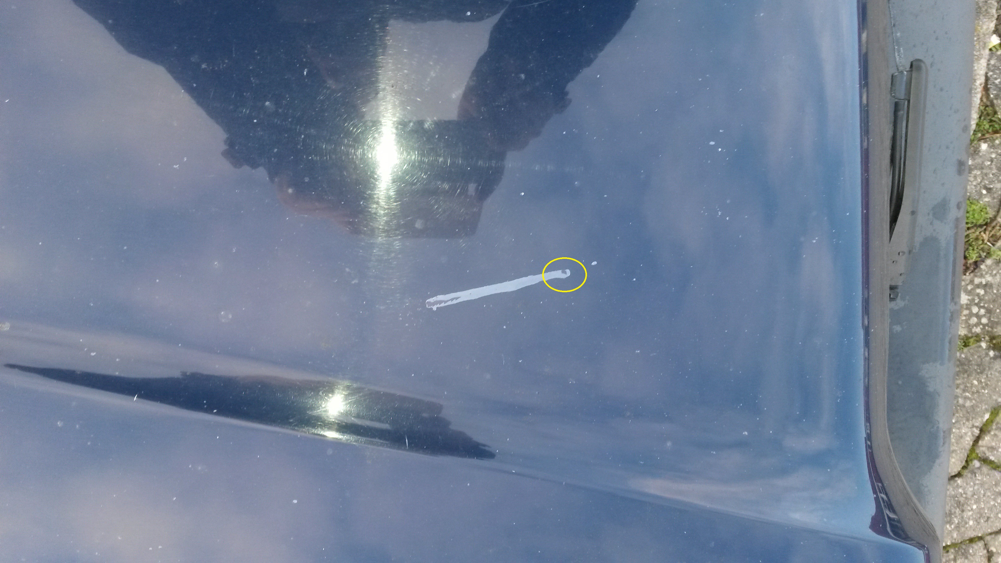

I snapped a couple of pictures of the culprit today and had a closer look at the other panels on the car.
Both wings have started to rust in the usual spots (lower side next to door and next to the head lights). And the boot lid is rusted through in the lower left hand corner. PO had taped it up seemingly a long time ago and never bothered dealing with it. At least I know how to weld/solder so just have to wait for warmer weather for that job.
The clear coat lifting on the hood is probably due to stone chips, as you can see from the first picture.
Yellow circle seems to be where a stone has hit the paint.

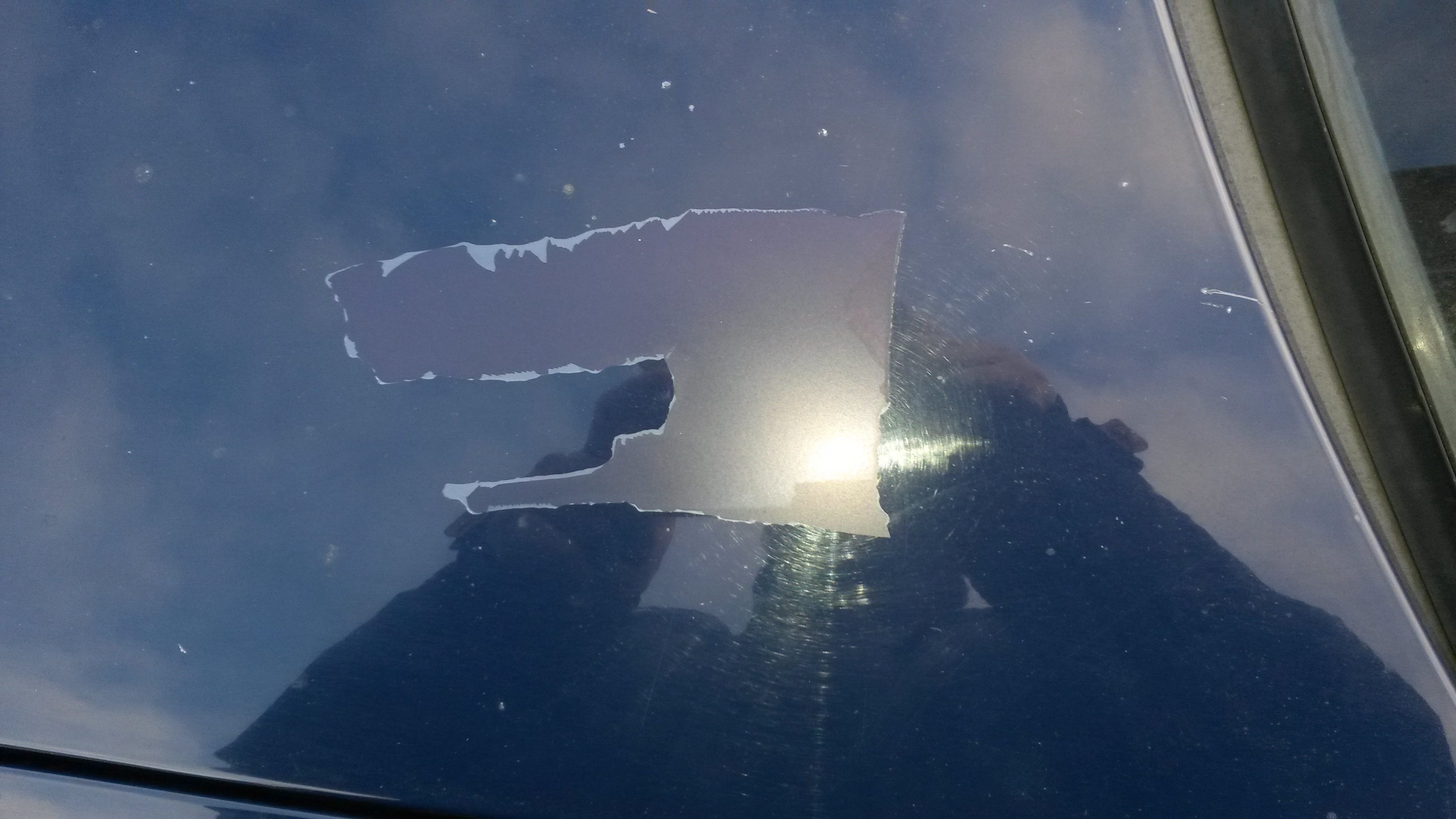

Larger area of clear coat having lifted and vanished.
There are a lot of stone chips all over the hood so I'm thinking maybe the vinyl wrap wouldn't be such a bad idea after all. Have anyone tried that and if so, how does it look over time?
