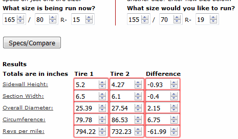

My VW bug spare tire (Tire 1) is taller than 185/75/14 tires for 245, but this tire (#2) is taller. Speedometer would be off via 5 mph from VW tires.
I suspect this 19" tire would work, if shocks/etc were fit for duty. Any rims for 245?

165/80-15 for a VW Bug is incorrect. It was 155-15, 165-15 was VW Type 3. The correct aspect ratio for a 155-15 is 82. The original 155-15 spare tire in my 88 765 is 25" diameter or 78.5" circumference. I measured it to determine reasonable tire size for the car.

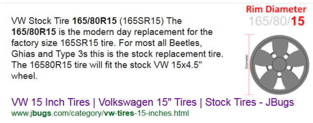

lummert wrote:165/80-15 for a VW Bug
I would have to find an owner's manual, but when scanning this/that, that's what they said.
I've got two spare tire rims mounted with this 165 size, and they work great in winter weather on drive wheels.

http://www.tiresize.com does show the modern replacement tire size as 165/80-15 for the classic VW Beetle.
