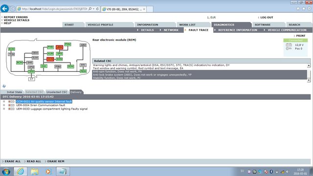

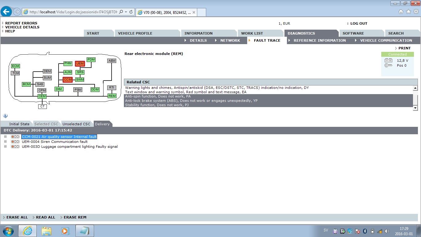

Well I had Vida with me so I connected it. Remember - this is my first time with Vida connected to a car - so I had really hard time getting anything out of it.
But - in addition to the earlier fault codes for lacking lights in the luggage compartment, lacking siren and faulty air quality sensor - there was a fault code for ABS sensor, right front if I remember right. But - I managed to erase it =O(
Starting the car again - there was following text coming up on the right of the car-diagram-picture:
Rear electronic module (REM)
Related CSC
Warning lights and chimes, Anti-lock Brake System (ABS) indication/no indication, CP
Warning lights and chimes, Brake failure indication/no indication, DE
Warning lights and chimes, Antispin/antiskid (DSA, ESC/DSTC, STC, TRACS) indication/no indication, DY
Text window and warning symbol, Red symbol and text message, EA
Anti-spin function, Does not work, PA
Anti-lock brake system (ABS), Does not work or engages unexpectedly, YP
Stability function, Does not work, PJ
When I'm looking into the different tabs in Vida - this happens every time:
When I get into the Delivery Tab - the ABS light starts blinking. I just go in the tab and this happens. Without clicking on "Read all" or any other button.
Does any of this give any hint on why she is experiencing the car behaving different from before?
