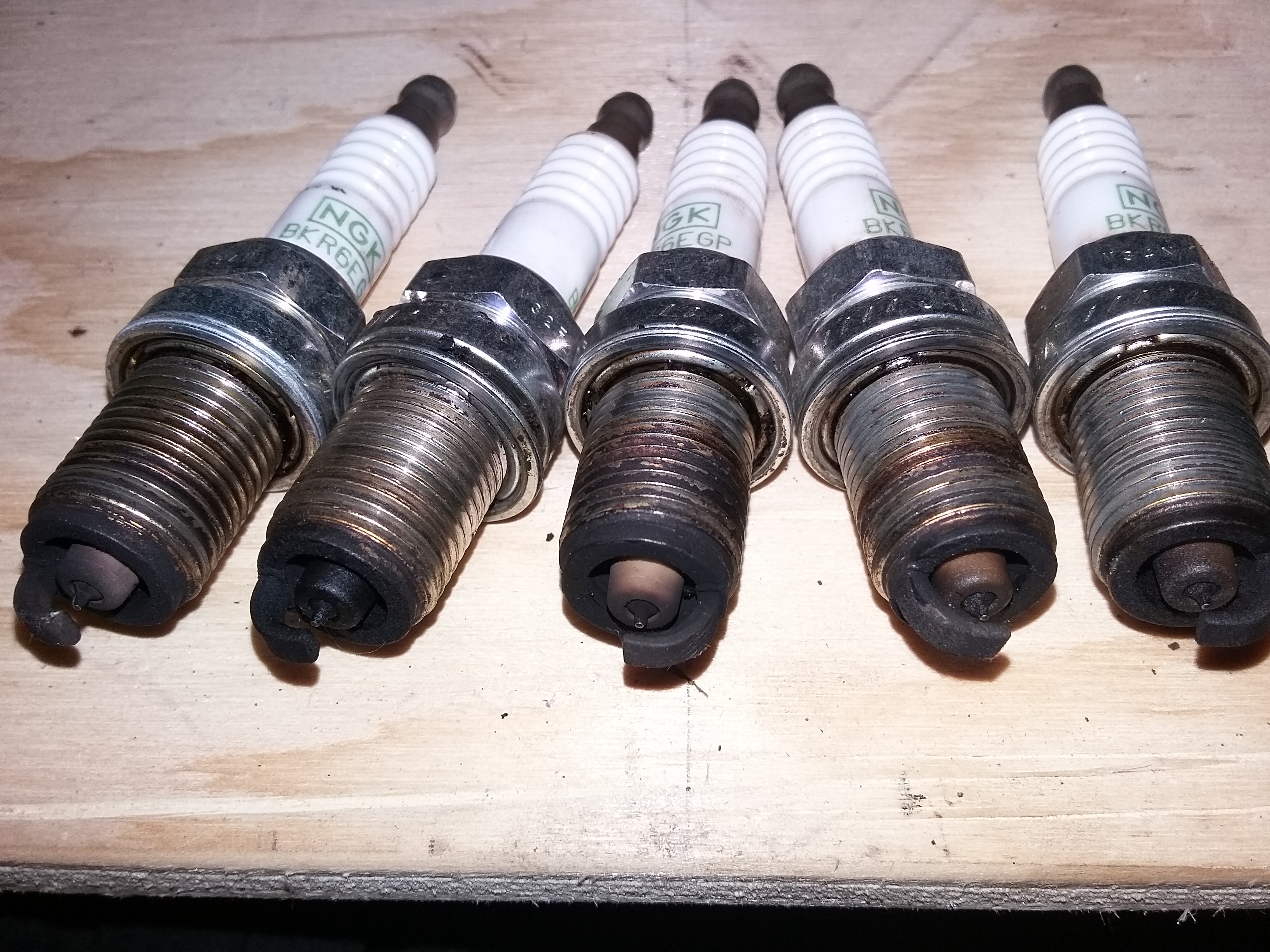

Pull all five plugs and keep them in my order, snap a picture of the business end and post here!

thanks for the replies. Now I can do everything you guys asked if I can only get the spark plug cover off
! 3 of the 8 bolts have rusted heads. I have to mess with that first.
I will post a photo of the plugs when I get them out.

- Posts: 36145
Plug gaps look large, but measuring them and setting them to small side of0.028" is good to do before replacing
