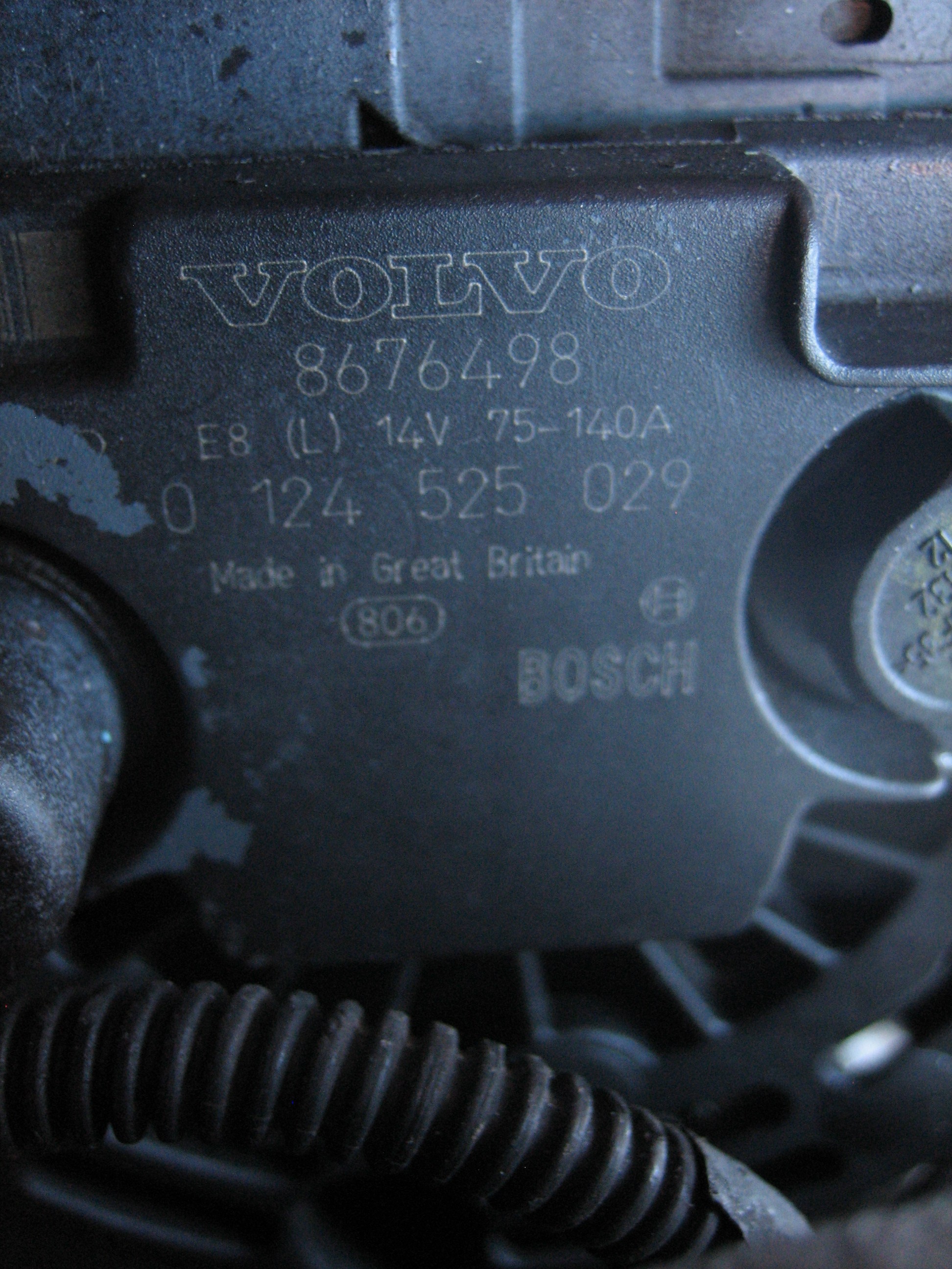

I managed to take a picture

You have the 140A alternator with the clutch pulley. I work at a starter/alternator rebuilder, but we can't ship to Canada. Try a local auto parts shop. Here are some part numbers that will work. I know the WAI unit is available on amazon for $147 US https://www.amazon.com/Discount-Starter- ... B0051BOSLU
0124525029 - OEM number (VERY expensive)
AL0820N - Bosch NEW aftermarket number (expensive)
AL0820X - Bosch remanufactured unit. (somewhat reasonable)
13998N - WAI aftermarket unit (MUCH cheaper, fairly decent)

Thanks, do you think I can fit a later 05-09 140A ? Is it different than the early 140A?

Ok, found the answer, 2005+ have a different regulator so it won't work on 2003-2004 unless the regulator can be swapped (don't know if doable).
