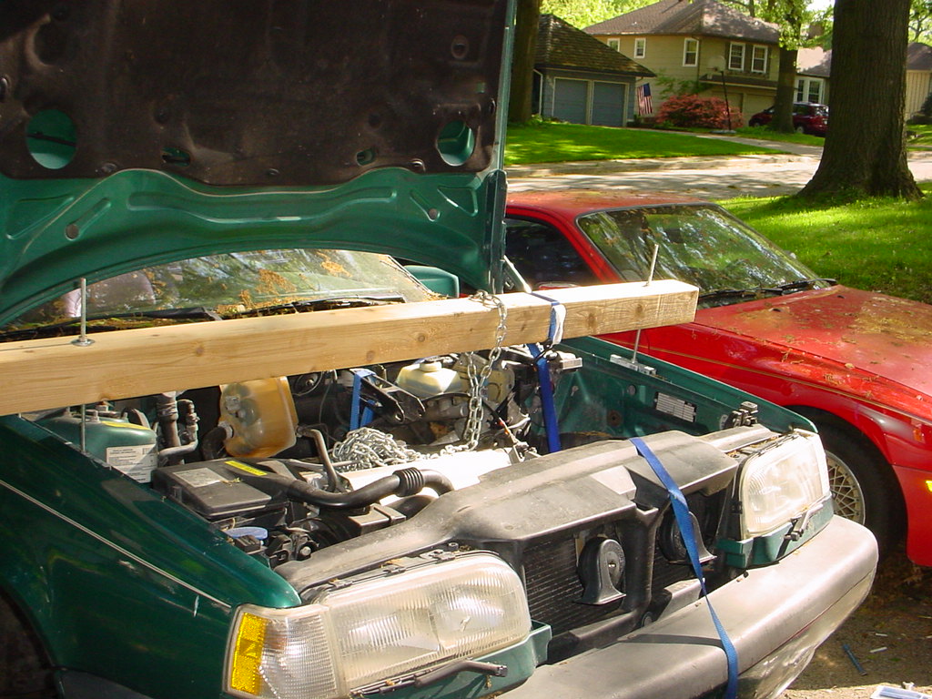

Maybe two strong people can put the trans suspended from 2x4s from above while you guide it in?
I don't think an M56 weighs that much

I used a ratchet strap around the transmission that was looped over the top support that was suspending the engine. With the strap I was able to lift the transmission up and take the weight and it gave me the mobility to rotate it into the proper position by hand. As I recall I think I may have added a second strap to control how the transmission rotated. Doing it purely by hand is not an option for me, I'm just not that big and beefy of a guy.
I had a similar problem with the transmission jack when I was putting the transfer case back in on my Suburban last year but in that case I wound up calling my son for a second set of hands. He is a big and beefy guy.
I found a picture of how I put it back in and indeed I used a second strap just to rotate the transmission. It really wasn't carrying any weight so I just stuck that strap over the upper torque mount bracket.
...Lee
...Lee

Manipulating even half that weight with fine motor control is tough. But you can hang 110 # from above with two people while a third guides it into place from below

Closing this loop. Hung it from above... (wrapped the strap around it) from the fat part of the transmission and it slid right in. Thank you again.
