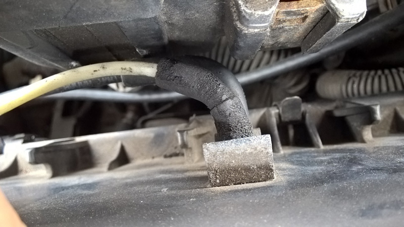

Hey guys, hope you all getting reading for another weekend of Volvo tinkering! (Apparently it's going to snow this Sunday here in NYC!) :cry:
I know the P0455 is a topic that has been beaten to death... And yet, it still keeps rearing it's ugly little head!

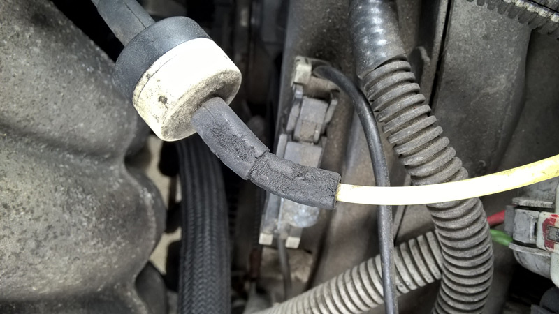

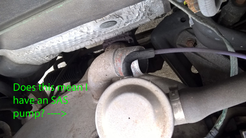

Do elbows in this kind of condition usually throw a P0455? Wouldn't a bad elbow only throw a P0442? Also, that's an Air Pump Check valve, right? (This should really be modded, no?) The P0455 always happens on my wife's car right after a thump sound coming from the left side of the engine...
Thanks!

You can find replacement rubber elbows at the chain store for few $ -- 2-3mm OD would fit nicely. I use a tiny drop of glue to hold it in place.
That is EGR value at the exhaust manifold.
How is rubber hose connections at the fuel filter?

No clue. I changed the fuel filter when I got the car, you know, the whole stage zero thing. And didn't really pay attention to anything down there... My J and L hoses leave much to be desired and I'll get to those as soon as I get a weekend with sun!
I walked into two Autozones yesterday and they didn't have any elbows! I'm going to try to wrap them in shrink wrap tape and see if they hold. Thanks about the glue tip. That makes sense to me.
Thanks for pointing out that EGR valve!
Do know know what trips a P0455 rather than a P0442?

It isnt a part, the code generated is driven by what happens during the EVAP cycle check procedure.
The detailed description on this and the codes is here on MVS...somewhere.

As abscate says, the P0455 code is usually caused by the Evap system doing a vacuum check and finding it can't pull a vacuum as there is a leak in the pipework somewhere, or a valve has failed.
