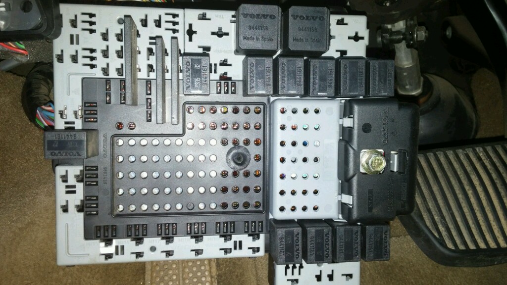

Hi, looking for the fuel pump relay location for the 01'. I was able to find several other years s60 03 and 04. The under dash fuse panel on mine looks different than those.
I will try to include pic...found tab on left side of under dash fuse panel and was able to release it to take pic.

Here a pic...

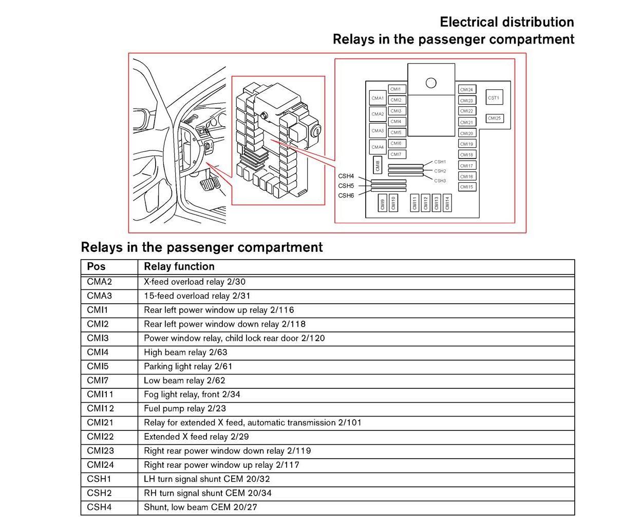

I found the following diagrams on the Web. My understanding is that your model/year isn't equipped with the fuel pump control module. As per the diagram, the relay (2/23) provides power to pump directly (6/33). It is located in position CMI12 of the CEM. It is the relay located on the left hand side of your pic.Edengweiss wrote:Hi, looking for the fuel pump relay location for the 01'. I was able to find several other years s60 03 and 04. The under dash fuse panel on mine looks different than those.
Hopes this help.

Thank you very much for pointing that out I will replace it as soon as I make it back to the car and let everyone know thank you
