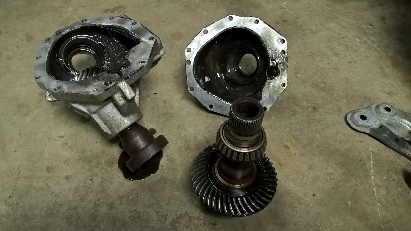

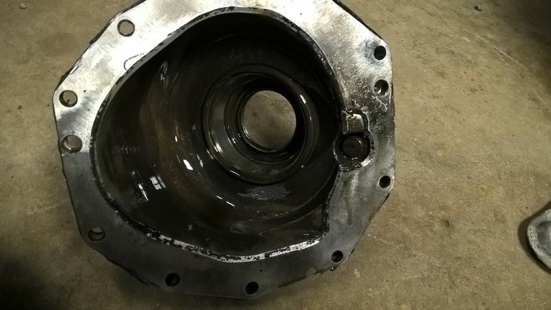

OK, I picked up the XC70, 90,000 miles, in very nice shape overall. I had it towed home yesterday, put it up on stands tonight, and pulled the driveshaft and bevel gearbox. The rear driveshaft seems to be in useable condition, although the CV's in each end seem stiff and likely need re-packing. The problem, however is the bevel gearbox as reported by the previous owner. The output to the rear driveshaft was very loose, and oozing gear oil.
I've attached a few pictures. It looks like there really are no user-serviceable parts inside. The gears have tooth damage, and the bottom of the housing was full of roller bearing pieces. At the split line on the housing there was some grey assembly paste that didn't seem to be 'factory' installed. Looking at the cover casting, it appears this box has been apart to modified and re-sealed per Volvo's TNN 'Angle Gear Fluid Leakage'. It's not a good sign that the box has failed now, with so few total miles on the car.
In any case, the question now is what to do... I am on the search for a replacement box locally, but am wondering about driving this car in the meantime. The drive collar stayed in the transmission, and I can make up a keeper to retain it like I did a few years back on my old V70, so that's not a concern. My only reservation is with regards to setting codes/warning lights. Will pulling the AWD fuse prevent that? I'm hoping to lure a reply to two with the pics below!
