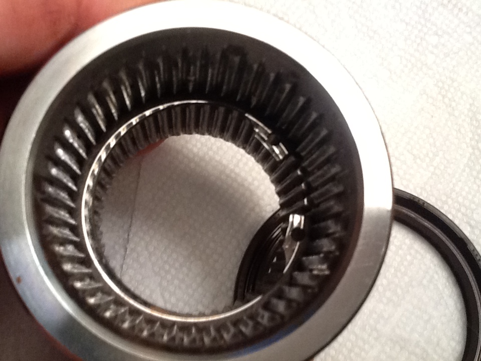

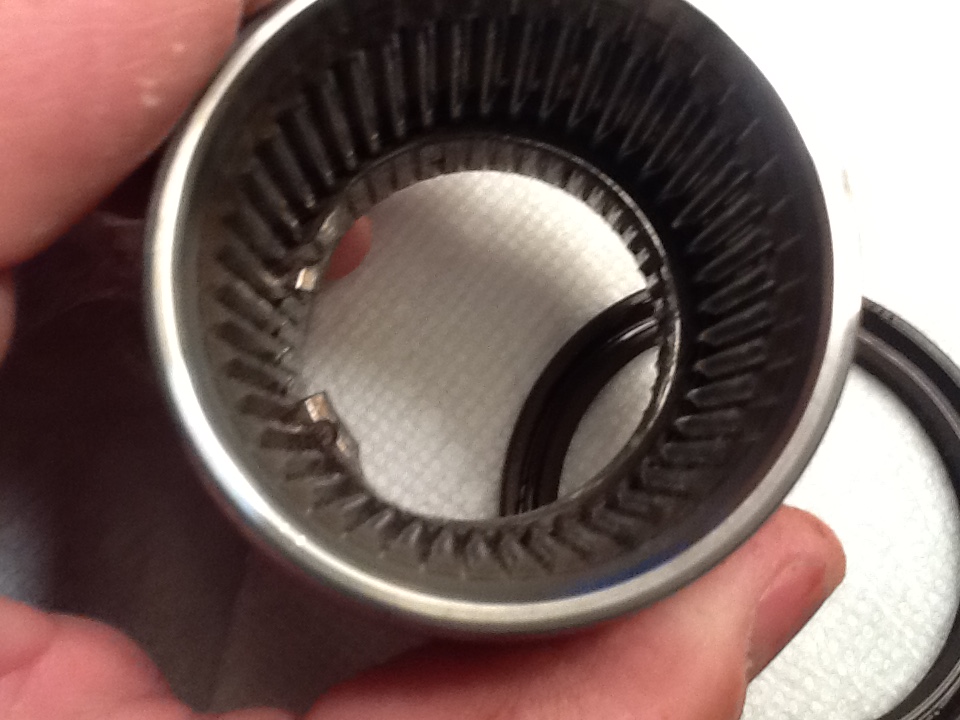

I installed this part on my 2000 V70 XC automatic this weekend. The seal number is AH 3187E. I used a vice grip slide hammer to extract the sleeve. Inside the sleeve are splines seperated by a clip. The outer splines were heavily worn away. I had to raise the engine to get the transfer case out. Whacked in the new sleeve with a board and hammer.
