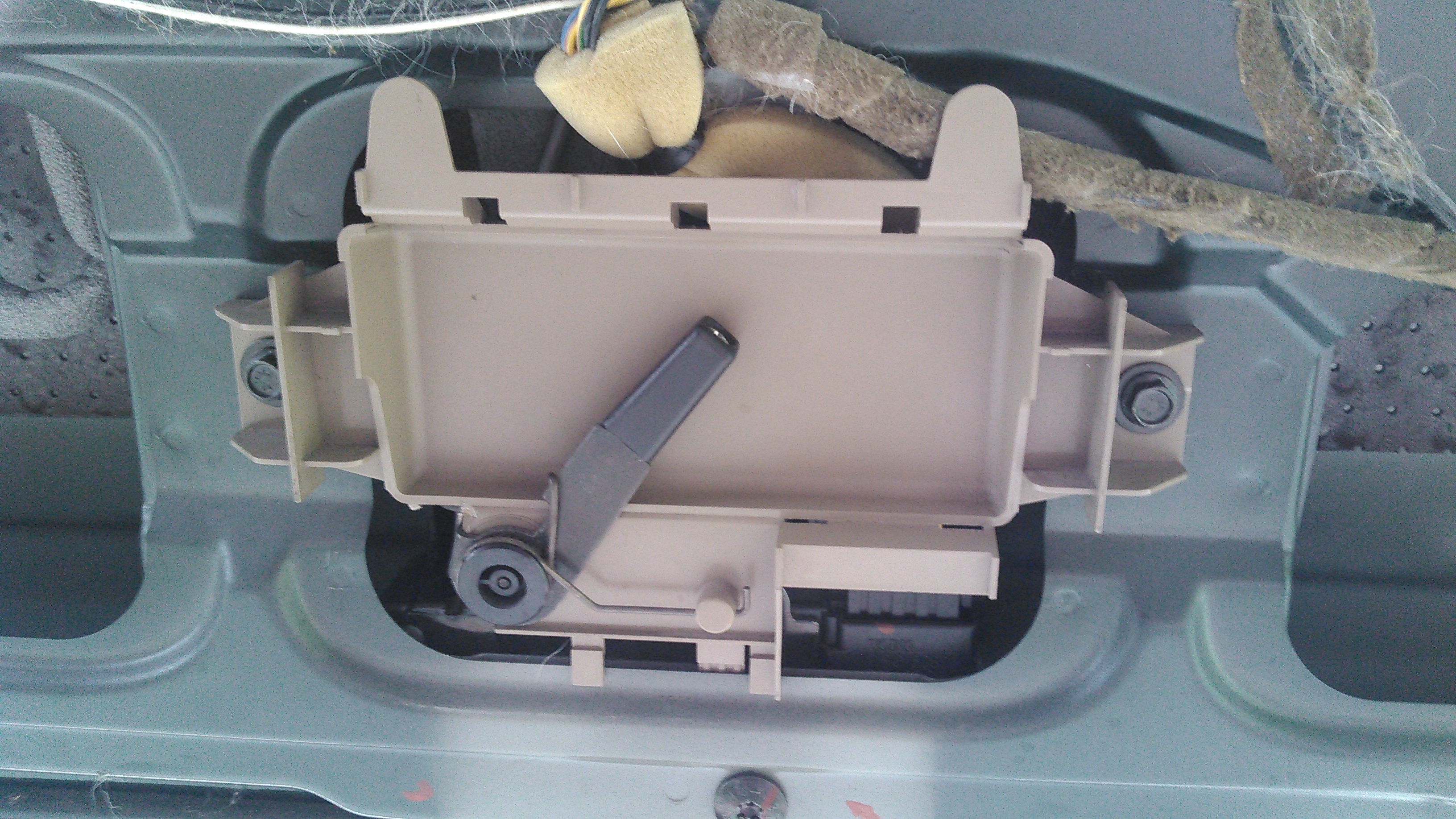

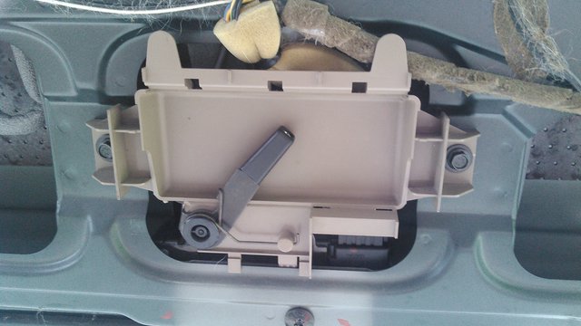

After the trim panel is removed, remove the "cover"- it's secured by 2 X 10mm bolts on each side. Note the orientation of the tabs on the "bottom" of the cover, & where the frame fits into the "slots" created by the tabs-yours may have a bit less Labrador hair (this looks “up” as the tailgate is raised):

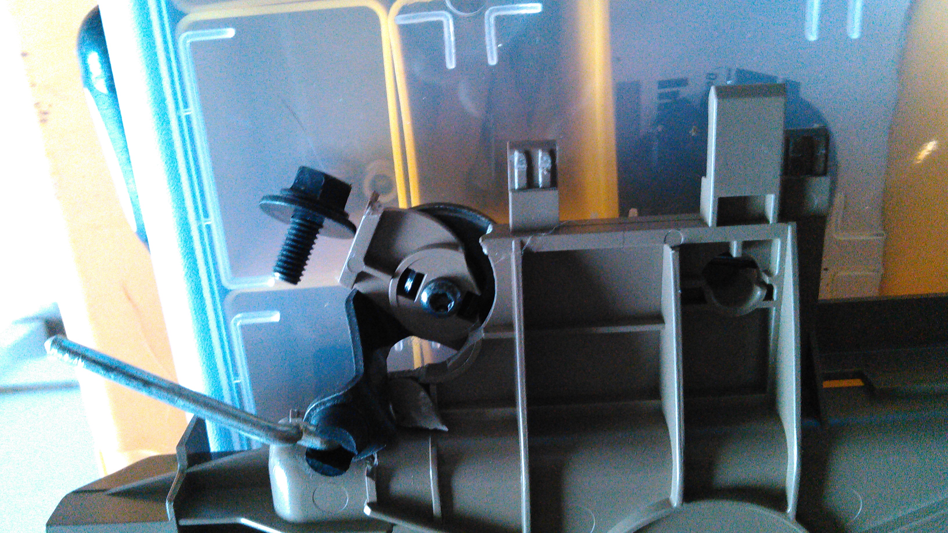

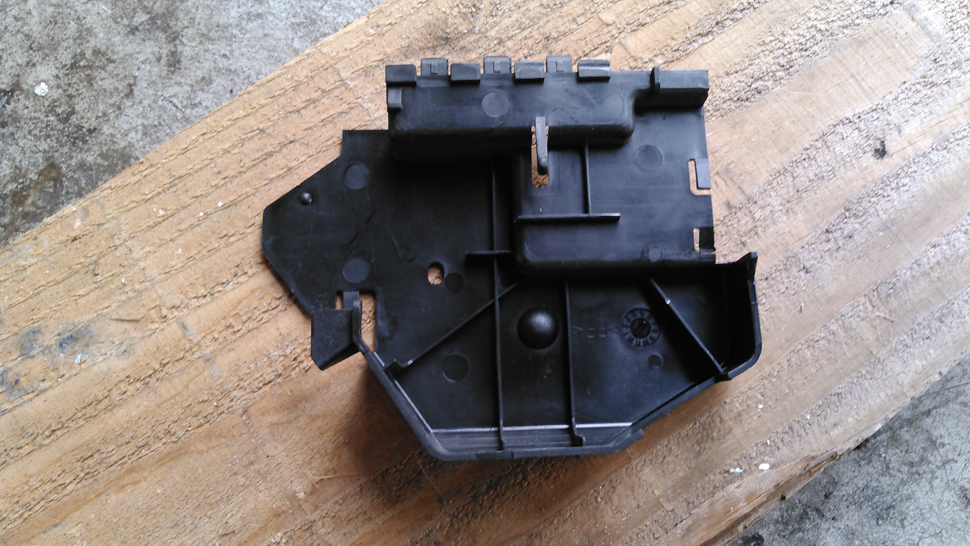

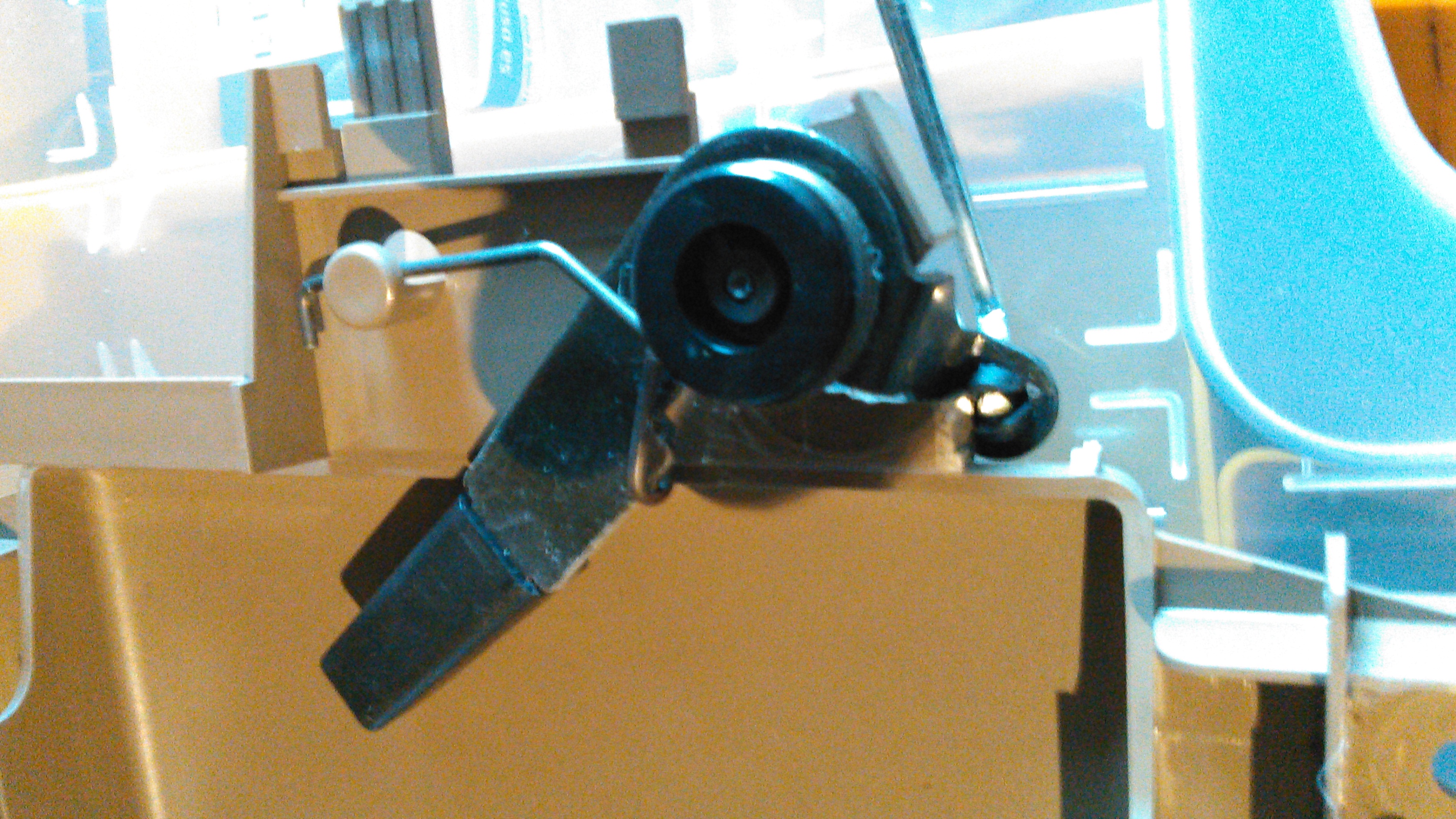

In the next 2 pictures, note the front and back of the cover/bracket removed. The plastic stressed and cracked around the area that secures the release lever (thanks to anfranco60 for his donation from the carcass of his moose for a replacement). Note the short rod on the back of the cover actuated by the latch lever. Its "home" will be shown in the next pictures.

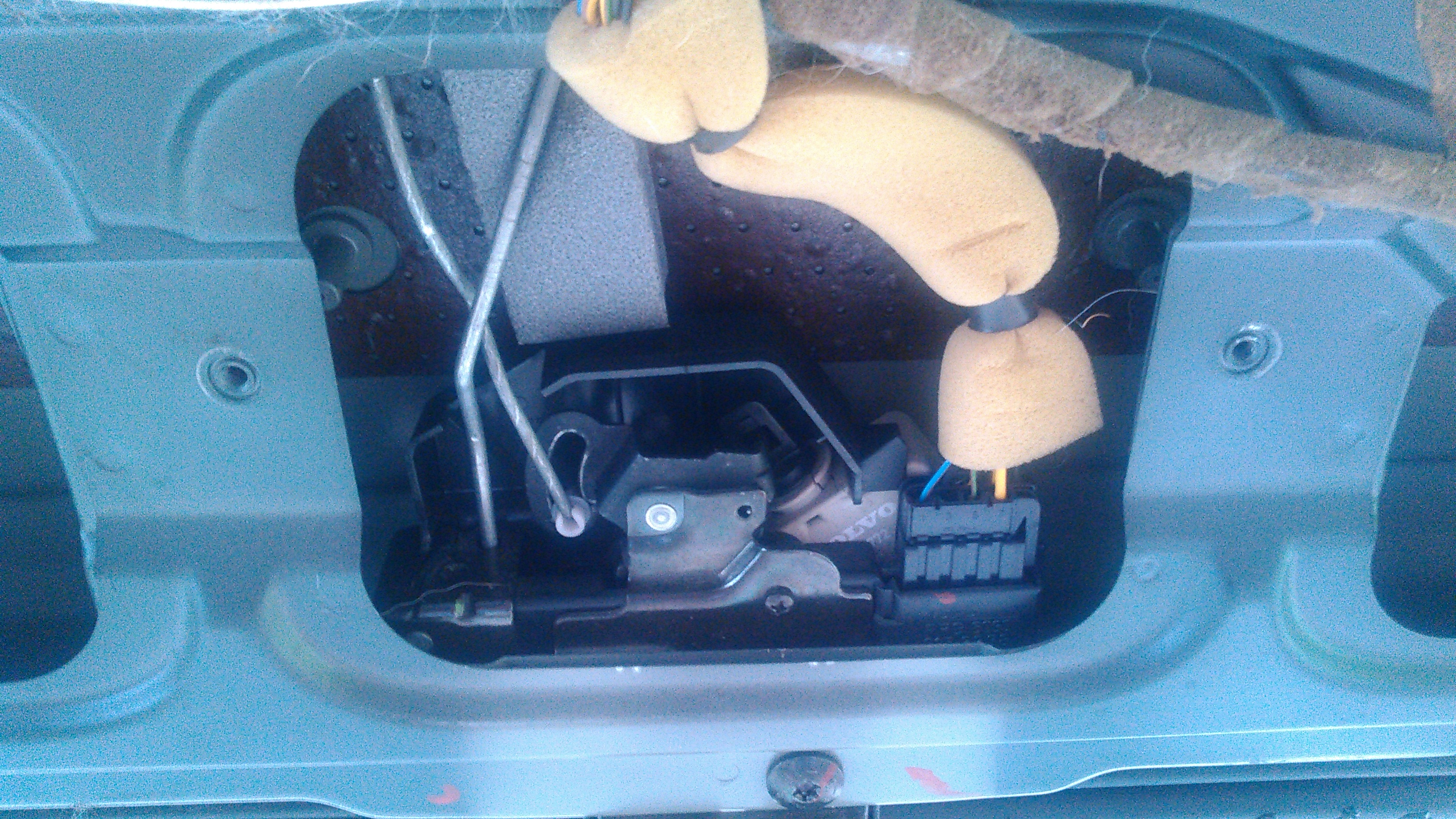

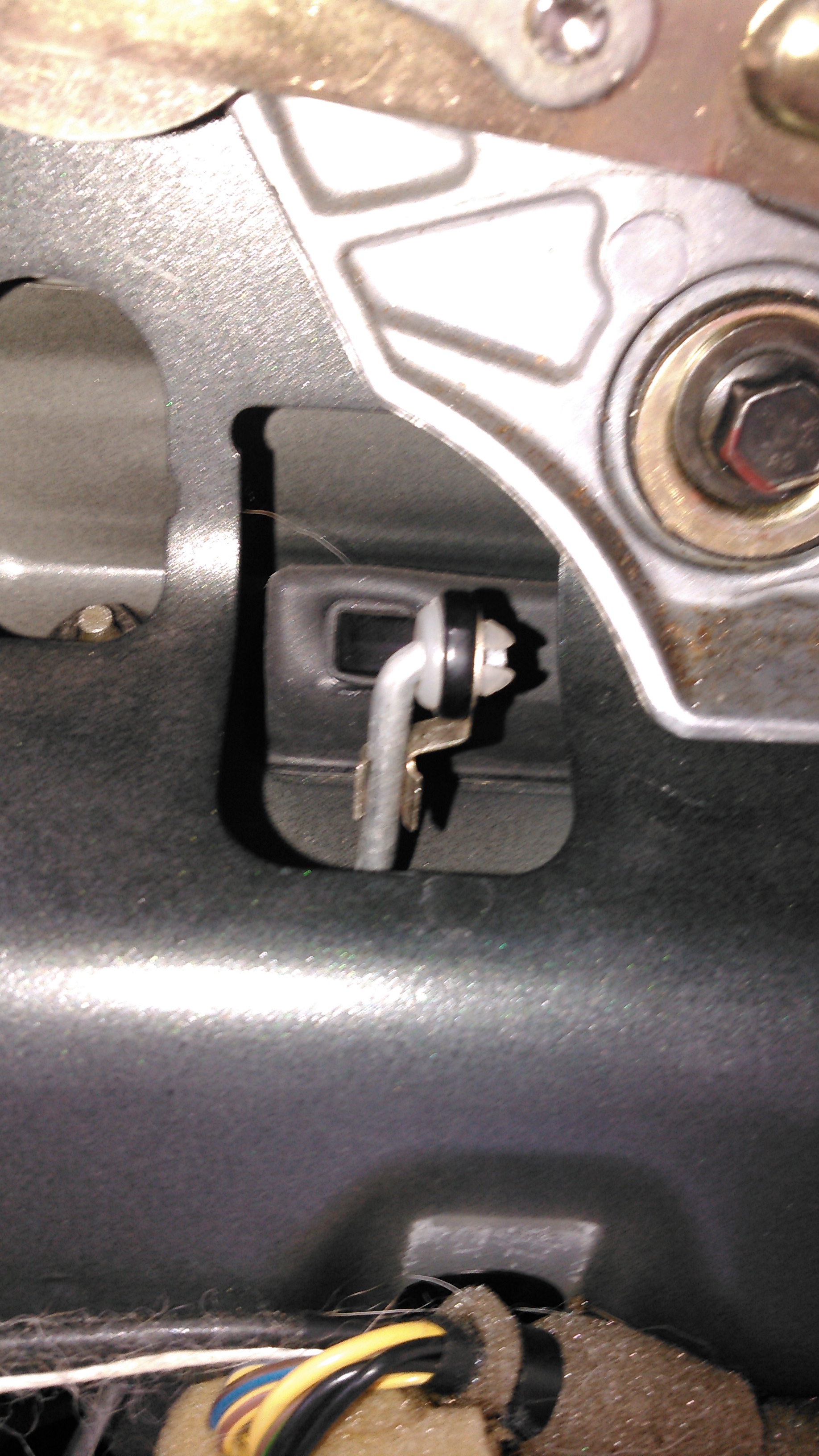

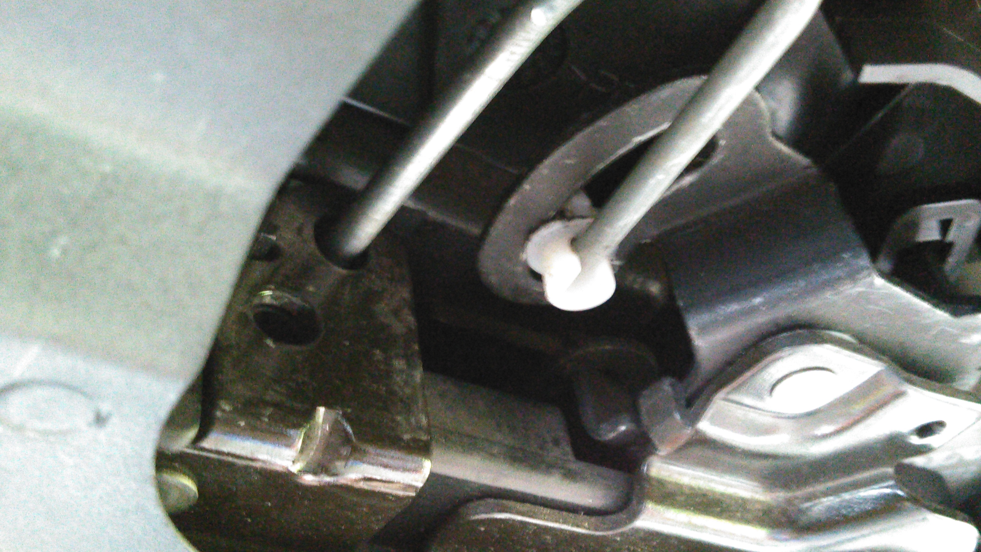

Behind the cover, you'll see the latch assembly with the linkages that operate the release. You'll see 3 holes, 2 occupied by steel rods; the 3rd is empty from removal of the "cover" bracket holding the rod attached to the interior latch release lever in the previous picture.

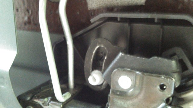

One of the rods may be removed by pulling outward to unseat it from the plastic retainer:
The other may be slid out from the "top" after releasing it from the brass hinged fitting on the opposite end.
Note this picture showing the rods in their correct placement before it was dissembled. When reassembled, correct latch function depends on the rod that ends in the white plastic fitting on the “inside” of the longer rod (the longer being the one with the top secured by the brass fitting).

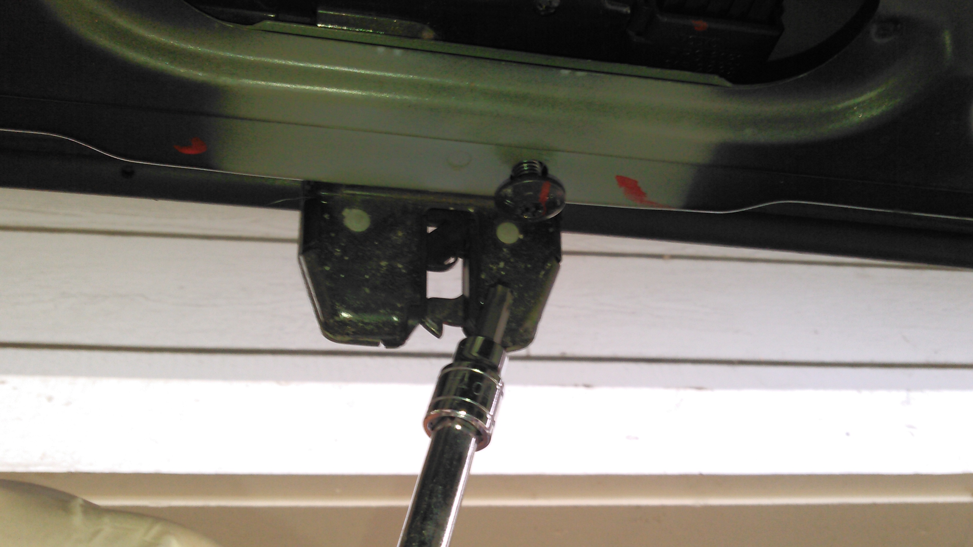

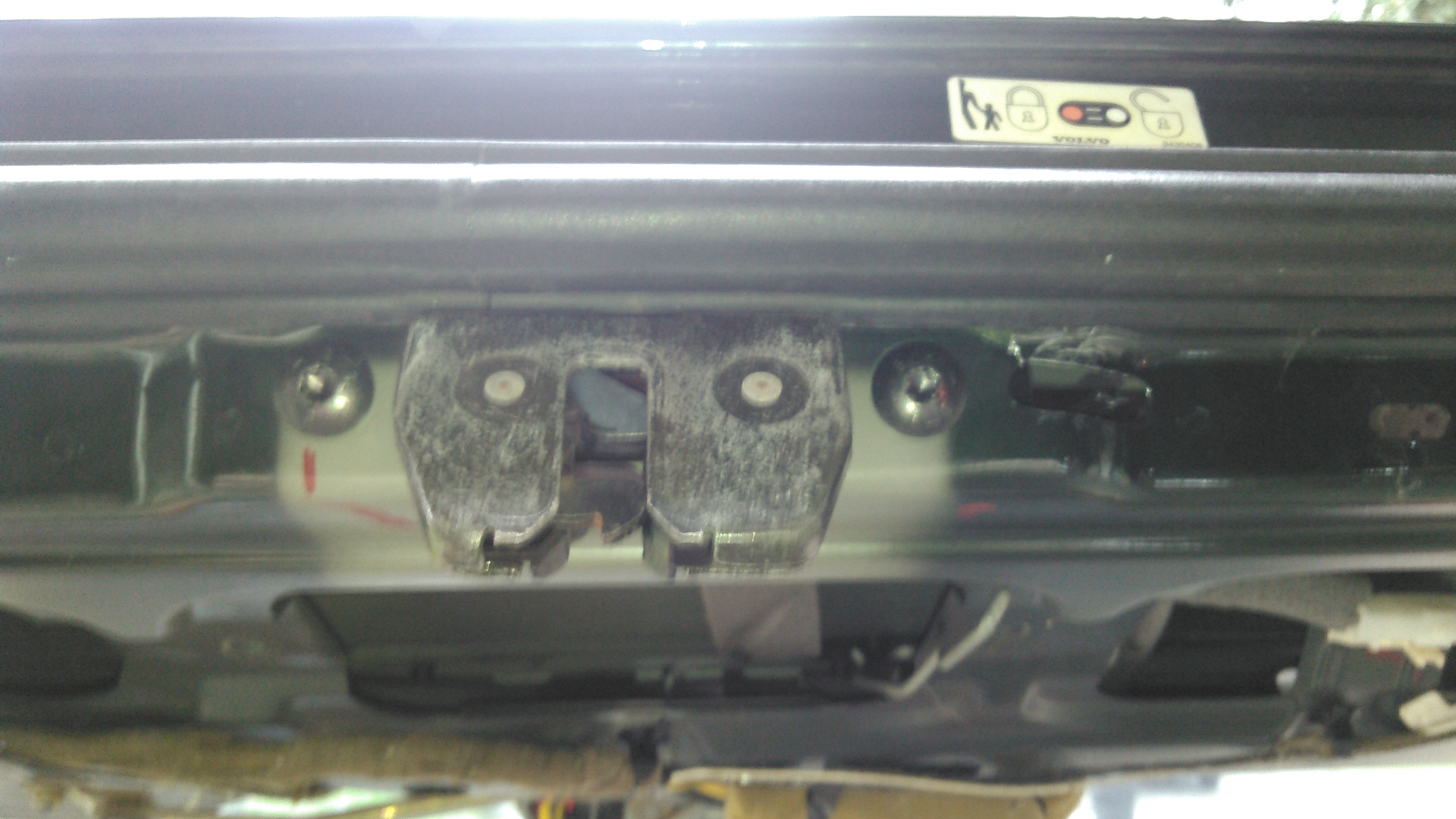

Now the latch assembly itself is ready for removal. It is secured by 3 Torx bolts (T40)

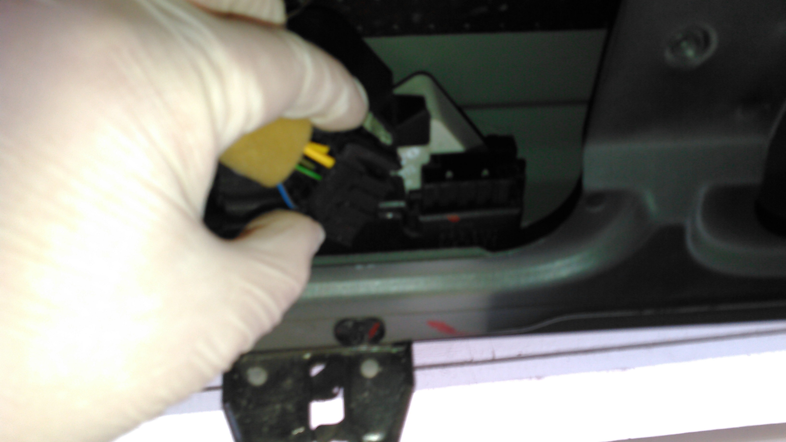

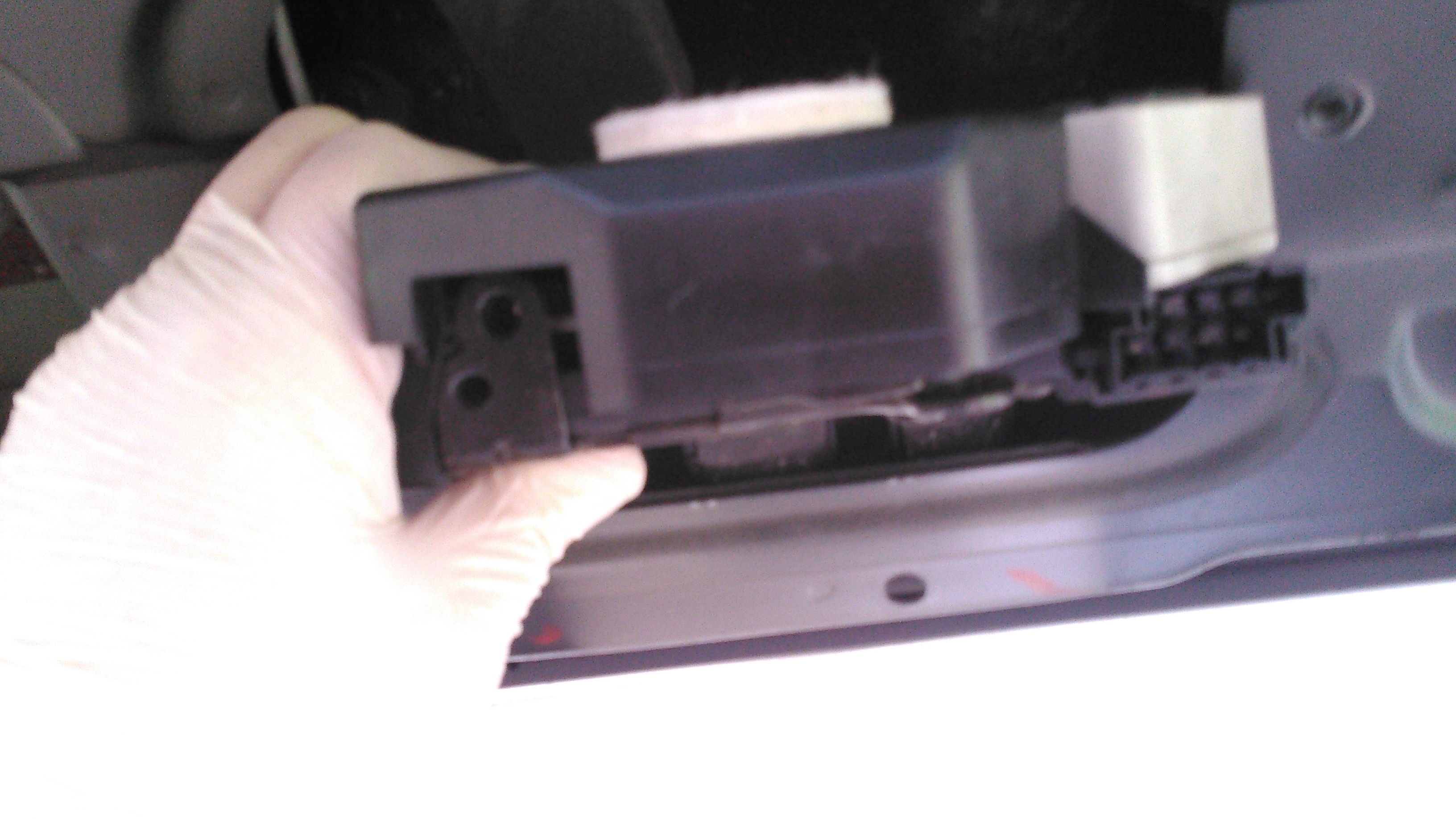

Remove the connector that powers & controls the lock solenoid:
Then slide the mechanism at an angle around & out of the frame:

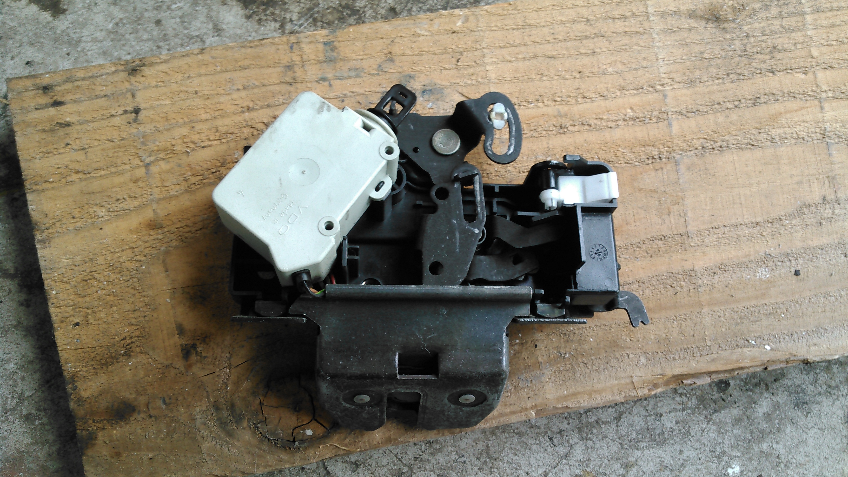

Pics of the loose cover& latch mechanism from a few angles:
Plastic Cover both sides-
Latch assembly “front” & “back”:

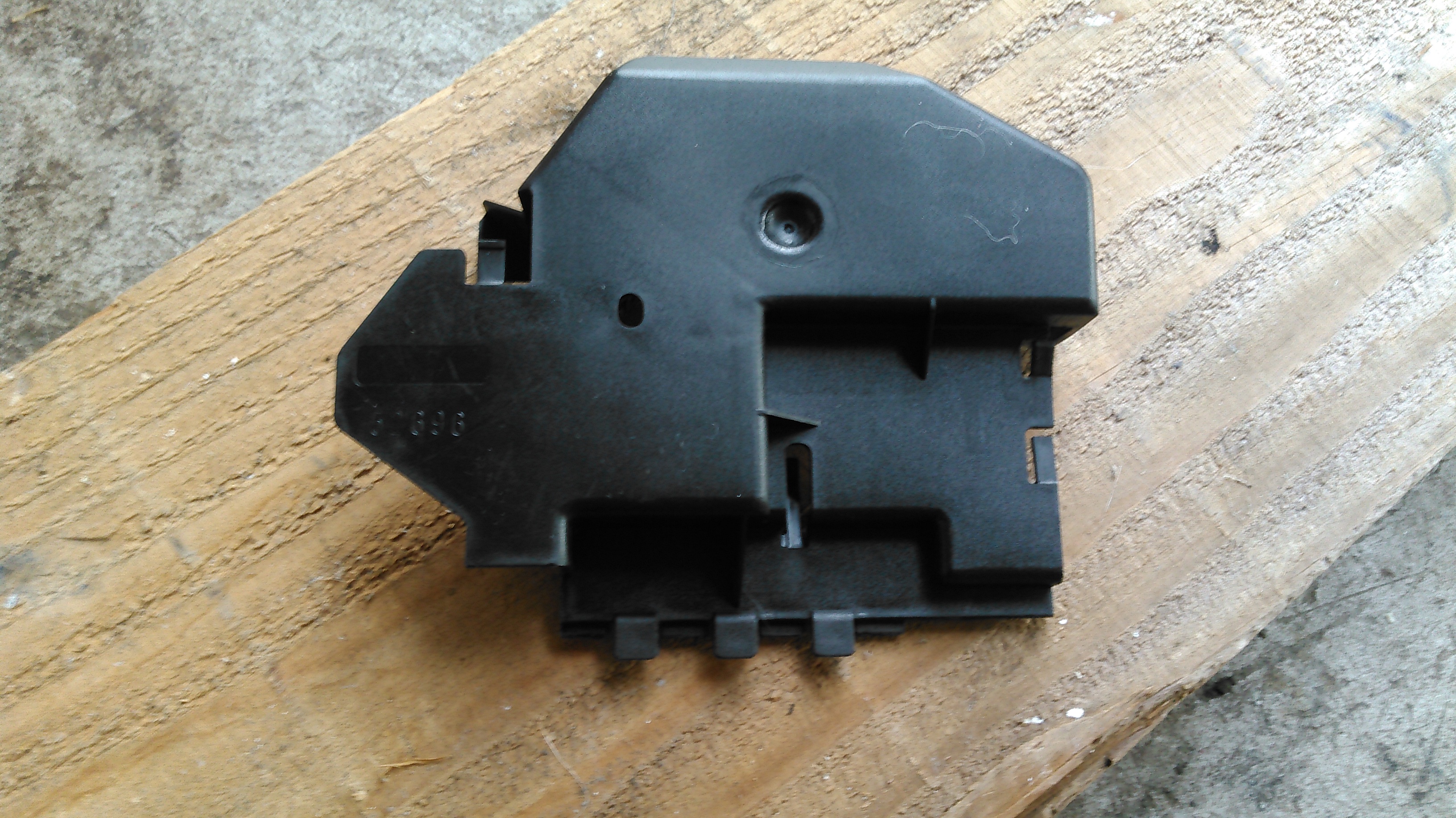

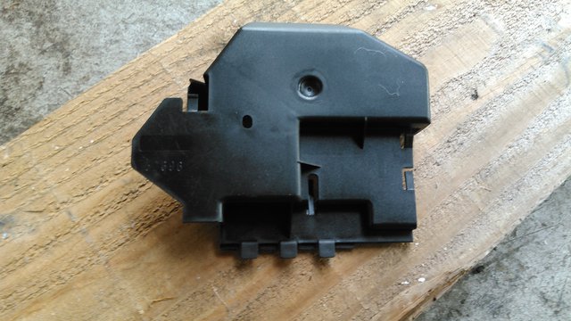

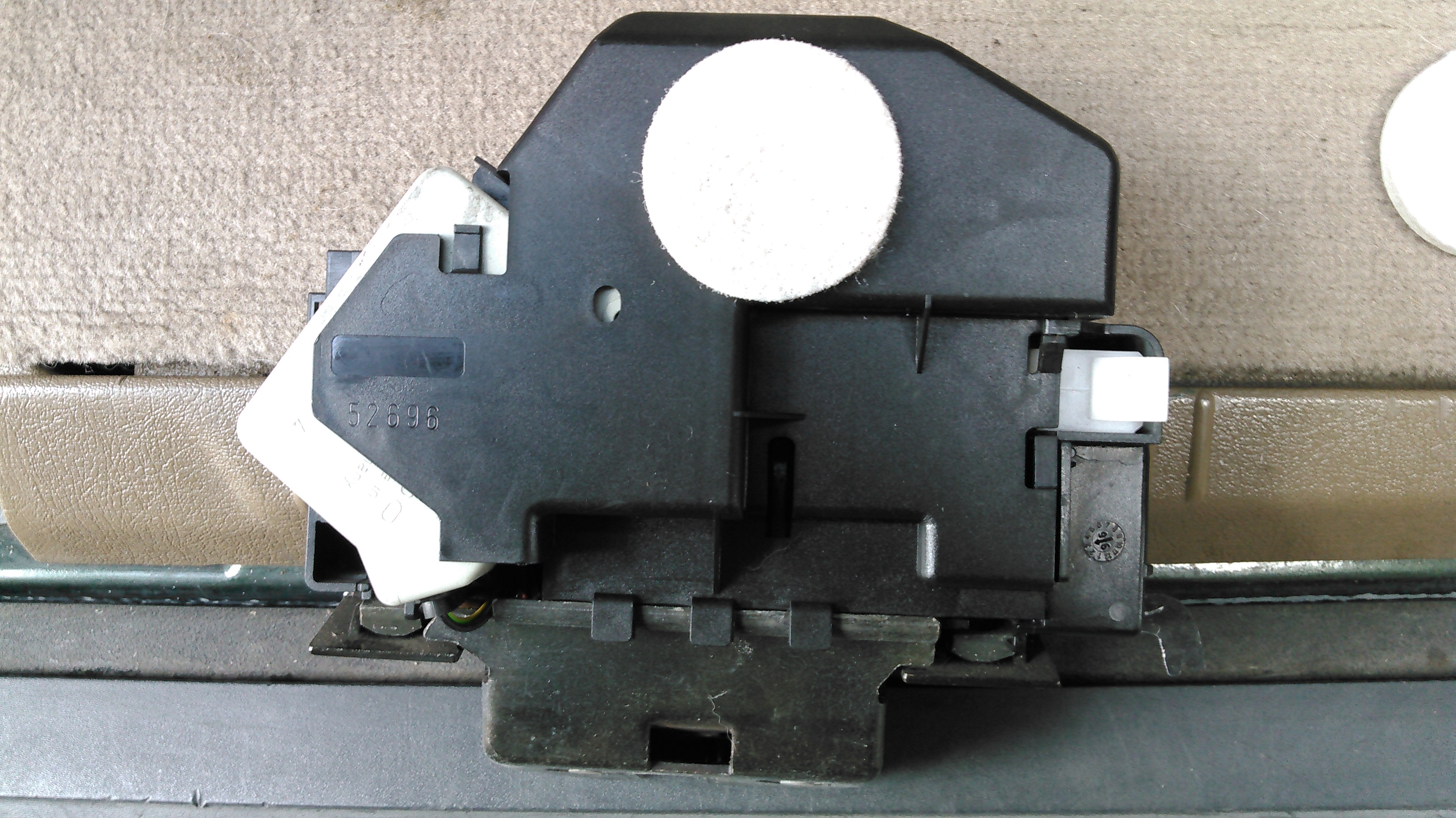

I found the back plastic cover had snapped loose of the mechanism. The plastic cover was rattling against the metal of the frame- sounding much louder than it looked like it should. I snapped the cover back into position; made sure the plastic tabs were secured, and tacked a furniture foot-pad to keep it snug against the frame to try keeping it from migrating as easily.
To reassemble, slide the latch mechanism assembly back into place. Secure with the 3 T40 Torx bolts. Reconnect the solenoid plug. Reconnect the steel rods: Connect the "hook" of the "inside" rod into the plastic retainer. Then slide the longer rod in from the top around the "outside" of the previous rod. It slides into the remaining hole closest to the back of the mechanism. Snap the brass connector at the top of the rod. If you get the rods in the correct holes, but reversed, the latch will still close, but it will bind and the outside handle won't smoothly return to its resting position, and the tailgate key slot will resist turning when trying to lock: Refer to the 7th photo for correct placement. Reattach the cover with the 10MM bolts, making sure the rod attached to the interior release lever is received into the last open hole in the latch assembly. Also note the in the first photo the placement of the plastic tabs against the frame. Follow online directions to re-seat the interior trim panel, snap the handle cover into place, and enjoy one less rattle in the old moose.
